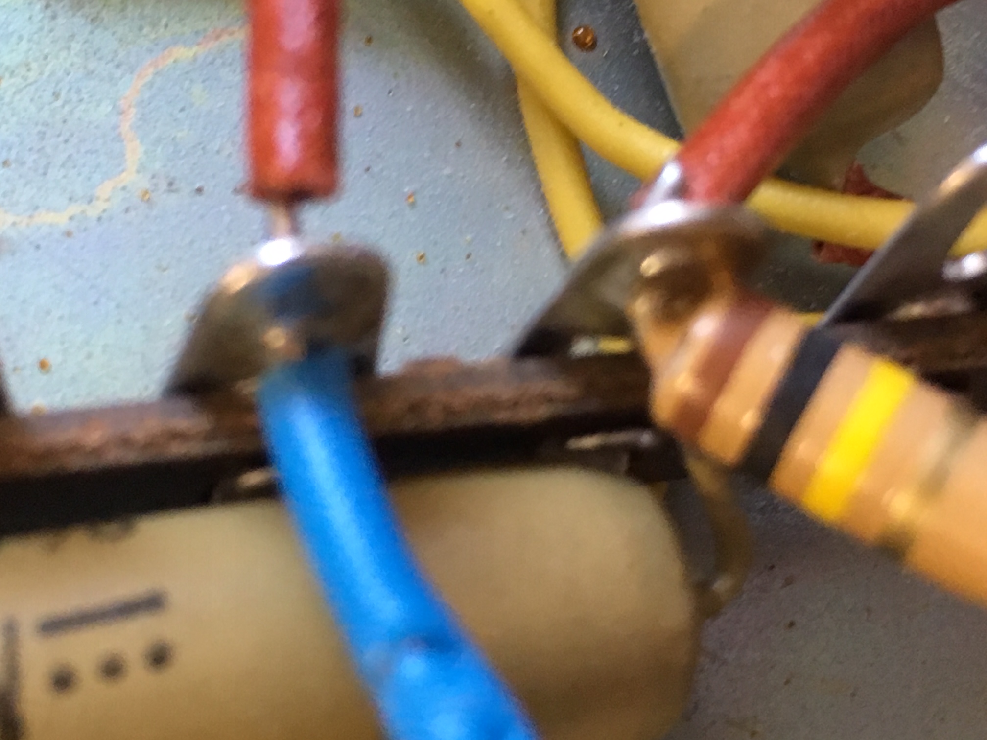

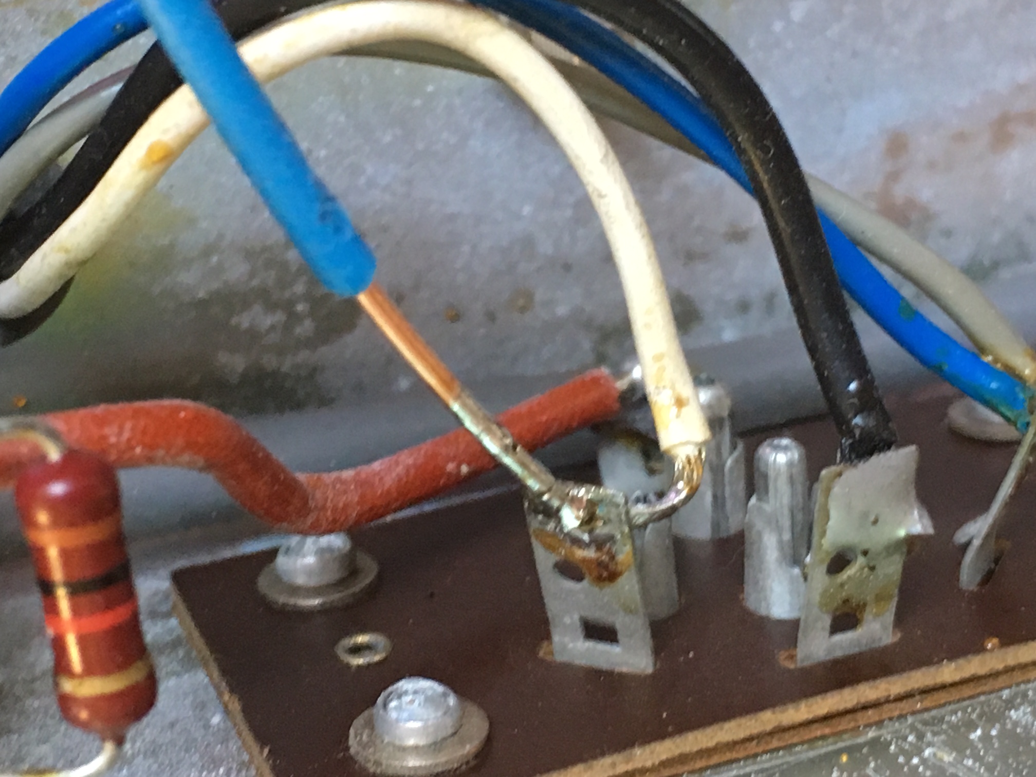

Hi all
sorry it's taken so long for me to report back but thet life thing get's in the way eh?
Well I'm happy to report that after soldering the resistor through earth rail tag and on to the 16ohm tag the noise is GONE!
The only sound I hear now is slight static when the volume is turned way up.
So I want to thank you all for your advice and expertise , especially Galu. Muchos gracias!
(pics of my very amateurish soldering - I may re do it!!)
