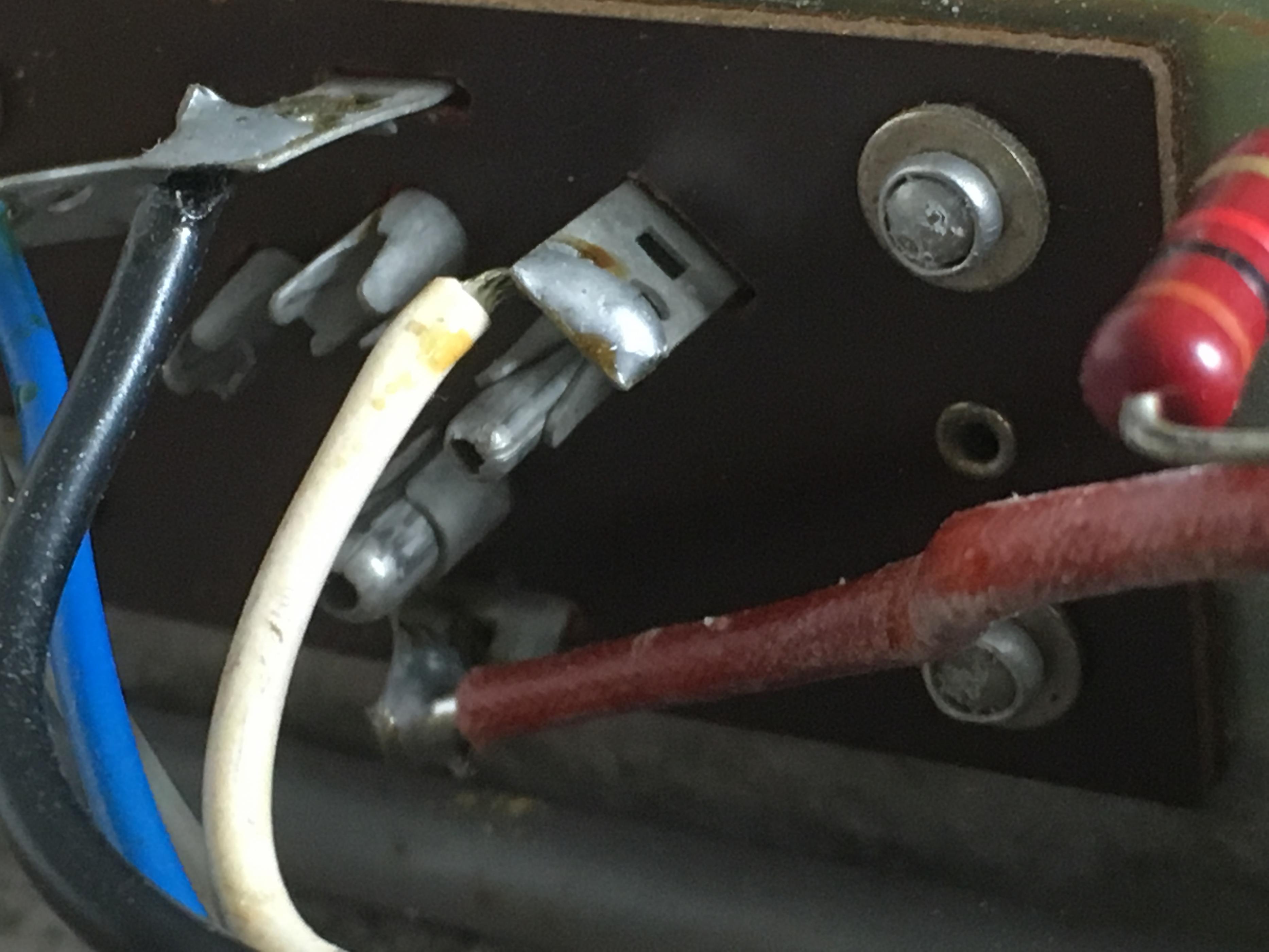

... Looks like the free end of the 56k should go straight across the tag strip then attach to the 16 ohm tap on the output transformer via a missing length of wire.
Yes, that looks consistent with the information available.
Thanks Malcolm!
OK ammers2, we have a second opinion. Can you identify the wire we are talking about on the attached photo?
It runs from the 56K resistor down to the 16 ohm tag on the loudspeaker impedance selector. This wire is missing from your amp and you can try replacing it.
It would appear that the previous owner has removed this feedback loop in order to increase the gain of the amplifier. Just say if my instructions are not clear.
That's the one. Wire not critical - just match up with what's elsewhere in the amp.

Just to make sure I do this right. Should the new wire from resistor be soldered to tag on the rail first and then follow on diagonally to 16ohm tag or can I just send wire straight across to said 16ohm tag?? There is no solder residue/evidence of previous connection on the tag on the rail?
I presume the black wire goes to the 16 ohm tap?
It does appear that a wire has been cut off the top of the tag, but I can't be certain from your photo.
Hi Gali not sure which post of mine you are replying to but in last photo the white cable goes to 16ohm tag. You can see at solder joint where it has been cut. PLease ignore speaker plug it is set in photo to 16 but should be up/ down set to 8
