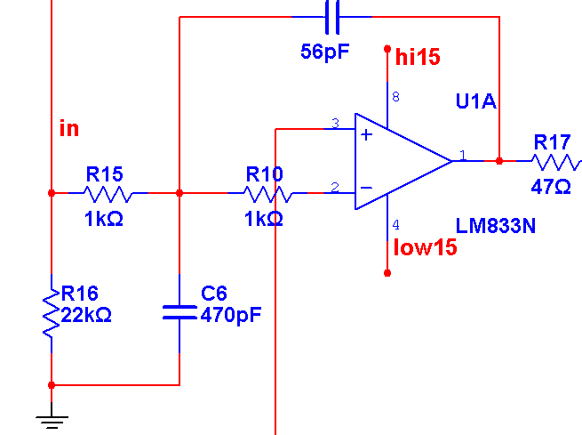

BY the way: At the negative opamp input, do you still have the original setup for the RF input filter, where the capacitor connects directly between the neg opamp input and ground? If so, that could definitely be a problem related to oscillation, and you should replace the original series resistor with two series resistors, each with half the original value, and take the cap to ground from between them (with double the cap value). OR, you could use two original-value resistors and the original cap value.

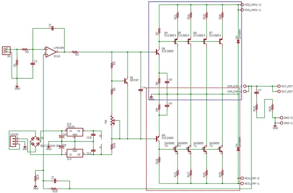

Why are you adopting such a high power capacity for your output Zobel?
Ensure it passes minimal current at your normal maximum operating frequency (select the cap appropriately) and roughly match the resistor to your intended load impedance.
In normal operation the Zobel should be cold. You should not need any more than 1W or 2W.

The wires from capacitors to board should be kept close to each other to minimize inductance and you should try putting something like a 100uF electrolytic and 100nF or so plastic or ceramic cap between each rail and speaker output, in parallell with the capacitors already there, but on the board.
Is ground of the circuit connected to the chassis? If it isn't there could be feedback as the output of the amplifier goes into the transformer which has some capacitance to chassis ground. The connection to chassis should be done with a short wire directly from the board.

While I had the heatsinks off, I separated the input ground, added a cap accross the opamp inputs and reconfigured the input as per Gootee's sugestion...
For clarity, Gootee, is this what you mean? see pic...
Thanks!!
Yup!

Main plane, maybe. The bypass currents return to where? I think I would also solder a 0.1uF or so cap directly from one opamp power pin to the other opamp power pin (on other side of board), since the two opamp power supply bypass caps aren't grounded near the same spot.
VERY IMPORTANT: Don't forget to put a 10 uF or so aluminum electrolytic from each opamp power supply pin to main ground, too! (i.e. in parallel with the 0.1uF caps)
My simulation showed that the 10 uF caps, there, eliminated the HF portion of the ringing at the opamp output, and fixing the input filter eliminated the large transients that preceded the HF ringing.
Edit:
Just now, I found that doubling C2 (opamp feedback cap) and halving C3 (main amp feedback cap) almost-totally removed the last glitches that were showing up at the opamp output (after fixing input filter and also adding 10uF || 0.1uF from each opamp power supply pin to ground). Actually, I tried C2=100pF and C3=22pF (I had both at 56pF, before.). But "your mileage may vary.". [Note, too, that I am not modeling your regulators. Also note that I am using a model for an LT1115 audio opamp. I should probably change that to whatever you are using. Edit: OK, I quickly tried it with LT1122 and it still looks the same, at least.]
Actually, with the LT1122 (14 MHz Gain Bandwidth Product, max slew rate 60V/us, and JFET inputs), the input filter fix has a much larger good effect (eliminating ringing at opamp output) than adding the 10 uF bypass caps does. The LT1115 that I WAS using had a GBP of 40 MHz but a max slew rate of 10V/us, and, I assume, BJT inputs. Interesting.
At any rate, I think that you might still want or need to increase C2's value and/or decrease C3's value. The actual values will probably depend on your opamp, and lots of other factors. With the LT1122 instead of the LT1115, I had to futher-increase the value of C2, to eliminate some remaining HF ringing at the opamp output. If you don't mind a little distortion, and maybe just slightly less output amplitude, it might be safest to use something like 220pF and 22pF, or 330pF and 33pF, for C2 and C3. But, again, you'll probably need to experiment with them.
Of course, still add the 10uF (or even more) caps from opamp power pins to gnd, especially with those regulators in there. (It might actually be even better to solder the 10uF-to-47uF caps directly to the regulator's output pins, and then to gnd, instead of putting them over on the opamp's power pins.)
You could also try something like a 4558 if you're still having problems. The opamp only needs to slew at about 2V/uS to drive the output stage. Faster opamps can be very touchy.

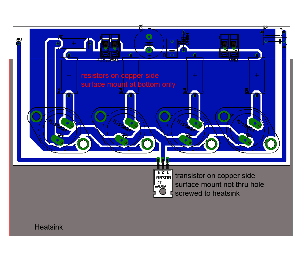

Here is the hi side layout...

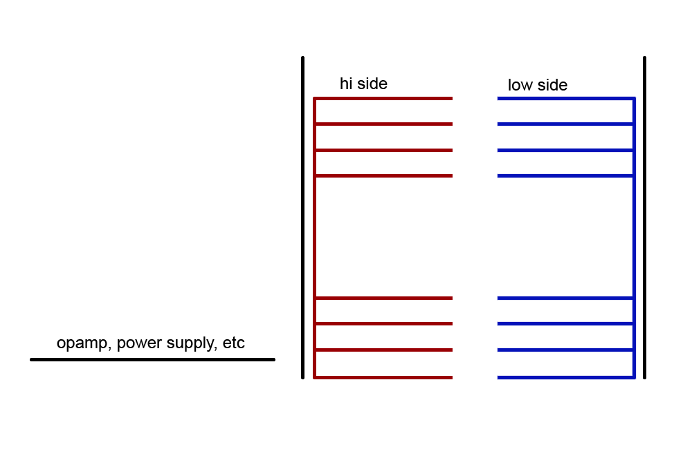

I like this layout more than the current one, as it's alot of trouble to modify the circuit... I have to unbolt the heatsinks and pull off the driving transistors every time I want to get at the copper side...
The low side would be a mirror ....
Any forseeable problems with this?
Thanks!!
Thanks!!
