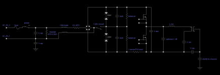

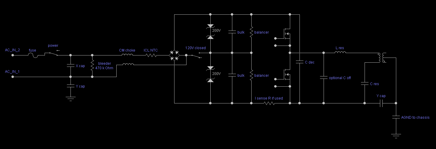

This is as much as the primary power stage can be simplified without safety issues or malfunction.
There are a few equivalent variants ("isomers") obtainable by exchanging parts that are in series, or by moving one part from one mains wire to another (as long as there are no EMI issues by doing so, another standard rule: "the square wave goes first to the inductor").
Recommended distance between mains leads before/at CM filter and across fuse: >=4mm.
Recommended distance between HV/switching/GND nodes at/after diode bridge: >=1mm.
Distance between nodes of primary and secondary sides (including mounting holes): >=6mm.

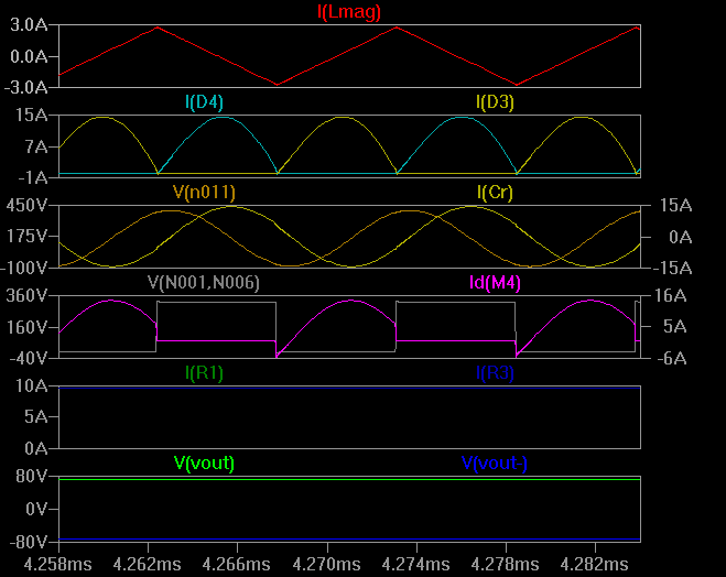

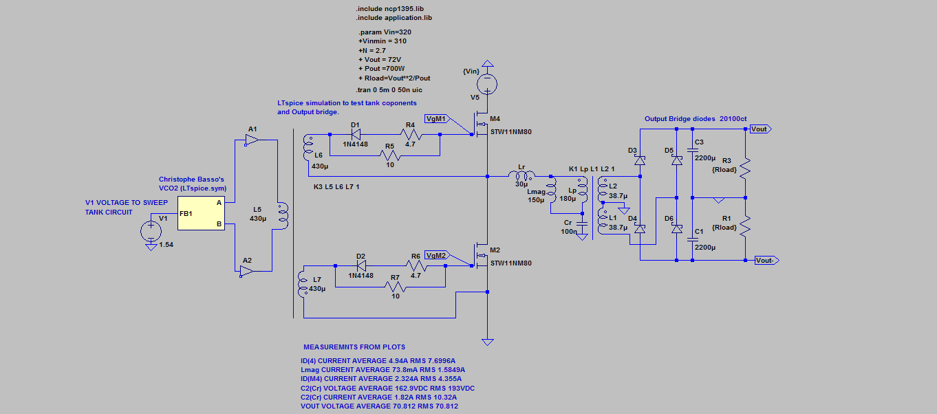

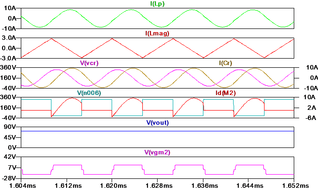

IRS27951 is discontinued, therefore I will be using onsemi NCP1397ADR2G, newer with more features
Newer IC looking good. There are only 2 alternatives to embracing the universal nature of knowledge and solutions: loneliness and fighting trolls.
I am checking with Christophe Basso now to see if the LTspice models are valid for this controller.
Would be nice to provide a LTSpice Model for the NCP1396 as well, the one I use for years.😎
Check FAN7688 and associated app. note AN6104. However "scientific poking"/"carbon copy" method does not work neither in audio world nor in PSU one.
Try to replicate reference design to begin with.
Simulations usually create false impression of simplicity.
