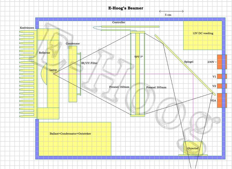

I am thinking of the lenses.... just wonder how does it work...
You have unsplited fresnels, 310 + 210mm, the combined FL is 125.2mm. you projection lens has a fl of 240mm.... how does it work out? The condenser lens play a big role here? Can someone please explain it to me? thanks!

this will answer your question (use the legend and verify distances) easy stuff. Hint, you dont combine the two.
http://www.student.tue.nl/P/t.huiskamp/beamer/schema.jpg

Sorry, can you make it clear? the picture doesn't indicate the FL of objective lens, and it doesn't indicater the distances either...

The distances coulldn't be any clearer (if your using winxp make sure to view the pic actual size and not screen size) as far as the objective lens on this particular lens it doesn't matter a whole lot since it's a variable lens 285-330mm FL. Its FL setting is probably 285~295mm to work nicely depending on distance to wall. Keep looking at it you will learn alot if not everything from it.
P.S. don't let the mirror throw you off! and try to imagine the light path (you want to get as much light through your objective thats the key to getting a brighter image.

I remember that someone here said the objective lens must focus on the lcd in order to get a focused image. Based on my experiment, the throw in distance is playing a role too. If I change the throw in distance, I also need to move the objective lens close/far from LCD.... it seems that statement is false... I am confused....

Read it again I did mention the "depending on distance to wall".
