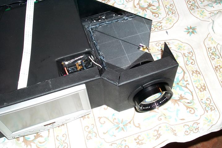

Congratulations, the proj looks great !!!
I´ve only managed to get the ribbon for the frontal panel in my city. I cant get the ribbon for the controler board, but it is not really necesary (using the Lilliput in that position).
I´d got the ribbon from an Electronic components store. It is common 1mm step flat cable. I get mine with an extra track that I´ve cutted on one side.
Bernardo.
Sorry for this late reply.

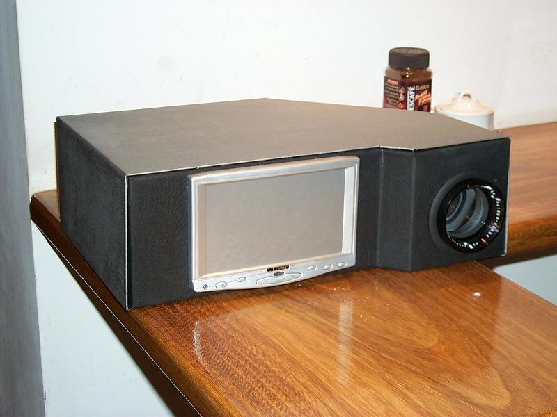

My Projector "Reloaded"

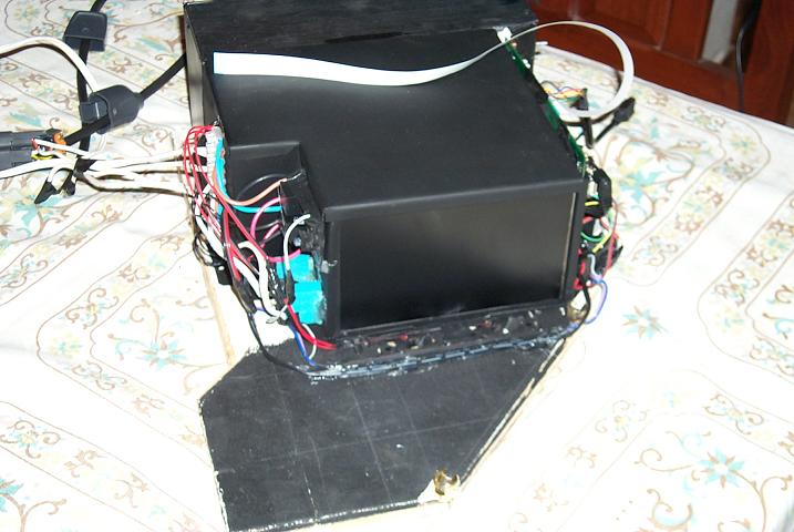

Hi Guys, I've completely rebuilt my projector using the same design than before but improving air cooling and overall size (smaller than before!)
I've added some electronic as Ace did, that automate all the functions (Starting and shutting down the bulb and coolers automatically when the Lilliput goes on and letting the cooller work for 2 minutes once shutted off for extra cooling)
All the proj now is operated with the Lilliput remote control, so my wife is really happy now !

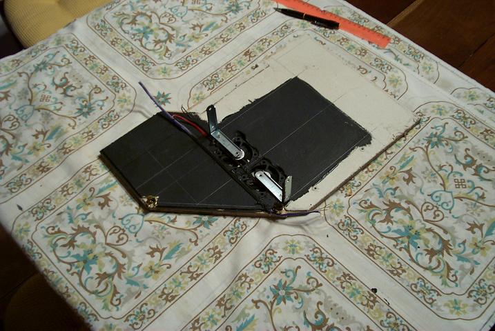

I've improved air cooling inverting one of the fans that takes air from the panel box into the Light box using a second fan for extracting air from the light box to the back off the projector.
Some pics:
Same process as the previous model but smaller: Here is the MDF 9mm base...
