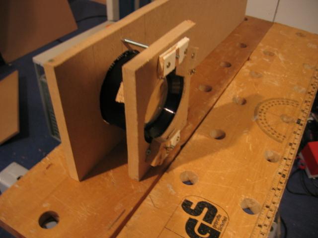

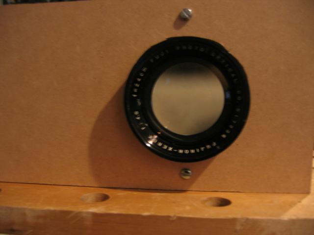

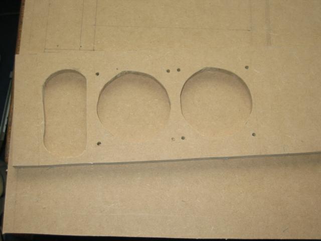

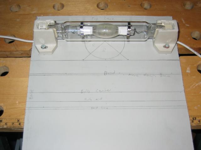

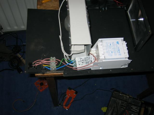

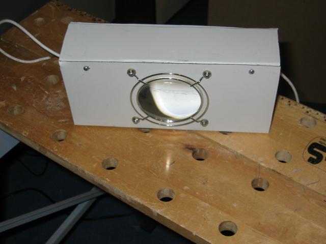

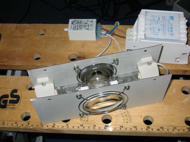

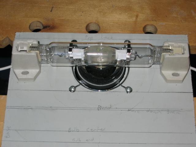

After almost killing my self with the jig saw as it was on max speed i managed to cut a hole for the reflector.
In this picture nothing is actually mounted down so it may look off.
I will mount it down when i have bent the metal
Should be another update tomorow after I get my 92mm fan guard to hold the condenser in place. (They didnt sell 80mm from the place i ordered from well they did it was just stupid money)

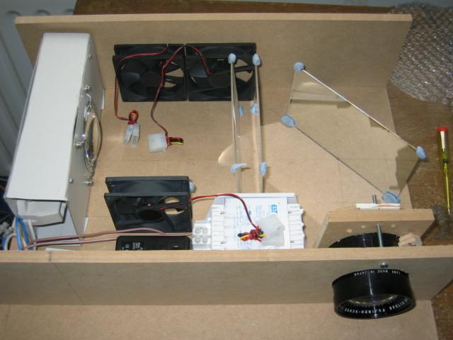

The projector will have 3x 92mm fans and possibly some 80mm
ANd i got it all second hand off someone on these forums
I think i might be ok with cooling i have a plan
I had cooling problems with my 250watt using the same optics u have nick, i had a 100cfm blower fan on my lightbox tempered glass before lcd and an 80mm directly vented to the lcd and after 40 minutes the lcd was too hot. Have switched to two 120mm fans on the light box, reflecting light off mirror onto lcd this time and having the blower fan directly onto lcd, hopefully that will sort out the cooling problems lol...again good luck with yours mate 🙂
