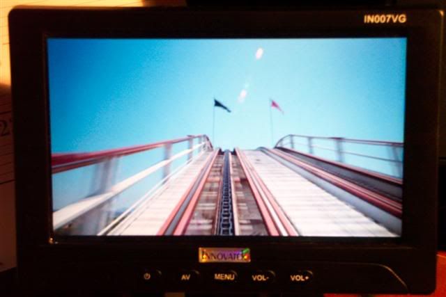

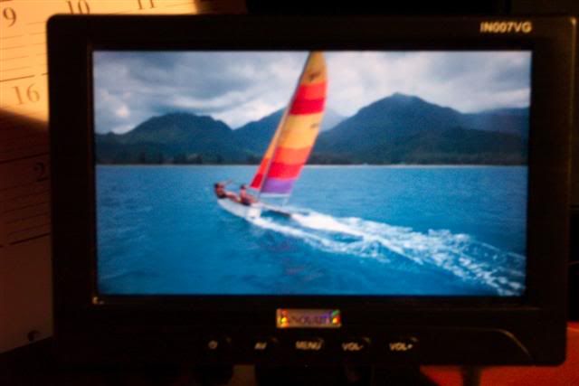

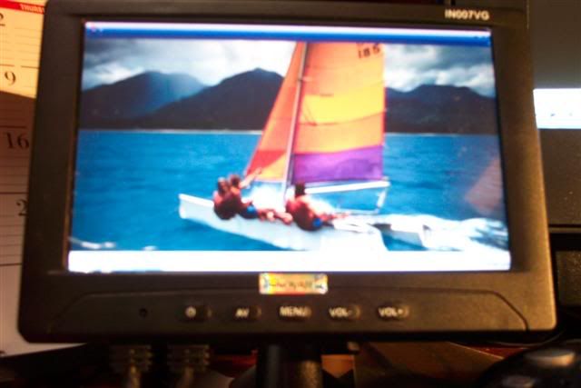

So I thought I would start a thread on my journey to projection bliss. All I have right now is the Innovatek 7" LCD. I must say it has a very nice picture. Here are some photos....
I can assure you that actual image is much much sharper.

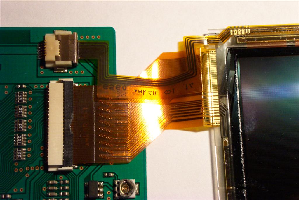

I tried to strip the LCD today. I got it all apart, plugged it in and it worked. So I decided I would set up a small test bed. When I went to plug it in again, I got nothing. So I put everything back together and turned it on and all I got was a white blank screen.
I am so pissed off at myself. Please tell me there is something I can do/check.

Ok after doing some more testing, it looks like it may be ESD. I used the multimeter to see if there was any current flowing from the white FCC, which there was. I then used the multimeter to see if there was any current on the other side(where the brown FCC connects). There was none.
Does this seem logical that since there is no current on the side where the brown FCC connects that controller card is what is broken? Is it possible to buy just the small controller card?
The little board needs to be at a 90 or 180o angle like it is when its inside its housing or no connection is made 🙂 now be careful and dont fiddle with it to much or u will snap a wire i sugest you make a frame for it and leave it in it

Thanks for your reply nick.
I have tried putting it all back together with back light and everything behind it and screwed the small card in. Still no success 🙁
Any other suggestions?
Yeah, I have tried the FCC cable every way it could go. I have taken it apart and put it back together at least 5 times and checked every connnection.

Hmm, its possible you have broke a connection, if you have broke a connection on the brown fcc cables then your ****** basicly will cost you about $75-$100 US for a new lcd panel if you can get hold of one (took me about a month to find one)
When i first got my panel i got a white screen because the 4pin fcc cables wasent in enouth
