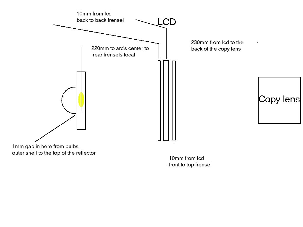

Im using a spherical reflector,condensor, and fresnels from ace.
Exact specs are:
32.6mm focal spherical reflector
80mm diam, 89mm focal condenser
210 bottom focal x 310 top focal fresnel
Lexan XL10 UV protection
Now the dist. between my first fresnel and LCD is about 15mm. The dist. between the LCD and the last fresnel is about 10mm. Do that affect the brightness of the picture?

could you possibly take a picture of your setup. then maybe we may be able to see something wrong
any luck with those photos mate???have you tryed switching the fresnels around or are you sure there in the rite place??

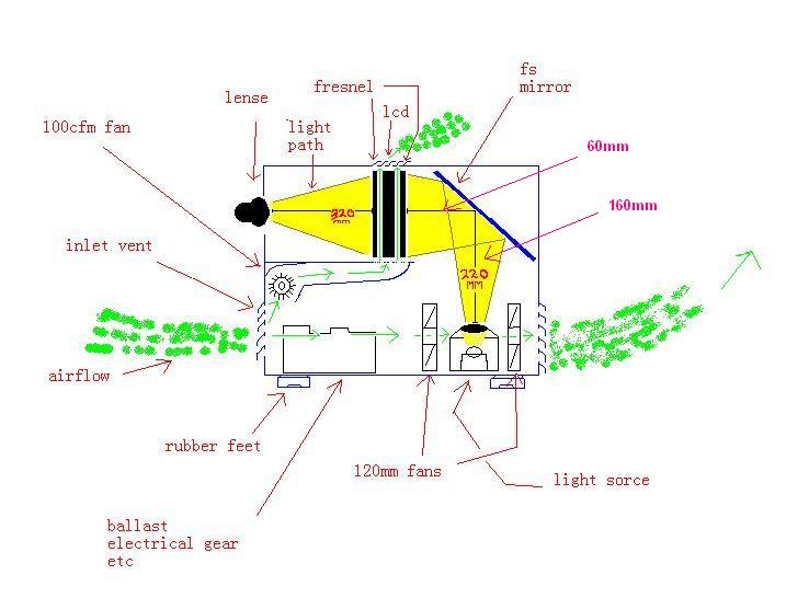

well im glad you got it going congrats on that,cant wait to get to this stage,as far as i know with the meausre ments this is what im doing and id say id be quite close to your set up also::
1 light source to mirror=160mm
2 mirror to rear fresnel = 60mm
1+2= 220 mm fl this is the measurement off the first fresnel
next im not sure off as you have already done it and im not quite
up to that stage of fitting fresnels etc
so rear fresnel to lcd = 15mm?????????
lcd to front fresnel = 10mm??????????
then front fresnel to optics = 310mm or the fl of that front fresnel
you probably have no idea what im on about but this is how im doing my set up pretty much by the books ,maybe some else could offer a better explaination?????
well heres a scribble that might make thigs clearer.....
When I asked ace about the distances he sent me this picture....So thats what I pretty much designed it around.
The reason I moved the the LCD closer to the copy lense was so it could be focuses with a larger image. Ill try moving the LCD back to 10mm. Picture will be up soon as well

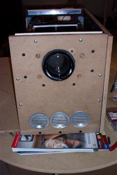

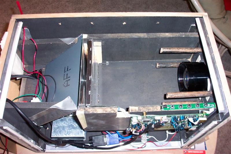

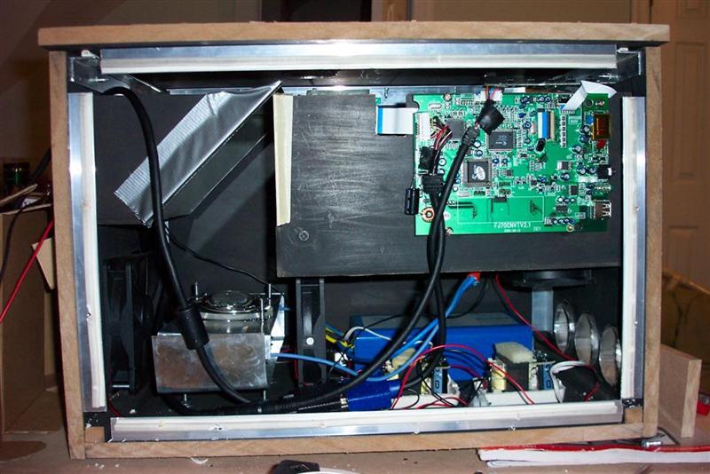

Alright here are the pics.
Please excuse the duct tape and messyness. Its still in the adjustment stages, so I dont want to glue anything down yet.

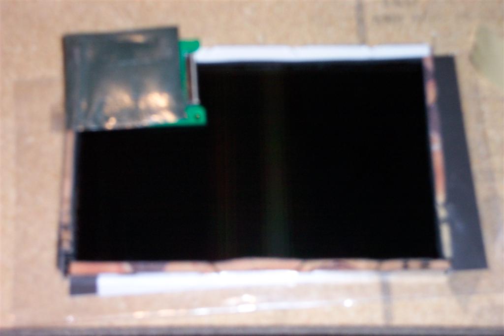

If you move the condensor farther away from the bulb does it collect more light? I have also been thinking about putting some aluminum foil or some mirrors on the inside of the light box pointing towards the condensor. Anyone ever tried it?
This pic is of the LCD. I used strips of mouse pad to hold it in. Sorry its not very clear!

What about the condenser?
Hey Skiguy,
Looking good so far. In that picture you posted from Trev with the distances, it didn't have the condenser in it. Didn't he send you one? Where did you put it? Are both the fresnels 220mm?

Oh yeah, trev said that the condenser goes about 15mm away from the bulb.
The fresnels are 210 bottom focal x 310 top focal.

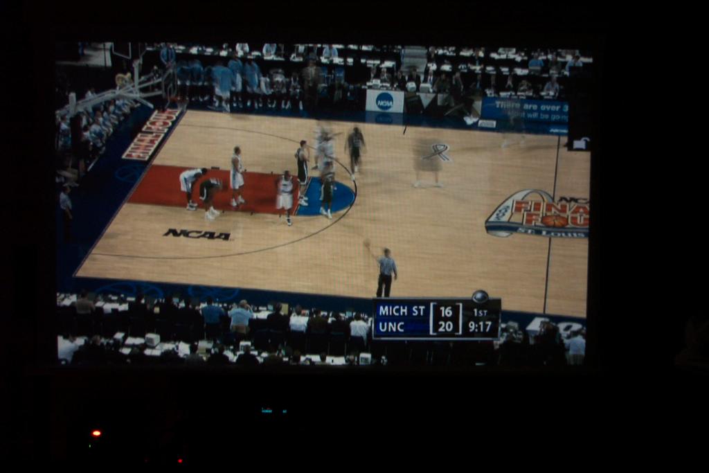

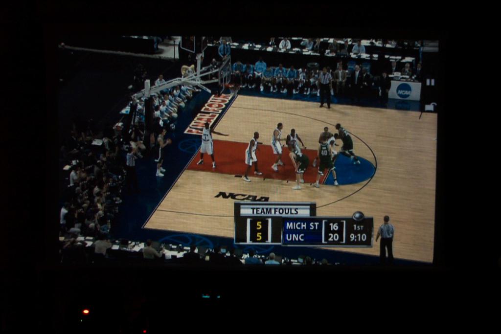

Sorry guys! School and Lacrosse has kept me busy.
Here are some pictures from the UNC vs Mich. final four basketball game. (I hate UNC (Go NCSU!), but they are in the ACC, so I gotta go for'em)
Actual image is brighter than the picture, but not by much. See why I am kind of disappointed?
Heya Chris, what lcd is in that Innovatek? Is it a hitachi?
Also have you fooled with the brightness/contrast settings ect?............ not that you should have to.
Trev🙂
Trev🙂
Yup, its an Hitachi...I think its the exact same one thats in the Lilliput.
I believe the brightness and contrast only effects it when its a RCA connection, not when the source is VGA. I messed around with the brightness/contrast on the computer, which helps some, but again not as bright as I would like it to be.
I'll probably do some more experimenting when I find some time.
