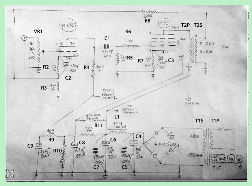

In the end this is the almost definitive schematics that I am redoing ... the only doubt that remains concerns the NFB ring ... do you have any advice to give me, whether to leave it as it is, whether to increase the R8, or whether to eliminate it all?
Looks OK. 6SL7 Gain is ~ 40, 6Y6 Gain is ~ 21.3, OPT is 0.0516. So Open Loop Gain is ~44. NFB will set the amp gain to 7.8, so NFB is ~15 db, a good, conservative number. If you or a friend have a scope & square wave generator your amp could be checked for overshoot on the signal edges. The simplest fix is a small cap across R4. Size depends on the frequency response of the OPT.
Add a 1K, 1/2W Carbon Composition resistor into the lead from the VC to the 6SL7 grid. And a 100R, 1/2W CC resistor in lead to the 6Y6 G2, as close as possible to the tube socket.
The sound will depend most on your speaker & listening environment provided the amp is running properly.🙂
