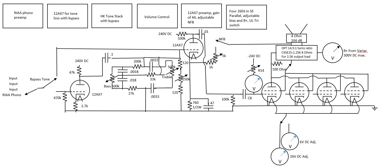

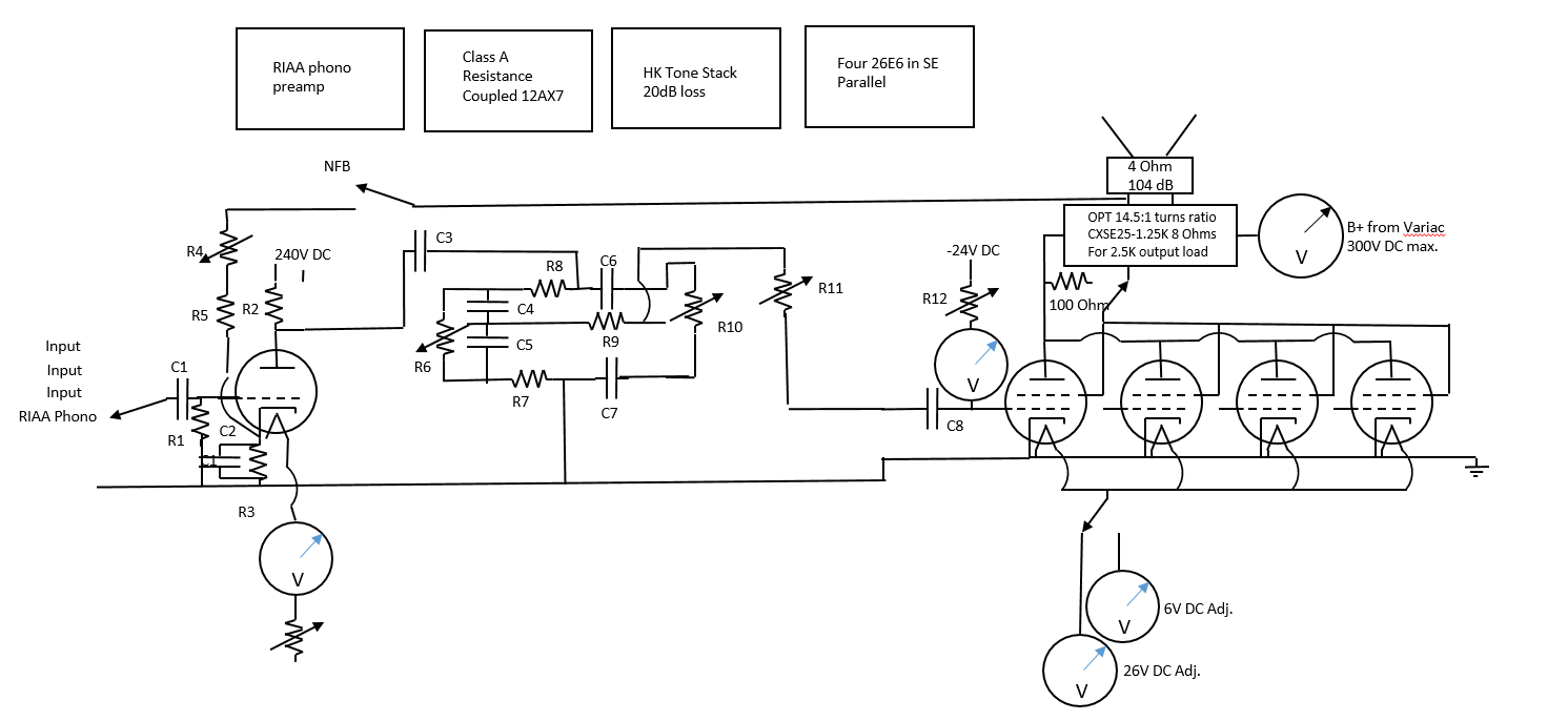

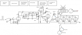

I tried loading an attachment rather than using the "insert image" path which requires a URL.
This circuit is simplified. The tone is from Harmon Kardon. Insertion loss is 20dB so even a single 12AX7 should with a gain in the mid-30s should be adequate?

Taking NFB around a tone control ideally makes the tone control no-effect.
There's well-trod paths that just work. Don't try to hack your way through the jungle, swinging wildly. Plagiarize. Study all the circuits you can find.
Max Robinson's modified version has a loss of just 6 dB
How about Max Robinson's "A tone control you can love" (Fig 14)
Practical Tone Controls.
This could be followed by the volume control, and then the amp?

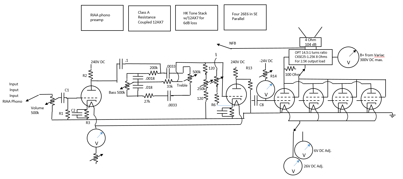

If you really want to use tone controls with NFB, then you can add a recovery, buffer stage between the tone control and the power tubes. The NFB can be returned to said stage, look at some old schematics, there are many examples.
the resistor values were far from those in the 12AX7 data sheet, but I guess he was targeting lower gain than any of the datasheet examples.
His other examples utilized a B+ of 250V and I had planned to use 250V, so I had hoped to duplicate component values, but without correlation to a another 250V example with components in the same region I feared that my assumption could become a problem.

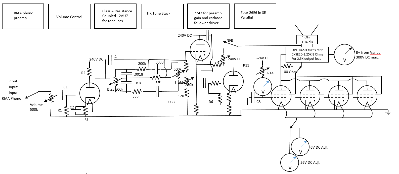

I just figured out the 7247 tubes I inherited from my Father-in-law.
They seem perfect to insert between the tone stack and the output tubes, the 12AX7 half for gain, and the 12AU7 half for cathode-follower driver.
Did I get it right? If so I will finish the circuit...

I would make the Volume pot smaller, say 100k, also get rid of C1 unless you really need it. You are also missing the plate resistor on the recovery stage, and having an extra coupling capacitor to the CF. If the HF response and the drive voltage is good enough from the recovery stage, then you can skip the CF - you can test it out pretty quicky on the breadboard.

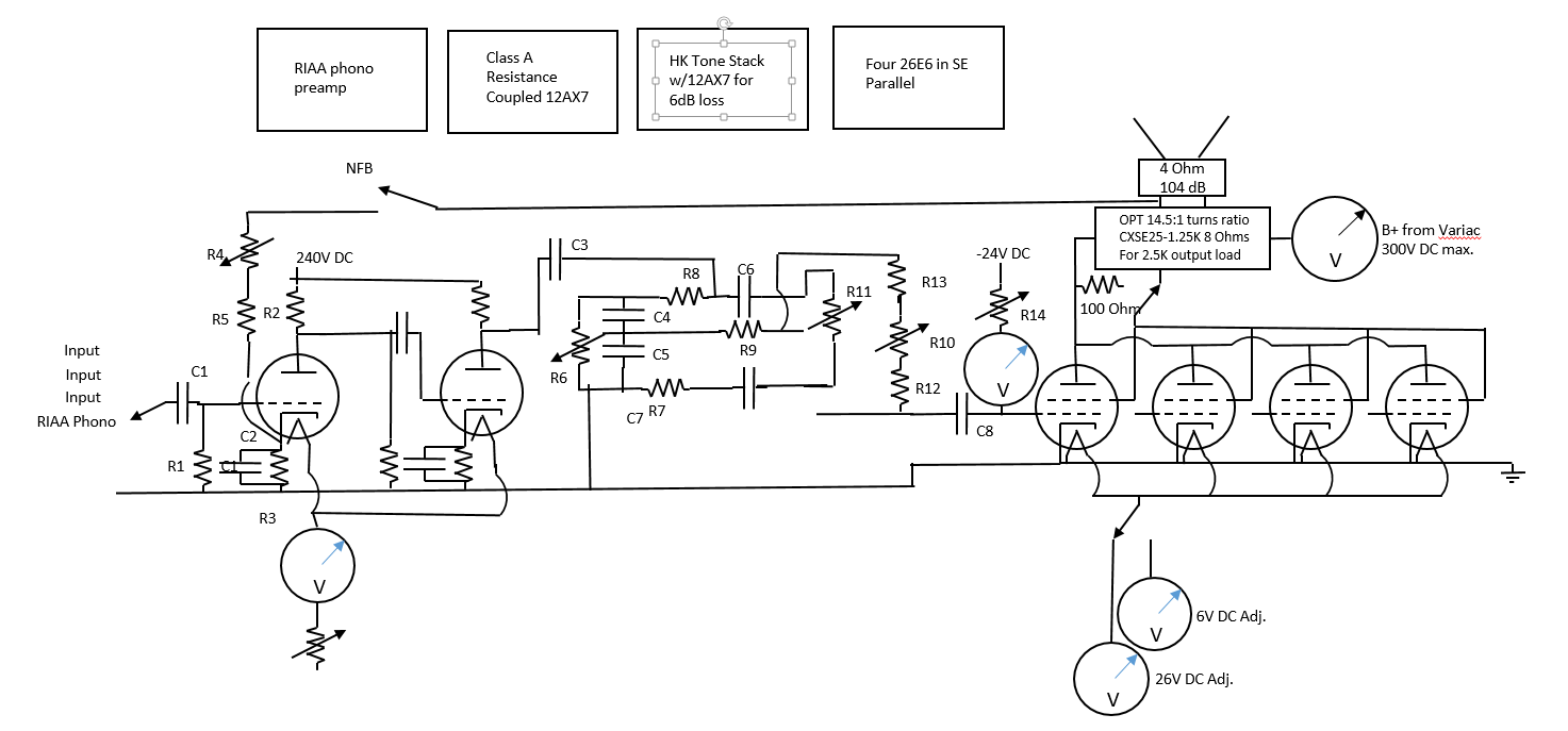

I added a bypass for tone control, and think I made mistakes in doing so:
Do I need to shut down the first 12AU7 to avoid excessive gain when tone is bypassed?
Do I need to open the tone control's connection to ground when bypassed?

The Marantz models 2, 5, 8, and 9 insert tone control immediately prior to the output tubes, and bypass the tone control with NFB
The HK models 224, 230, 250, and 700 move the tone control earlier in the circuit, before phase split and drive, and they delete NFB
The Scott models 72, 210, 222, 299, and 488 position tone like the HK, but move volume control to follow tone control
Some Zeniths place both volume and tone prior to the first tube
Unfortunately none of them provide a bypass switch to eliminate the mess!
So I thought that I was plagiarizing HK with only one gain block prior to tone control. Although I had truncated NFB to follow tone control on advice of forum members, and was trying to add a bypass for tone
Since you will have a RIAA stage before the preamp, it makes more sense to put the volume control after the tone control, and if you make the first stage of the preamp have a gain that equals the loss of the tone control, then you can simply bypass both with a switch, while still retaining the gain needed to drive the power tubes.

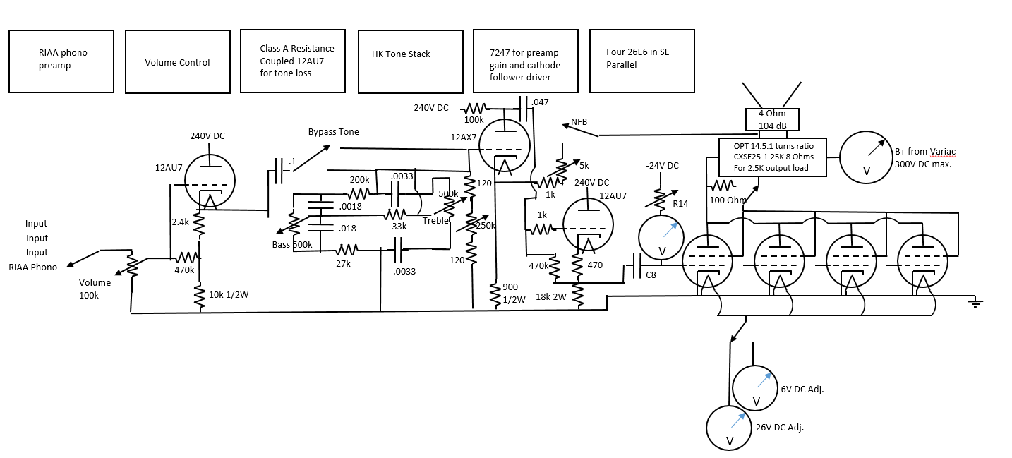

I am now using the Max Robinson enhancement of the HK tone which uses a 12AX7 with gain of 10 to comp. the 20dB loss, and a bypass for both.
However I also show a 2nd circuit in which I replaced Max's 12AX7 with a 12AU7. To me it is more intuitive to achieve the low gain with the AU, and I do not understand how he is achieving the low gain with the AX.
