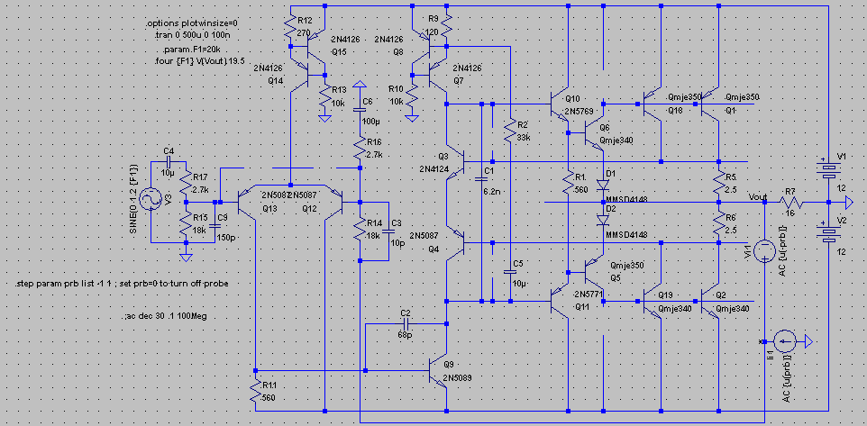

PaulBysouth said:Keantoken,
The bias scheme for your output stage has first published by a W. Allison in Wireless World in Dember 1972 (which is worth reading if you can find it). I have spend the last 12 months or so carefully analysing this circuit for a variety of possible uses.
I don't understand why it is rarely used, as it appears to be very good.
I have attached (I hope this works) a design that I was working on last year (but never buit) for a good unity gain buffer, which turned out to much better that typical diamond buffers.
The bias scheme for your output stage has first published by a W. Allison in Wireless World in Dember 1972 (which is worth reading if you can find it). I have spend the last 12 months or so carefully analysing this circuit for a variety of possible uses. I don't understand why it is rarely used, as it appears to be very good.
However I have found that having multiple devices between the bias controlling transistors and the output can result in some instability (especially with square waves).
I have attached (I hope this works) a design that I was working on last year (but never buit) for a good unity gain buffer, which turned out to much better that typical diamond buffers. Note the placement of the high frequency compensation capacitor (22pF) and the base resistor (1k). In this circuit I chose to drive it between the emitters of the bias control transistors (which gives the lowest distortion), however it can be current driven, which is how you (and the original Allison circuit) drive it. I also found that Mosfets gave better results than darlington transistors (though this could just be due to Spice model quality or lack of).
Consider doing the following:
1- Use my Allison compensation scheme,
2- Reducing the number of devices in the Allison feedback loop, such as just a simple darlington or Mosfet (irf610 would be good),
Note that the value of the resistors to bias control transistors (1k R4, R5 in the attachment). If voltage driven via the emitters then these resistors need to be in the range 500 to 10k. Large values allow the circuit to go into Class B operation. If current driven then the resistors need to be low (zero to 1k) - low values give current limiting, high values allow Class B operation.
I hope this is of help.
When I have some time to prepare the numerous diagrams, I'll publish the numerous ways that this bias scheme can be used. Using it as a driver for an output stage shows great promise!
Paul Bysouth Feb, 2009.

Keantoken,
Just to be clear, the frequency compensation resistors and capacitors go (referring to your circuit in Post #35) ...
- resistor between the emitter of Q1 and the base of Q3 (let's call it Rb), and
- a capacitor between the base of Q3 and the base of Q10 (let's call it Ca),
- similarly for the lower half (Q2, Q4, Q11).
As you are current driving the collectors of Q3,Q4 use a value for Rb in the range 100 to 1kohms. A low value will cause current limiting, a high value will allow operation into Class B (with an increase in distortion). Ca will probably be around 100pF.
If you were to drive the circuit between the emitters of Q3 and Q4, then Rb needs to be larger to prevent excess base current into Q3,Q4 (typically 1k or larger). Large Rb values will allow the output to go into Class B.
Adding Rb will also increase the bias current in Q1,Q2 (due to the voltage drop across Ra caused by the base current). So you may need to increase R5,R8 to 12 ohms.

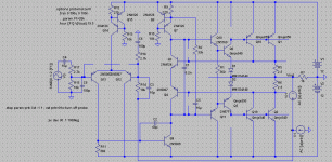

Thank you for more info Paul, I discovered something myself about base current however which I detail below.
Okay, ever since I started this amplifier, something's been going wrong.
I finally figured it out!
It was always trippin'!
Producing random noise. Figured it out!
I'm surprised no one has pointed this out to me. Referring to the attachment in post 35, there is only about .6V across Q4's collector. In my simulations and prototypes, B-C voltage is so low that it shuts off the B-C junction and huge base current ensues. In the schematic below is my current fix. We can also just delete the diodes and connect Q6 and Q5's emitters to the collectors of Q1 and Q2. Pretty much the same thing.
Now it is completely silent and stable and sounds fine, although it still doesn't have the sparkle it did a few tests ago. I suspect that the 2nd harmonic distortion was a result of my asymmetrical layout, with parasitics distributed unevenly. Now everything is symmetrical. However, that might not be it. Before, the LTP was horrendously unbalanced. that could most definitely be the source of H2.
Anyways, right now I know there is some kind of unpleasant distortion, even though the sound is mostly transparent.
I am having a bad problem right now. My oscilloscope only shows signs of slight oscillation, but the heatsinks warm up fast. Plus, I'm getting high off the fumes.
My o'scope is only a tek 561B and the diff. amp only has bandwidth of 300KHz. So I do have a problem.
Not sure how to fix this, but I will try the compensation caps that Paul suggests and see what happens.

from post 19 tells you about the problem.The currents in the collector resistors are now 225mA and 75mA. the volts drop across the pair are 1.058V and 0.353V giving a total of 1.41V for the pair of biasing transistors.
AndrewT said:from post 19 tells you about the problem.
If I understand correctly then the Vbe's of the bias transistors will always be almost equal if we don't take into account the effect of Vcb, which you didn't mention.
The proportionality of the bias resistors' currents will be somewhat nonlinear because of transistor nonlinearities, while the bias transistors are adjusting the quiescent current in realtime.
I don't understand how Vbe can be different for the bias transistors.

That's where our understanding differs.
I think the biasing transistors will operate with different Vbe and different Ib even though the Ic of both is almost identical (within the limits of the difference in Ib).
Have you ever played with the Rush Cascode? It is the same circuit and concept as these biasing transistors.
I don't think the problem you are describing is the problem I am having. The problem I once had, as far as I am aware, is that the Vcb of the bias transistors became so low that they turned off during output swing. I have fixed that problem with the diodes in the schematic I posted.
I may actually be fooling myself and the heatsinks are as warm as they always have been. I need larger heatsinks but that will have to wait.
Could you describe why you think the Vbe's of the bias transistors will be unequal?

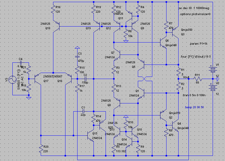

keanton,
I have a few comments on the last circuit you posted.
I would replace the Rush cascode with a more conventional Vbe multiplier. While the Rush circuit is useful in some applications, a Vbe multiplier is better suited to maintain the proper bias for a class AB amplifier. You can also eliminate D1 and D2.
You need to put emitter resistors in each individual transistor of the output devices. Delete R5 and R6. The purpose of the emitter resistors is to help the paralleled devices share the current. In the real word (vice simulation) these devices will not be perfectly matched and they may not share the current very well. BTW, these resistors are a form of negative feedback. In general, negative feedback reduces the sensitivity of the circuit to variations in the parameters of the active devices.
What are R2 and C5 for?

I can eliminate D1 and D2 without doing away with the Allison multiplier, if I connect the emitters of Q6 and Q5 to the bases of Q3 and Q4. Personally I still want to stay with the Allison (or Rush) multiplier as it makes the circuit unique.
Emitter resistors will be added when I build the official circuit, but I haven't been able to use them in real life because I don't have any.
R2 and C5 help the Allison circuit if you're not driving it from the emitters. It causes the CCS to act as a push-pull counterpart to side-step the relatively high output impedance of the Allison circuit. It doesn't improve distortion much at small signals but it helps when it operates at its max output.
The best way to drive the Allison is between the emitters, and this offers the lowest distortion.
I have discovered a good technique for reducing the size of R5 and R6, and so deleting them should not be necessary. This idea is in the attached schematic, which I will test out next, if I am able to. I would solder this instead of breadboarding, but I don't trust myself with solder yet. Breadboarding is proving annoying and confusing at the least. I suppose I will get used to it. 🙂
- keantoken

With this I think the Allison multiplier is perfectly fine to use in a class A amplifier.
- keantoken
I got the output stage to my latest schematic working.
It seems that the voltage across the bias resistor keeps going up by 100mV every time I turn the thing on.
Everything is normal, however.
EDIT: I just built the LTP portion. Wow, it put out a pure 1.5MHz sinewave! None of my circuits have looked that good whilst in oscillation!
I was only able to detect this with my oscilloscope's highest sweeprate setting. This probably means I did something wrong building it, because if it was unstable enough to oscillate I would expect a higher frequency.
EDIT2: I just now plugged it in to test it out anyways while it was oscillating. It sounds really clean and smooth, sooooooo much better than my previous circuits (it seems I have constructed a fine oscillator indeed - oscillation does not modulate with the audio!). This is with Enya however. Once it cools down again I will test it with some electronic stuff.
There is still weird artefacts, probably a B-C junction shutting off somewhere in the Allison or associated circuitry. I can probably fix this with a diode.
- keantoken
- keantoken
Okay, I've got it to stop oscillating. Listened to it and it sounds decent, will listen more.
I'm in dire need of larger heatsinks, I will try to drill holes in a good one I have with a hand drill but no guarantees. :/
I would describe the sound as very relaxed, not very bright.
Whereas my old design was very unstable and very hard to get working and had strange problems, this one has given me no trouble.
- keantoken
- keantoken

I didn't notice any difference when it was oscillating, from when it was not.
I managed to drill two holes in a heatsink I have and so it can handle longer listening times.
I'll say now that it doesn't sound as clear as older versions. Perhaps this has to do with something in the LTP. We shall see. There seem to be plenty of unpleasant harmonics. Hopefully it's just glitching.
I don't really have any good reference CDs, unfortunately.
I suspect bias current is a bit high. I shall switch to 2.5 ohm bias resistors and see if I can run it cooler.
- keantoken
- keantoken
