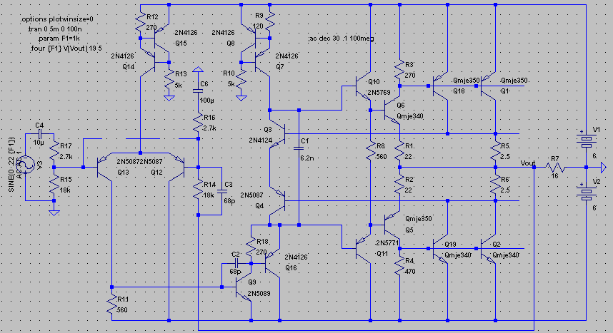

I couldn't figure out why my circuit was clipping. Now I know why. The CCS on the output stage won't deliver its current on strong negative peaks and the only solution to this is more voltage. Now it will run on +-12V.
So I should get enough amplitude to fry those little MJE's.
Here is the current version I am working with. We have graduated to a CFP VAS.
- keantoken

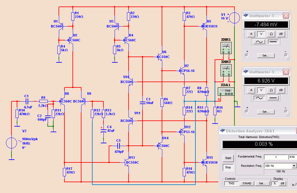

I setup your 6 Watt Class A using:
- BC560C, BC550C
- BCP53-16, BCP56-16 .... new SMD variants of BD139/140
- MJE15030/31 ... fast 50 Watt TO-220 power transistors
Comp. cap C5 needs to be 470pF to stabilize.
This gives an upper bandwidth of ~1 MHz at gain 10.
With the addition of C2 (100pF) at the input the rolloff is at ~550 kHz.
At 6 Watt Class A output the THD is 0.003.

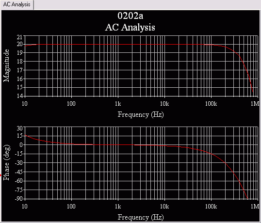

lineup said:Here you have AC analysis.
After adding C5 470pF and C2 100pF.
The rolloff is at 550 kHz and -45 degrees at 300 kHz.
Haven't done the FFT fourier yet.
I have not examined the C3, 10 nF. What value this cap needs to have?
C3 IS needed to keep the bias transistors from oscillating. The cap I'm using on the breadboard is a Wilma FKP 1, 6.2pF. Rated for 1.6Kv! 😀😀
I realize the need for emitter resistance on the output devices but I don't have those kind of resistors. Currently I am without them.

Your amplifier idea is basically very good.
If you look at my schematic, I use 0.82 Ohm to set the output bias to ~0.8 Ampere (peak out = 1,6 A)
It may be enough with using 1 Ohm here, for 0.65 A = peak 1.3 A output.
Depends on the impdance curve of your 8 Ohm speakers
and your needed peak output power.

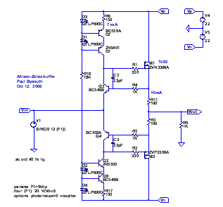

Keantoken,
The bias scheme for your output stage has first published by a W. Allison in Wireless World in Dember 1972 (which is worth reading if you can find it). I have spend the last 12 months or so carefully analysing this circuit for a variety of possible uses. I don't understand why it is rarely used, as it appears to be very good.
However I have found that having multiple devices between the bias controlling transistors and the output can result in some instability (especially with square waves).
I have attached (I hope this works) a design that I was working on last year (but never buit) for a good unity gain buffer, which turned out to much better that typical diamond buffers. Note the placement of the high frequency compensation capacitor (22pF) and the base resistor (1k). In this circuit I chose to drive it between the emitters of the bias control transistors (which gives the lowest distortion), however it can be current driven, which is how you (and the original Allison circuit) drive it. I also found that Mosfets gave better results than darlington transistors (though this could just be due to Spice model quality or lack of).
Consider doing the following:
1- Use my Allison compensation scheme,
2- Reducing the number of devices in the Allison feedback loop, such as just a simple darlington or Mosfet (irf610 would be good),
Note that the value of the resistors to bias control transistors (1k R4, R5 in the attachment). If voltage driven via the emitters then these resistors need to be in the range 500 to 10k. Large values allow the circuit to go into Class B operation. If current driven then the resistors need to be low (zero to 1k) - low values give current limiting, high values allow Class B operation.
I hope this is of help.
When I have some time to prepare the numerous diagrams, I'll publish the numerous ways that this bias scheme can be used. Using it as a driver for an output stage shows great promise!
Paul Bysouth Feb, 2009.
