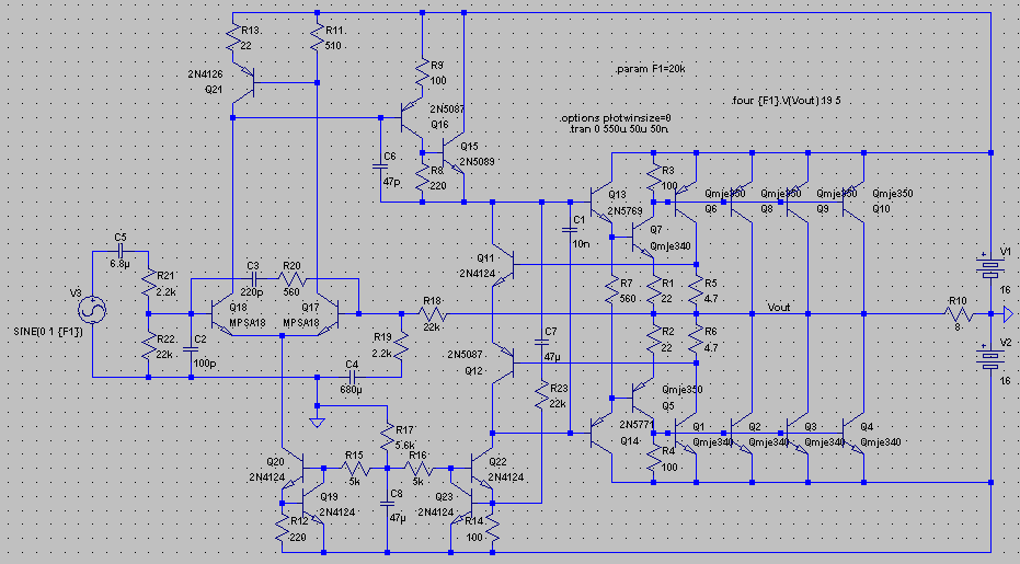

Hi all.
I have shown a few design ideas on this forum. One of the reasons I have been testing and simulating many different ideas is that I was trying to find an amplifier that I could build to give low distortion into an 8-ohm load loud enough to fill my room (which is quite small).
This amplifier sims good enough for me to try as a project, and I haven't run into any stability problems.
Simulation results:
THD @ 6W, 8ohms, 1KHz is about .0002%
THD @ 6W, 8ohms, 20KHz is about .0012%
I have enough parts (minus bias resistors and heatsinks) to build two of these for a stereo setup.
However, it still might take me some time to buy the few needed components.
What do you think?
- keantoken

Except those mentioned from the good friend Nelson, from my recent experiments on my project, i have the following remarks:
1. C3-R11 network it is placed usually between the collectors of LTP.
2. The C2 of 100pF needed in the case of using an input attenuation pot (before C5) to suppres the oscillations caused from the interaction between pot and C5, and it reduces high frequencies response. C2 and C6 are the components that affects the high frequency responce. You can play with the values of these two caps to obtain the better result which is small rise time and no Miller oscillations.
You can also decrease the value of C5 down to 2,2ìF without loss in low frequencies if you intend to use some good quality foil polypropylene cap, for having the smallest posible inductance.

Oh, thanks Mr. Pass. 🙂
I just tried it but didn't see any affect on distortion. I'll leave them in though.
Things I need to know before building this:
1: How large a heatsink I need.
2: What kind of transformer I need. Rail voltage is 18V each, max current draw is 2A.

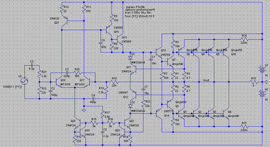

Also, I solved a really weird problem with two diodes. The output would sometimes short to one rail because of current through the C-B junctions of Q11 and Q12. 😱
See attachment.
Also, fotios, thanks for the advice, especially for C5.
R20 and C3 work well to keep the circuit from oscillating, as I have discovered recently. A great many of my old designs should be able to become more stable as a result of my recent learnings.
Thanks all,
- keantoken

16Vdc rails should allow around 11Vpk output into your 8r0 load. I suspect you'll get a bit more.
11Vpk = 7.5W and = 1.4Apk.
The bias of a ClassA push pull amplifier must be set to around 700mA to achieve that 7.5W of classA.
Each output device will pass 700/4 = 175mA of bias current in the quiescent state.
Look at the voltage drop on that 4r7 collector resistor on the first output device pair.
822mV across the the Base Emitter junction OOPS
your protection scheme prevents you setting up the bias current. even if you reduce the bias current to get ClassAB in the output stage the protection will start to trigger @ ~ 85mA. That's just 340mA to the 8ohm load. That's the protection triggering at less than 1W output when in ClassAB and preventing operation in ClassA.
Learn to design on the back of a postage stamp before building a prototype.
Put in those emitter resistors.
Nelson told you, do it.
BTW,
an 8ohm severe reactance speaker can draw peak currents approaching 3.9Apk on fast transients from 11Vpk.
Your output stage must be designed to meet this demand or it's not going to sound nice. Yes, it goes into ClassAB on transient peaks, but it'll sound better if that capability is built in.
4pair of MJE can just about manage this if you keep them cold.

Thanks Andrew.
Q11 and Q12 aren't protection. They set the bias. Note that the emitters are not connected to ground or output.
With the 4.7 ohm resistors this gives about 150mA on the first output devices but slightly more on the others. This gives about 600mA of bias.
My concern here is not squeezing the most power I can out of what I have. I am more interested in making a low-THD circuit that sounds good and is loud enough. 10V is more than 6W.
The diodes on the collectors of Q11/Q12 can go. I figured out that the problem wasn't in the output arrangement, but with the LTP. Something's going wonky and I'm not sure what. If I shift parameters sometimes the output will stick to one rail and stay there. One end of the LTP is completely off, the other full on, drawing 3mA from the base of the VAS.
- keantoken
- keantoken
150mA of bias current sets the pair of transistors to ~705mVbe.
Now swing some output signal/current.
Let's allow +-75mA through each output device for 600mA of total output ~=1.4W.
The currents in the collector resistors are now 225mA and 75mA.
the volts drop across the pair are 1.058V and 0.353V giving a total of 1.41V for the pair of biasing transistors. How do these transistors apportion their base voltage requirement to allow Ic of 225mA and 75mA to pass to the emitters?
If the transistors were truly linear and gave a current that is proportional to the Vbe then all is OK. But transistors do not give proportionality of Ic/Ie with Vbe. They are generally off at ~400mVbe and full on (saturated) @ ~1000mVbe.
It's hard to understand your explanation because you don't refer to transistor numbers, but I'm assuming you're talking Q11 and Q12 when you say "biasing transistors".
The emitters of Q11 and Q12 are not attached to ground or anything, so there will be equal Vbe for both transistors. This gives about 1.3V across R5 and R6, regardless of whether the resistor currents are equal.
Vcb for both Q11 and Q12 will always be the same value depending on the darlington Vbe's.
