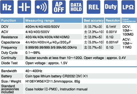

Pls dont laugh. I am just using this Sanwa PM3 meter.
I cant seem to find the input resistance of the meter.

No need to laught at your meter, it can do more than the normal digital meter! The internal resistance is shown under "Impedance", the right-hand column. It is 10meg, thus fine. The move 240-220V should not make such a large difference, but OK if it works better. Please tell what you measure at 'B3".
