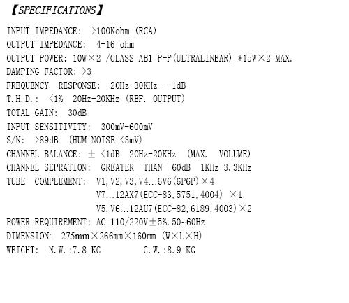

Could someone help out on the circuit diagram above. How much higher can the anode voltage for 12ax7 go higer ?
How do I determine on what conditions the output gets distorted? The 12ax7 cathod bias is only 0.4V.
Is the pre stage working in Class A? How to determine ?
