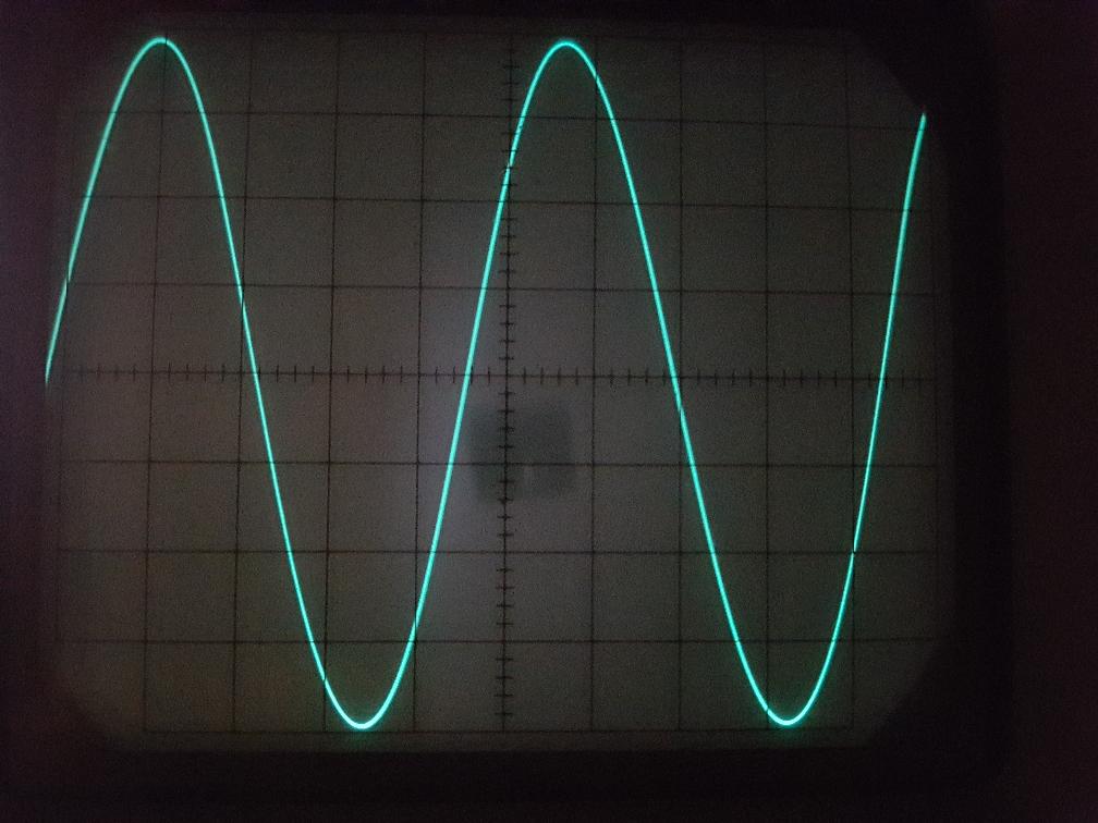

..or so they say. 0.5V/div, 1k, set, -3dB.
