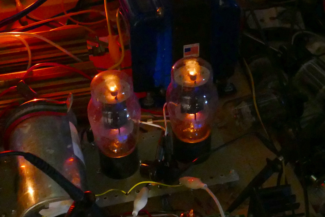

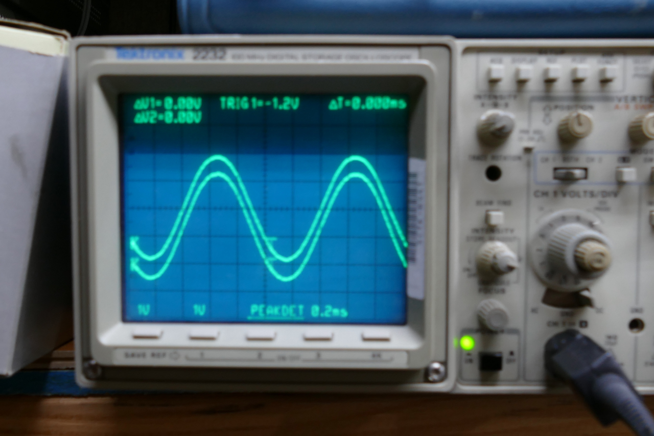

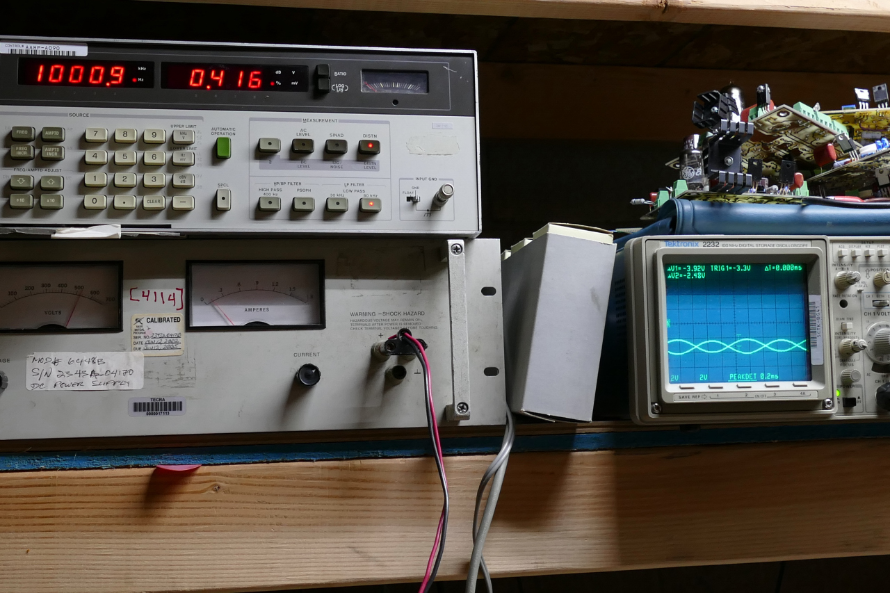

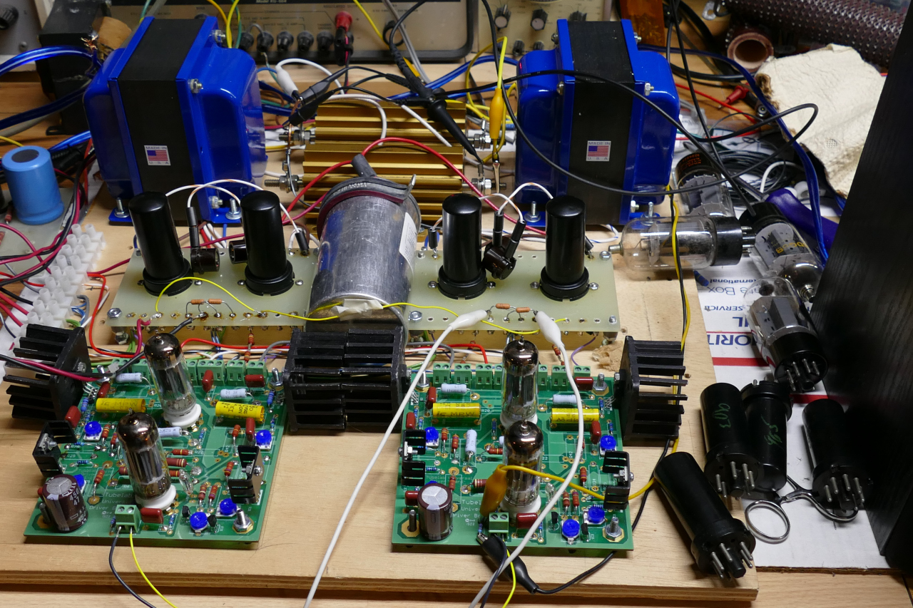

I put a pair of 6L6GA's to the test with a 3300 ohm load. Somewhere around 120 watts OUTPUT from a pair on 525 volts there will be a tube arc due to ignoring that peak cathode current spec (400 mA for the 6BG6). The pictures show 0.416 %THD at 1 watt and 112.7 watts at 3% THD. It ran there for several minutes, then blew up when I increased the B+ voltage then turned the drive up higher. A second test got the same results...blown 1 ohm cathode resistors.
There is a couple pictures of some NOS metal 6V6's happily cranking out 25 watts at 1.125% THD. I didn't push these much beyond the specs since I couldn't see what is happening inside the metal jacket. I put some old glass 6V6 tubes in the test amp, and cranked them up. 31 watts happen at 1% THD.

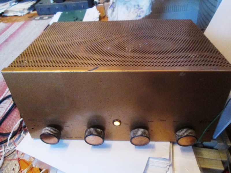

I have an ancient Bogen amp from the mid 50s.
It is one of the best, sweetest sounding 6V6 amps ever made, no contest.
The HT is 365V, which of course with cathode bias means it's running about 345V across the valve.
I measured it, because suprised by the frequency response & THD claims.
Guess what it makes about 10W clean (once sorted out) and yes the frequency response IS as flat as claimed from 25hz-25khz, yes the distortion is as low as claimed, and yes 60yrs later it's still running absolutely fine with valves 50yrs old.

I first tried running them cathode biased, which gave some idea what they might do,- was a bit underwhelmed so went to fixed bias quite quick from there.
So, a bit like you, I whopped it up to 500V, wound the screen to a nice steady 300, pushed back the bias right back to -32V, and hey presto, some fantastic bit of kit.
It doesn't red plate, doesn't run away, but you have to put chokes/resistors in the anodes as soon as they are in PPP, or you get wild oscillation.
After discovering they work perfectly in PPP, (so as a quad), I then had to hammer the daylights out of them to see what they could do...err, yes at 0v on the g1 they conduct 1/4 of an amp... WOW!
I originally used large gas stabilisers on the screens at 300V, pushing them to the max (40m/a). To my astonishment I saw the stabiliser valves extinguising on peaks.

I checked out my nicely rebuilt and modded one against an all singing all dancing Unison research thingy costing 4000USD, supposed to use 300W....
Lower trace that amp, upper trace the 4000USD thing with violent inbalance/distortion.
Says it all really
As you can see even approaching 7-8W it's already way out of kilter.
No wonder it sounds bad.

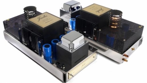

There's another French SE amp from Jadis in the same room complete with whopping 845 and simply giant size transformers.
[/FONT][FONT=Arial, Helvetica, sans-serif]Weight 35kg EACH!
The shop owner begged me not to test it, just in case that 20W max, underpowered pile of dirty sounding rubbish turned out to be just as bad (which I suspect it is!).

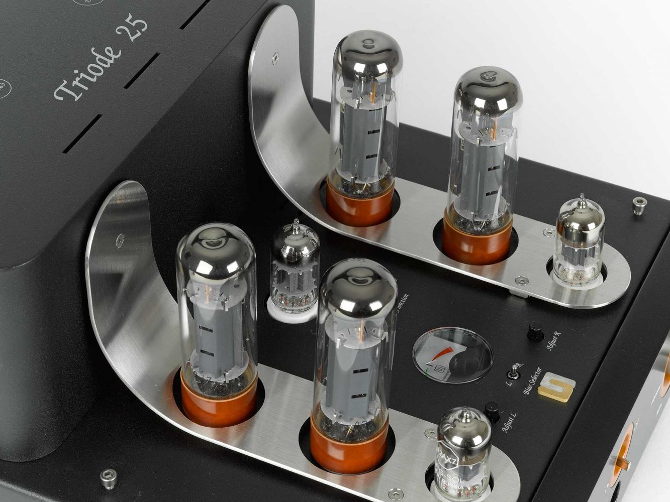

andA pair of EL34 power tubes per side provide 22 wpc in Triode mode and 45 wpc in Ultralinear mode. An elegant, refined amp with power from Italy. $3995 retail
[/FONT]
[FONT=Arial, Helvetica, sans-serif]To ensure high quality sound in an amplifier with a push-pull configuration, however, it is essential that all individual amplification stages, especially the two semi-output amplifiers, are carefully designed and constructed to prevent the formation of dangerous and compromising odd-order harmonic distortion. This is even truer for the output transformer.
The new Triode amplifier 25 has experienced a long and painstaking design and testing period ..
and another load of crap!! 😀
[/FONT]
[/FONT]At first glance this amplifier looks positively handsome. The sample supplied for review sported a real Cherry wood fascia which I found rather attractive.....
[FONT=Arial, Helvetica, sans-serif] 😱[FONT=Arial, Helvetica, sans-serif]Research really have got the recipe right with this amplifier as it sounds sublime to me and I could sit here and probably type a hundred superlatives and you would probably read it in disbelief, .... [/FONT]it was apparent just how lucid and insightful this amplifier really is
[/FONT] [FONT=Arial, Helvetica, sans-serif]Yea right it can't even produce linearly 1/4 of that!
I wonder what they did in their painstaking design & testing?
What are they all smoking?
