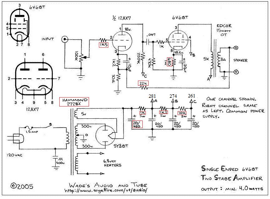

6V6 Output?
triode SE will probably be around 3 watts.
ultra-linear SE will probably be around 4 watts.
pentode SE will probably be around 5 watts.
triode PP will probably be around 6 watts.
ultra-linear PP will probably be around 12 watts.
pentode PP will probably be around 15 watts.
also depends on things like bias point, OPT primary impedance, etc. etc.
Dont put the 3.5K resistor in series with the transformer. Yes, the tube will see something like 8.5K, but thats not the point. The 3.5K resistor is going to drop over 100 volts due to plate current and completely change the operating point. It will also dissipate about 40% of whatever ac output ower is produced, so considering power reduction due to 5k ac load line vs 8.5K, different operating point, and 40% loss in the resistor, you might only get 1 or 2 watts out. (guesstimate, precise numbers would need to be calculated)
You would be better off just using the 5K transformer.
Best of all of course is the 8.5K transformer.
I recently built a 6V6GT Single Ended amp that sounds very good. I have compared it to other single ended amps of known wattage and it has to have about 5 watts output. The guys on this forum helped me tweek the curcuit and it sounds great with absolutely no hum. I would highly recommend it. The output transformers are very inexpensive (Edcors). The schematic is below.

I think you'll like the 6V6 triode strapped SE sound. When you get it up and running, you can also play around with popping in other tubes, like 6L6, or even 6550.
Yes, they'll run at a low operating point, but sometimes the sound can be surprising. I really liked 6550s running this way.🙂
