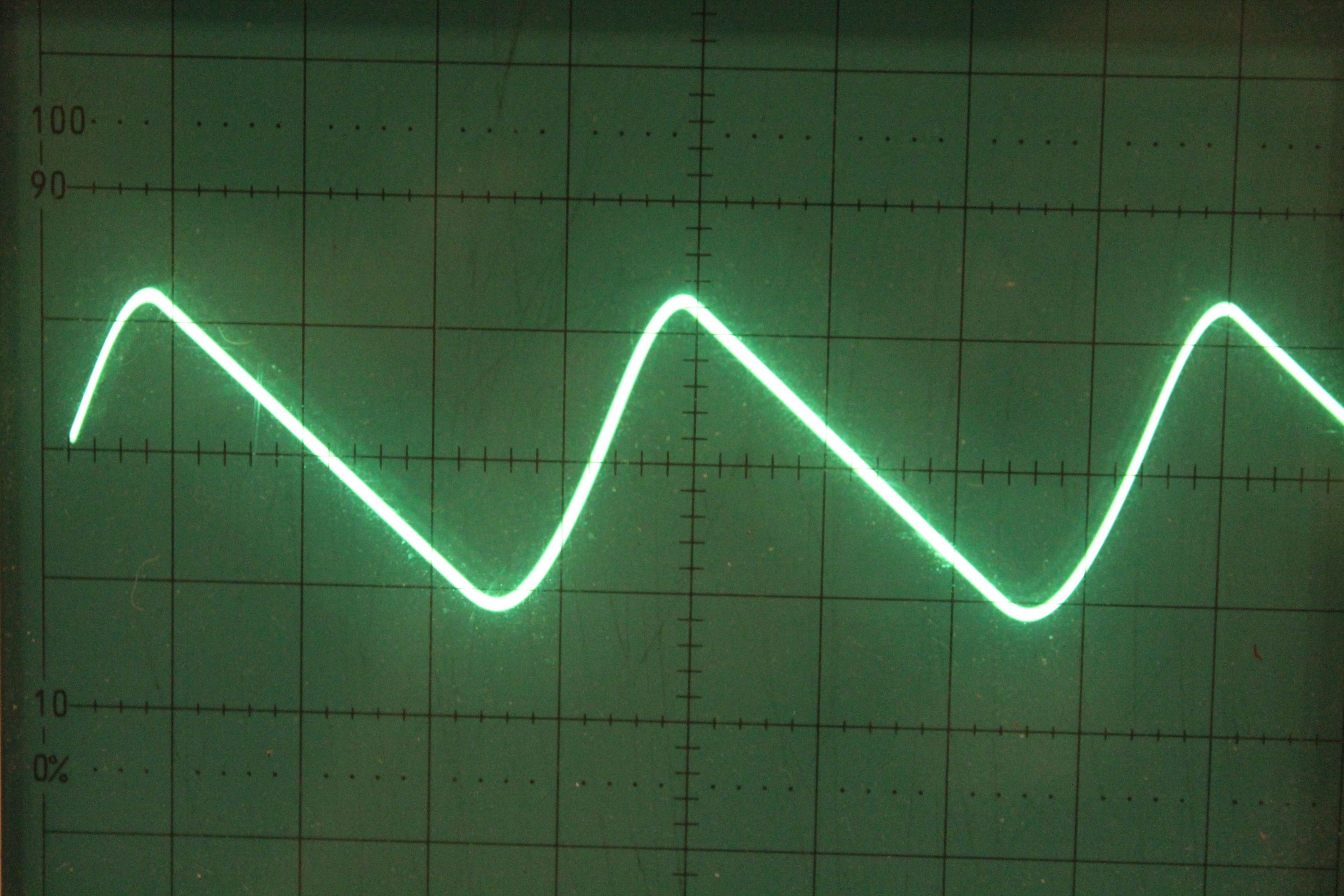

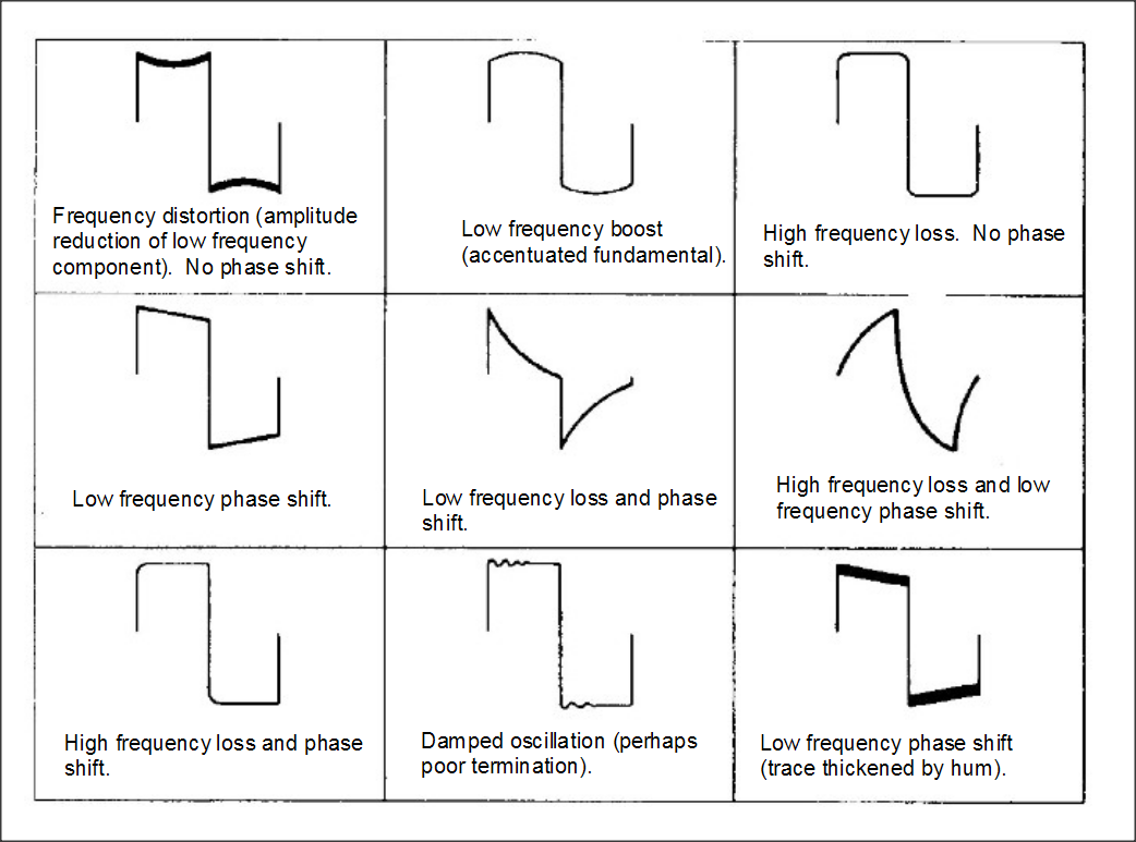

Cool. Lower left corner is a common one on my scoopings, but according to the pic the upper right one, rounded in all corners is better? Phase shift, what does that mean, what happens in the amp and why?

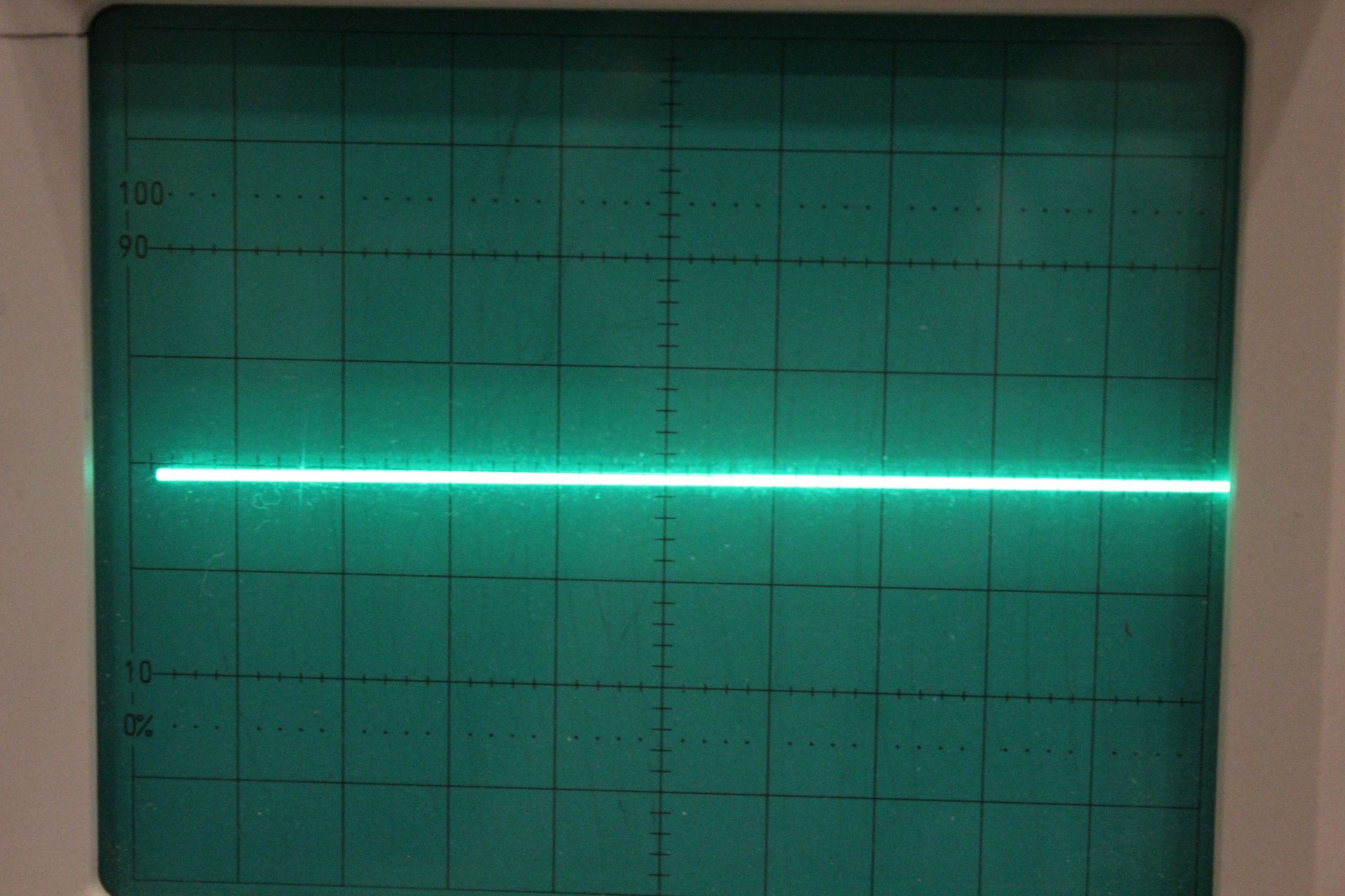

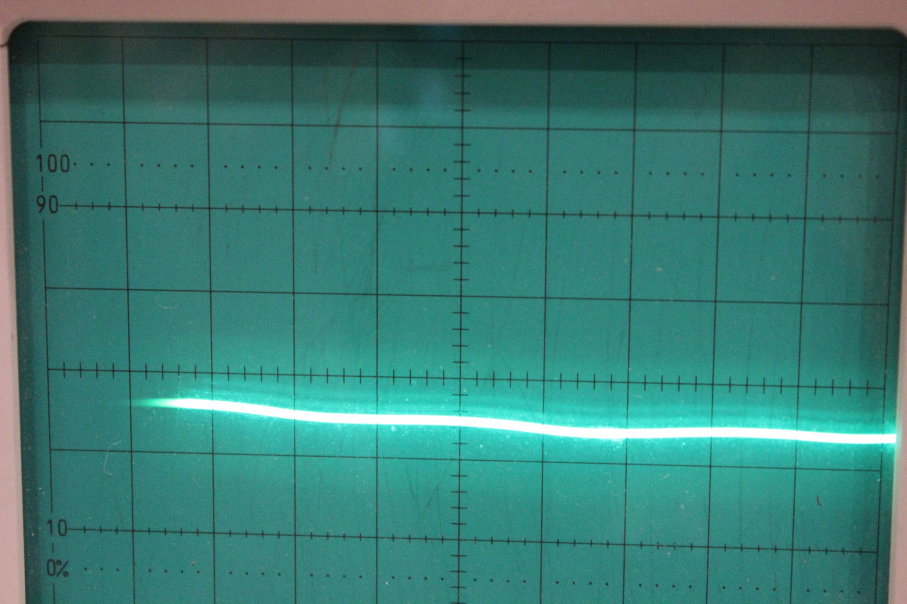

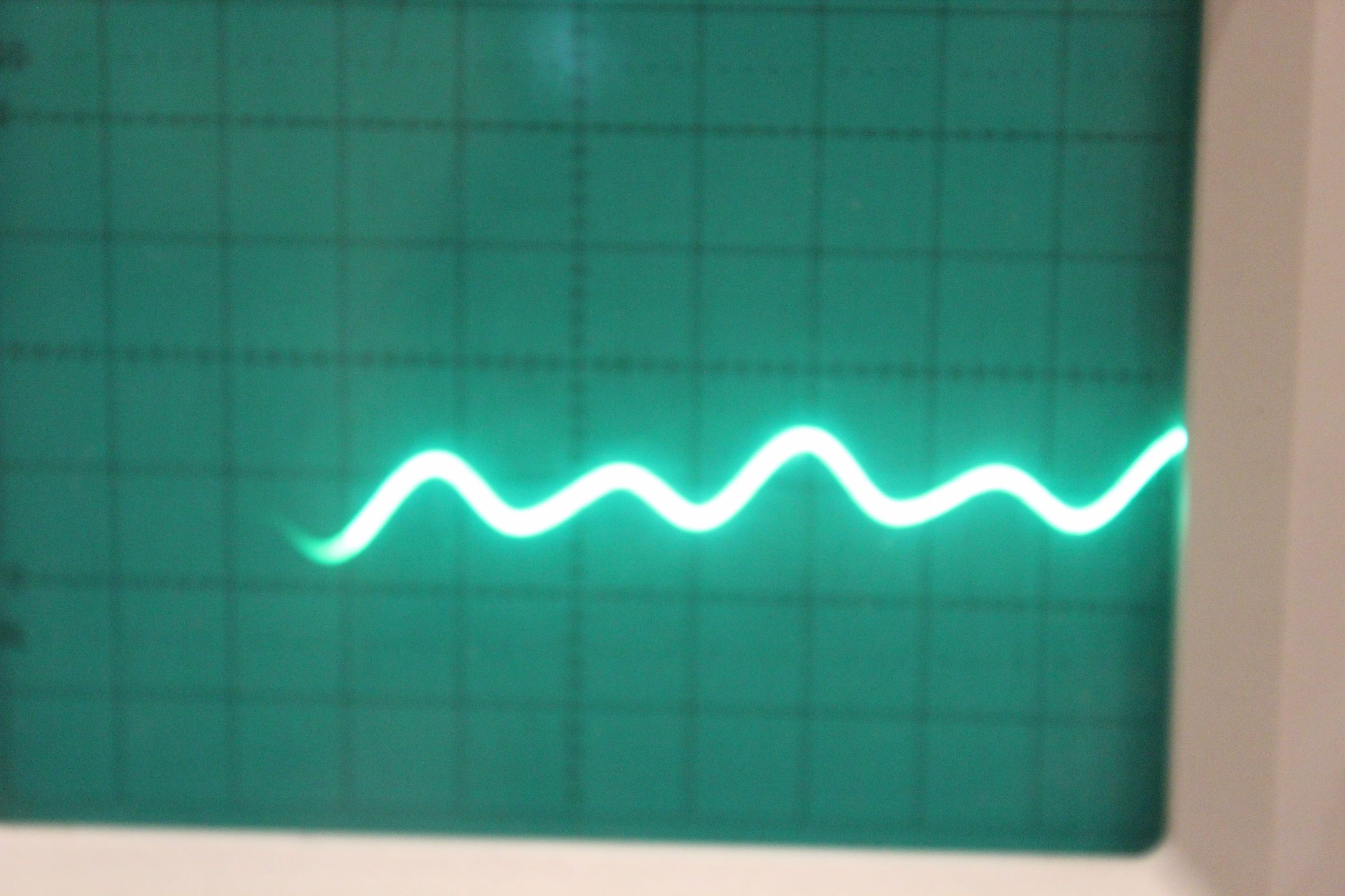

Well. I dont know if theres crap behind the buttons or behind the probes but this is what I could get out of the old Hameg 303-6 I borrowed.
First pic rectifiers (first C) 0,2 V/div 2 ms/div, second pic on second C 5 mV/div 5 ms/div third pic over dummy without SSHV 5mV/div 5 ms/div, fourth pic on SSHV dummy 5 mV/div 1 ms/div

All in order. Told ya it was a ghost.😉
