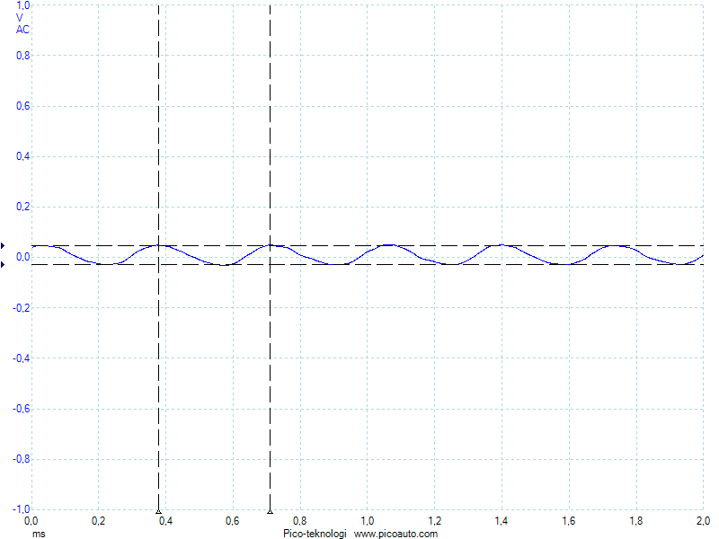

I am to. Heres a shot: 499 mS peak to second lowm 85 mV P-P
I see about 0.32mS peak to peak cycle on that sine given the horizontal scale.

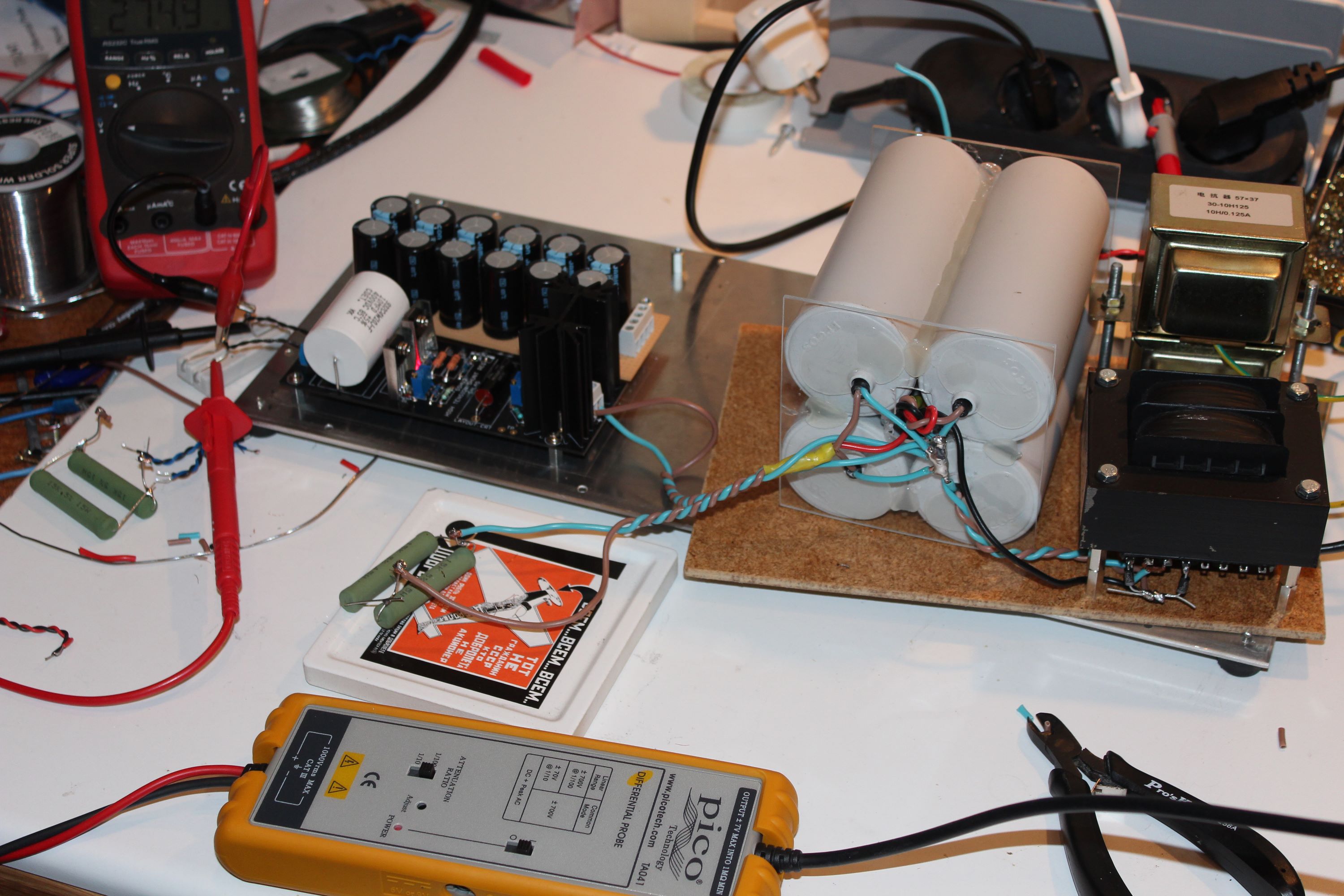

I dug up my antique tripple EL34 bench PSU and started to load with. Ofc enourmous ripple both in and out of SSHV. Started examining the boards. Wopsie, found a resistor R3 with wrong value. Changed that. No difference after tuning. Woopsie, found another one R12. Wtf was I drunk when I soldered them? Changed them. No difference. Then I looked at the documentation and found another schematic. Oh, just different versions of the same stuff (together with trimpots).
Uh. Maybe the DN2540s. They can be sensitive to s
tatic electricity and who knows. Changed all 4 to a new batch. No difference.

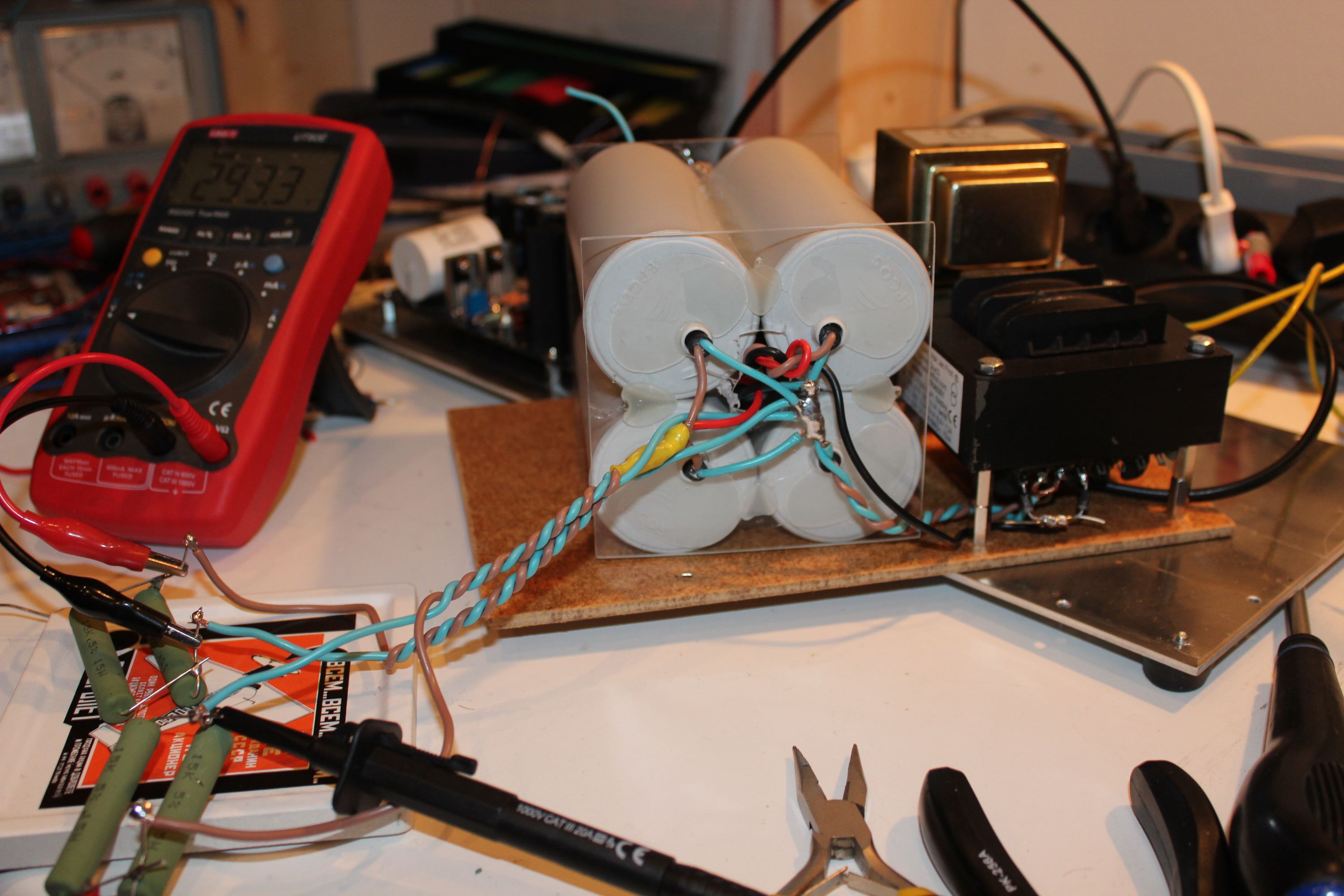

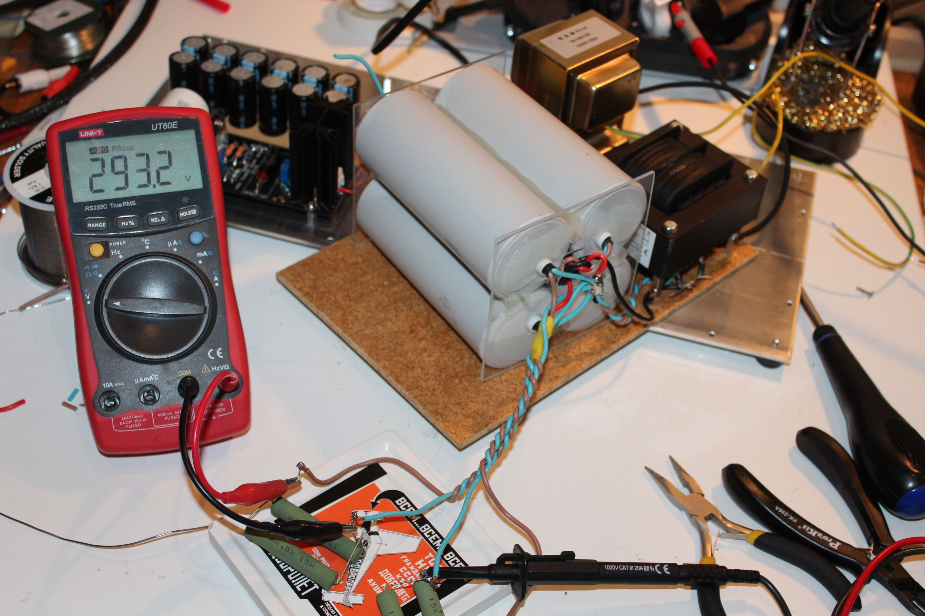

Took a walk, came home and built a 4th PSU. Its stands here now, smelling of hot loadresistors. Dual secondary 230 V CT, BYV26 sand rectifiers 50uF-10H-50uF-10H-100uF, all motors. Stable 293 out. Measures about like the others, a little better maybe.

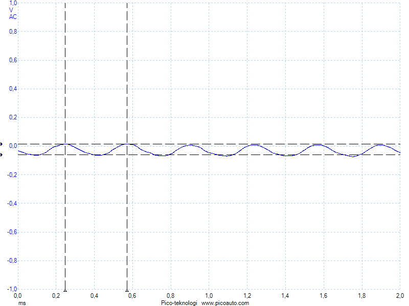

With SSHV same out as in. But, as I look on the Pico with the diff probe, its not much of a difference between when probes are on the DUT or in the air. It just raises amplitude a little.
Measures are probes in the air, on input and on SSHV out.

Put them on the pre and listen for bad clues or not. Changing the feed from your rectification(s) to a tube regulated PSU, from twin to single shunts, or probes just on air, and still picking the same 0.32mS period without serious difference looks like its EMI or an artifact.

When you pick same stuff with probes just dangling on air with what you pick on cables its tell tale its not circuit related.
