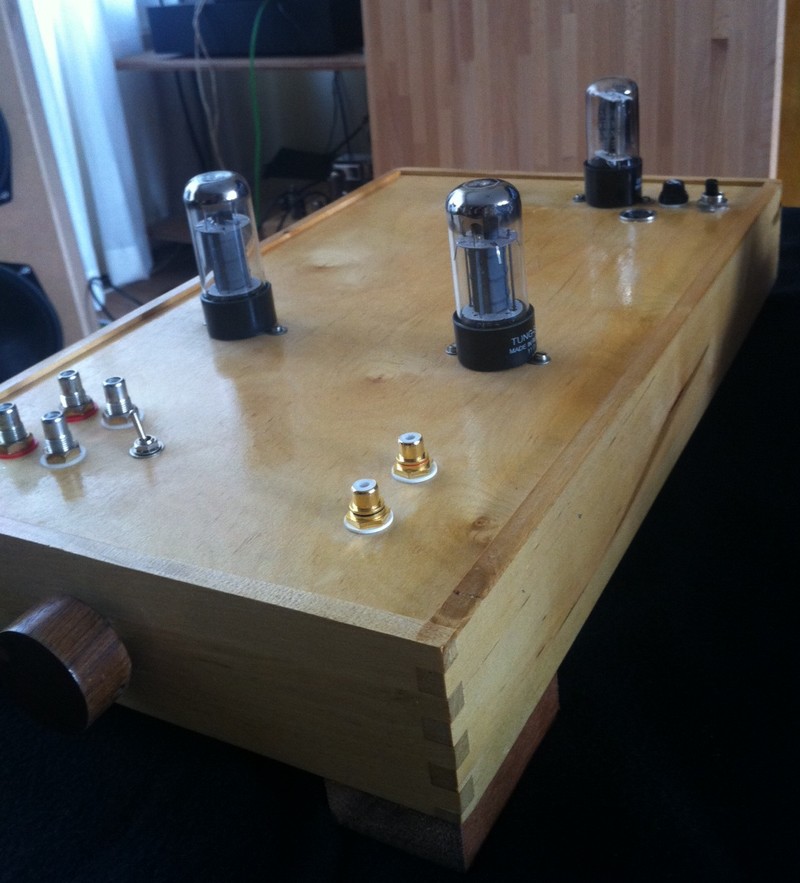

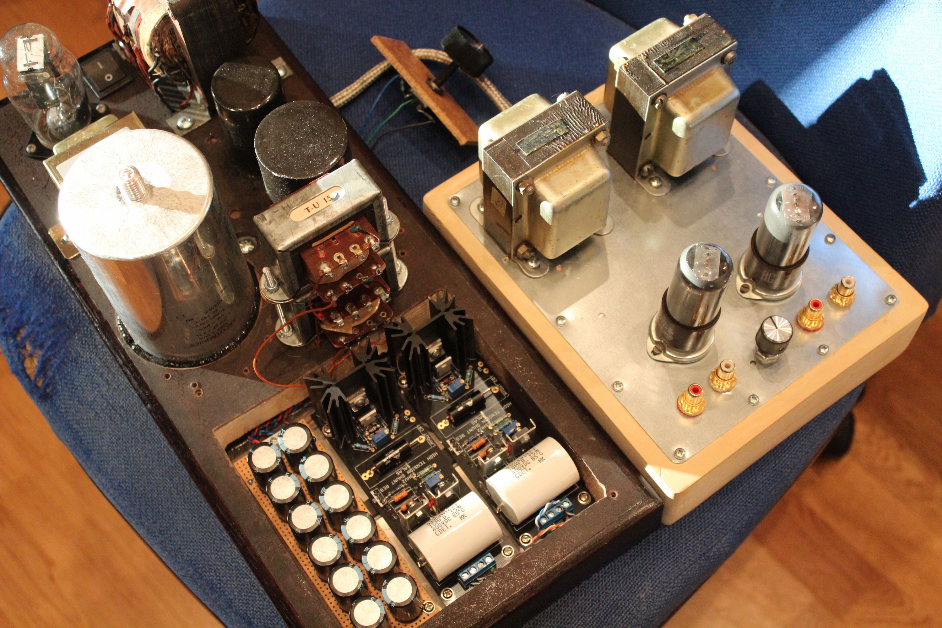

My Salas 6v6 pre. With Lundahl LL1660/25mA output transformers. Without SSHV2 still.
DC heaters via umbilical. Since I had no place inside left.

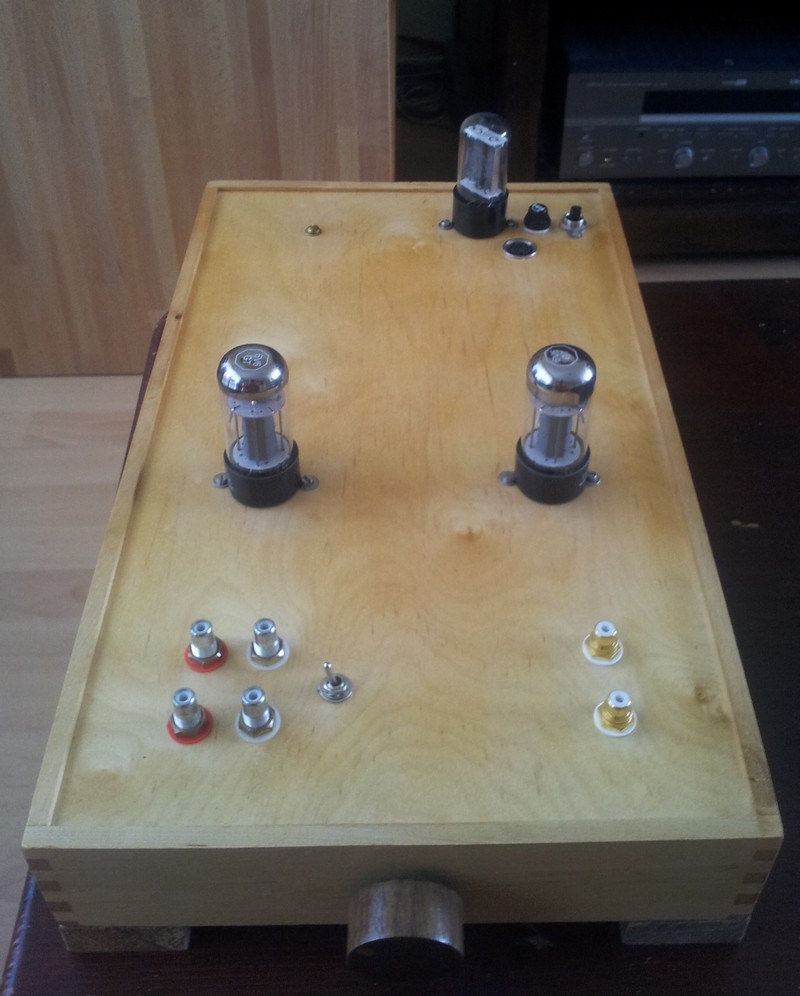

Yep. Ikea cutlery box. Essentially the Salas 6v6 preamps standard. Without shunt reg. Sounds goods. I have never done any measurements on my amps. Because I don't have any facilities to test it with tools. Always use my ears as the final arbiter. Transforms my computer room gainclone by giving it a nice big bold tone. And sounds transparent with that big bottle tone in my main system.... if that means anything. I'll post some pics of the inside and some minor details that differ....simply because I had different stuff in my ports box. Solid state rectifiers with a damper tube after that...and elaborate snubber before the solid state rectifiers....small little chokes in the primary followed by a "standard" snubber..cap->resistor->cap.Nice Bas. Ikea cutlery box? Whats your config and hows the sounds and measures?
Thanks.Looks good Bas!
Yes. I started off with cap input. Essentially it sounds pretty much the same. I mean the main character of the amp does not change really. But I did not want to worry about this cap or that cap anymore and I had no current use for my Lundahl's. Wired them up 4.5:1. In essence I moved to transformer output because I could. 🙂 And I found that the background had less "noise" with the output transformer. Also I preferred the lesser gain of the transformer output.Did you compare it with cap out?
Also how did you wire ll1660?
because I could. 🙂
That line reminds the classic Nelsonian argument.🙂 Can't be wrong using stuff in hand when fitting the bill. I.e. giving proper gain and Zo for a given system in this case. Technically it can add the odd ringing on a square wave if not tuned with primary series resistor and RC across secondary. Cutting some bandwidth also. But to know exactly it takes a gen and CRO. Very nice wooden realization Bas, true diy. Congrats.
Thanks. Thank you again for the design!Very nice wooden realization Bas, true diy. Congrats.

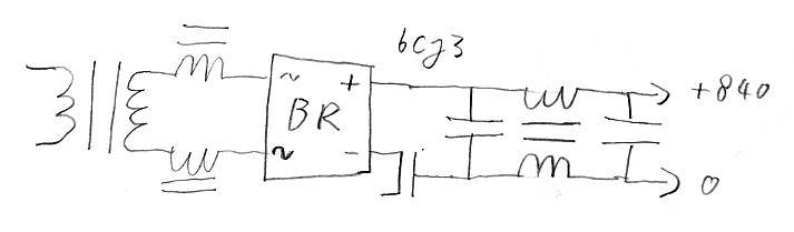

Damper tube? A diode? How does that work?
In series, i guess, it provides a nice slow turn on 😉
Correct. Even though cathode stripping does not occur apparently when HT is present without the heaters being warm. I still like the slow ramp up.In series, i guess, it provides a nice slow turn on
I did not use a common mode choke. That was just to demonstrate the use of a tube damper diode after a ss rectifier.Common mode choke?

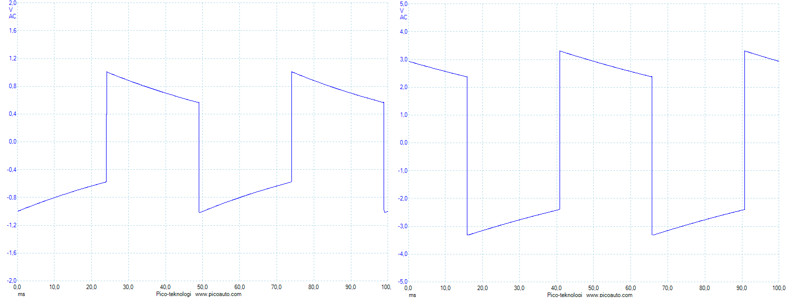

I putted some stuff together today to do some tests. Its a choke loaded cathode follower version with 110 H chokes. Its still ragedirag and I have some absent ground hum but it sounds decent.

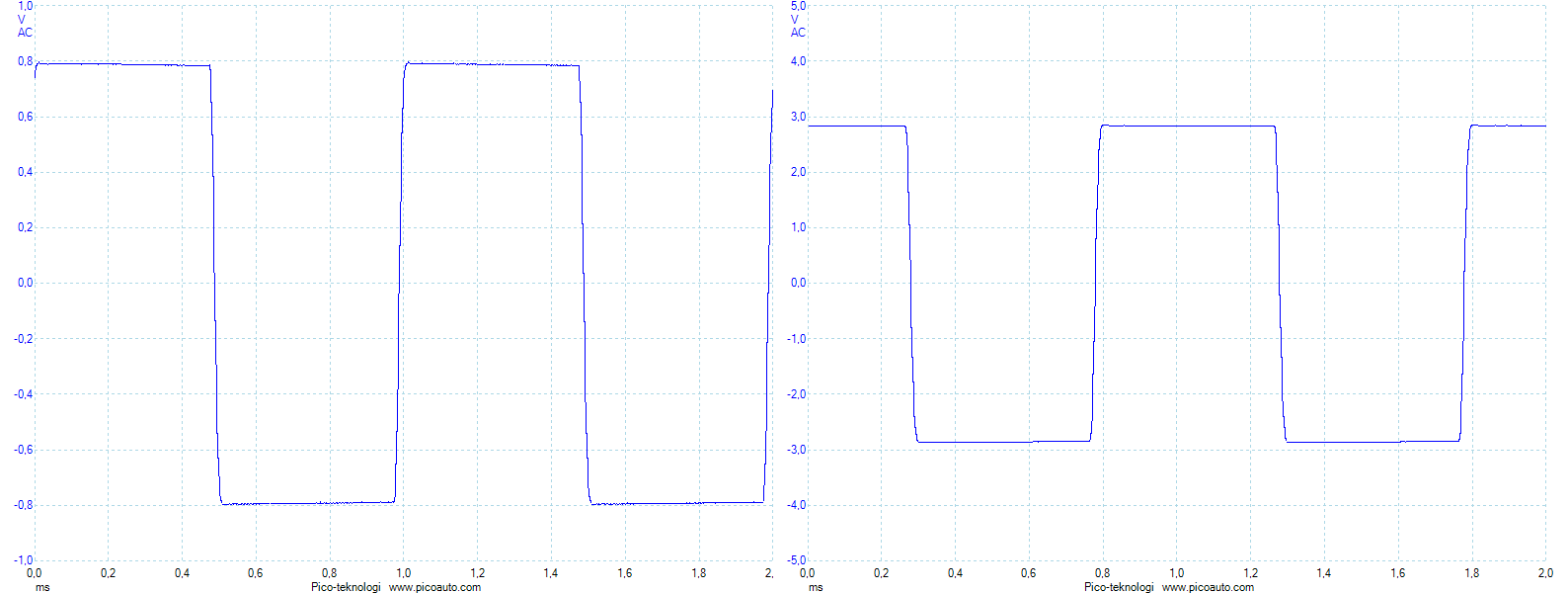

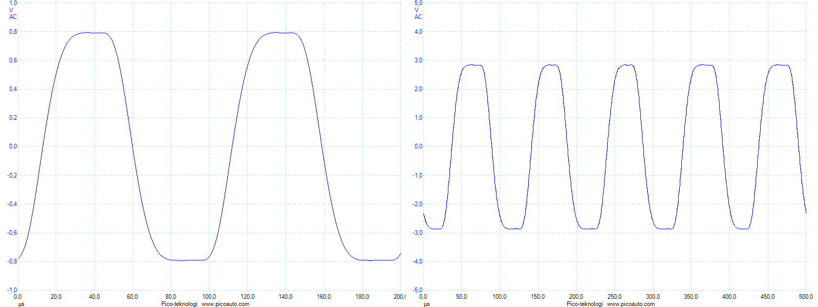

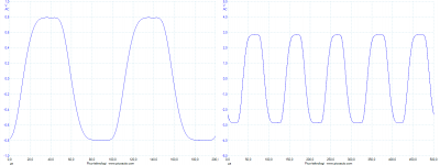

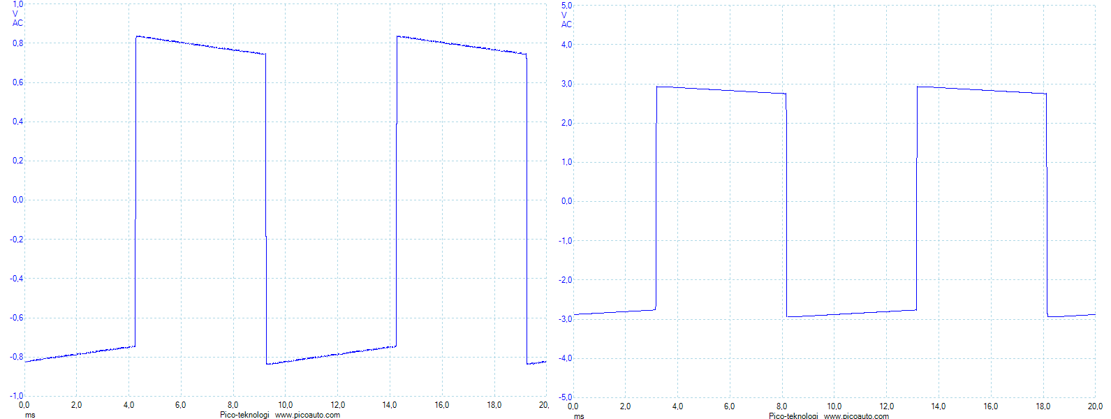

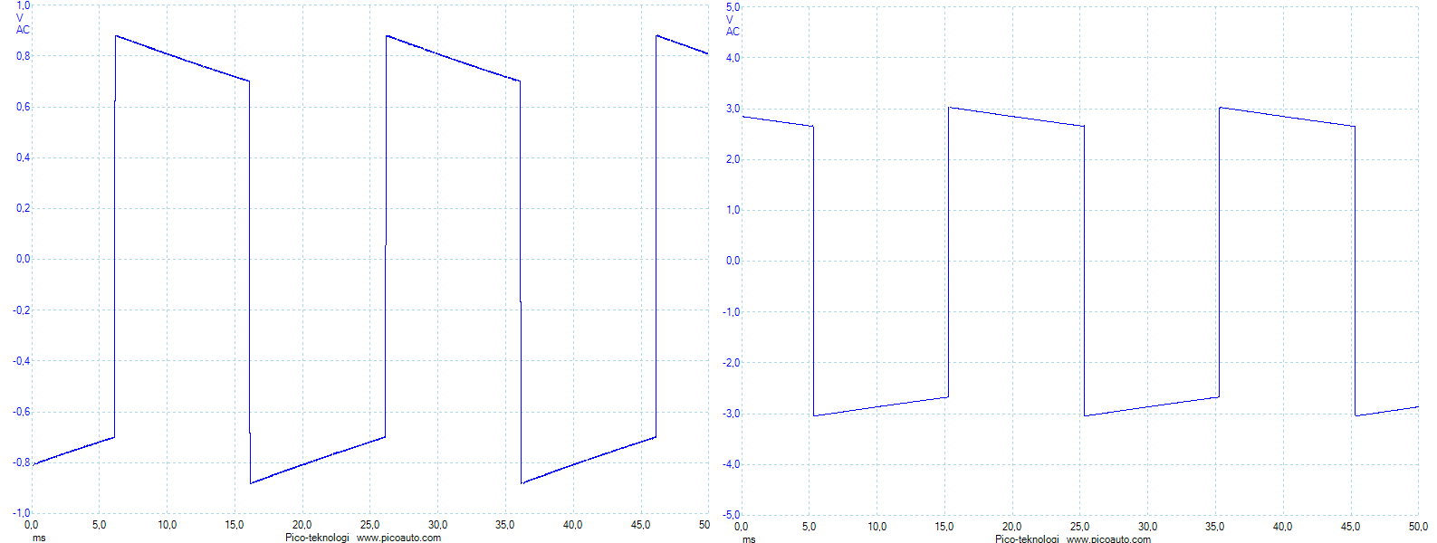

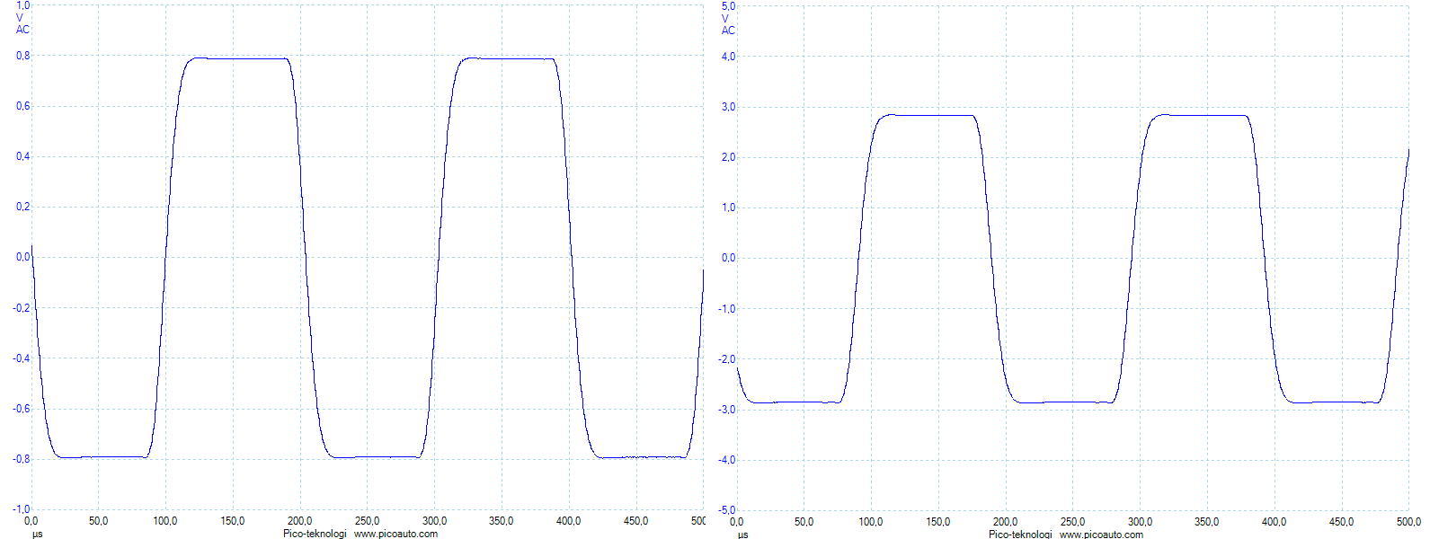

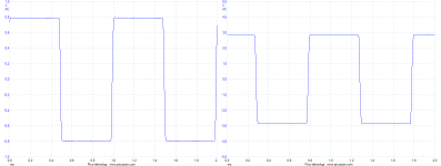

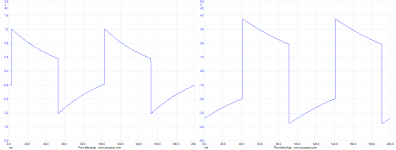

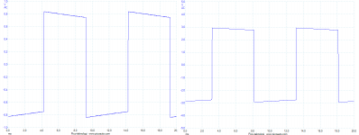

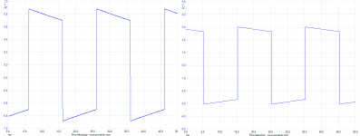

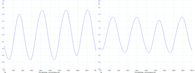

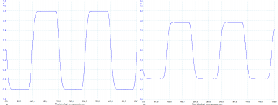

I did some measurments and for compareness I took an old Rozenblitz Grounded Grid that I built long ago. 6V6 to the left and GG to the right.
10Hz, 20Hz, 50Hz, 100Hz, 1kHz, 5kHz, 10kHz and 20kHz. No wiggle at least😛
