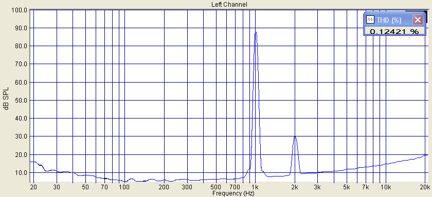

6V6 line preamp
With a 1V P-P input and about 6V P-P output (volume control at max), this is the distortion it charts. Only second harmonic above the grass. 3rd etc are missing in action. Also, otherwise much possible 50 & 100 Hz hum peaks, are missing in action too with the regulator used.
At half the volume rotation, it gives 0.07% THD and 0.051% IMD. I am not sure if the percentages are right or actually lower (I used an IBM Thinkpad which loops 0.05% by itself), but the shapes are correct.

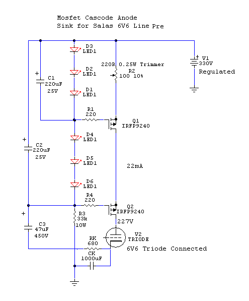

Mosfet Cascode Loaded
Designed some Mosfet cascode anode CCS sinks with parts I had, for the 6V6 line preamp.
Initial impressions and THD measurements are very positive.

Making a small tube out of a bigger tube... How does it compare to normally anode loaded with much more current?

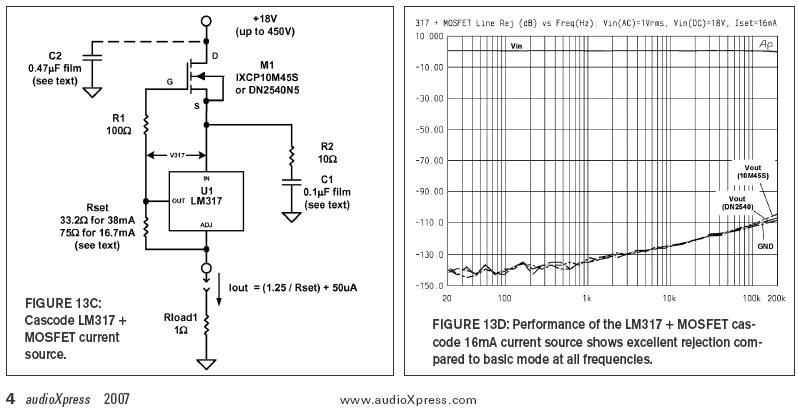

P.S. Waiting for some IXYS 10M45 kindly sent by an Italian DIY member (guglielmope) so I will test this Jung sink with high hopes for even better results.

Zen Mod said:
Salas - I'm just curious ..... you obviously are trying to find best CCS for your purpose , but - did you tried yet to cascode 6V6 itself ..... to ensure constant voltage operation of triode ?
bjt+mosfet wil suffice for that purpose , if not mosfet alone ....
Won't this increase the output impedance? If it remains acceptable, I can try.

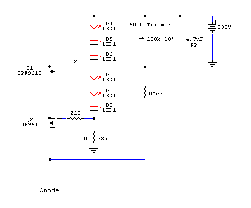

**Meantime, THE BEST active loading to my ears is an electronic choke. Recommend you to try on some project of yours. Alas, I have too sensitive speakers for the gain I get...
principle is ( at least on that schematic , where you forgot to draw point between 3. and 4. led ... hehe) same as with Geek/P10/forgivemeifIforgotsomeone "generic universal CCS-es" , where you have one current setting active element , cascoded with another one ....
look at my :Pumpkin: LTP tail ....
overall - fugly! , what else ?
Zen Mod said:
( at least on that schematic , where you forgot to draw point between 3. and 4. led ... hehe) 😀
Naah, I did not forget.😎 There has to be no connection there. 6LEDS turn on the lower Mosfet. The upper one has the top divider's resistor. If you connect, the voltage on anode will latch up at B+ level.
*This is constant voltage on DC, not constant current. Its a gyrator. Gives the benefit of the constant voltage anode by electronically simulating a large choke (e-choky?:clown: ).
