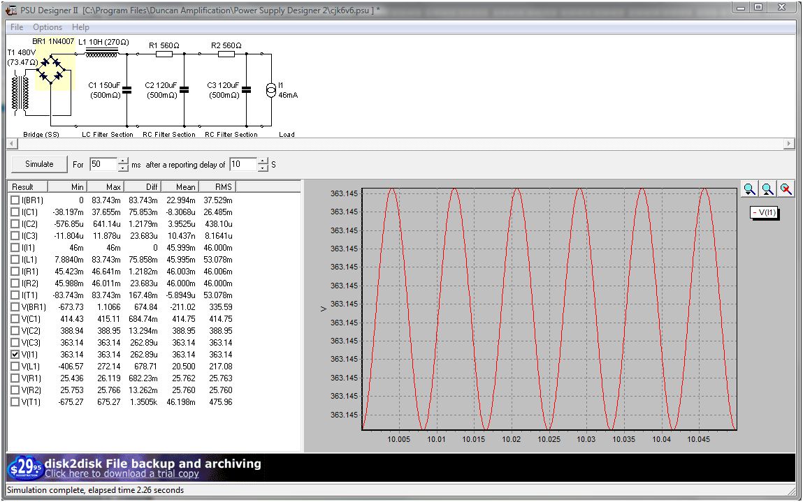

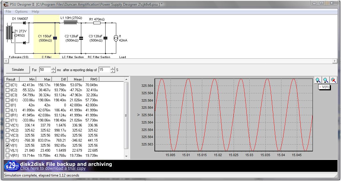

Keeping the choke load and dropping the resistors to 560 looks like I can still get there right?
perookinfect!
47uF after choke means that rectifier isn't jeopardized with induced peaks .......
this solution can be almost on par with best solution - choke input filter+shunt reg :clown: , but we are here slightly short in voltage for that ....
halfen R1 and you've got 20-25 V to shunt, but I dont think it will be audible. Just over a mV already...
main difference is bidirectional nature of shunt reg
it doesn't mean much when we think of it - God ! , that stage is A class anyway ! , but when you put proper shunt reg , there is always difference in sound
positive , for these old ears
:clown:
edit - maybe - as solution for including the reg - is to leave intact just LC , toss everything after , and connect reg .
1440x0,046 will probably be enough of overhead

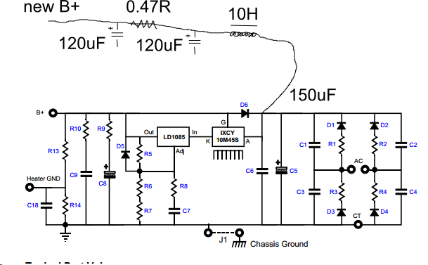

Here is the PSU I whacked up tonight....It is DEAD SILENT now...ear to the tweeter silent. I tried the bridge with the allied xformer and the caps started to sizzle so I shut it down immediately. Have not tried the toroid yet since the first C in the setup is only good for 400V...I placed an order with Mouser today to breadbord up a proper PSU for it and use the PS1 for something else.
Thank you all for ideas and support here...this one was very frustrating...Salas, my friend, you called it from day one...CLCRC works magic on my setup.

Told ya it was racket with the PS-1 reg for some reason.😉 Since you are gear-less to analyze so we could help you combat that, you are better off with passive filter cells. Congrats for you got music finally.
Congrats :cheers: even if I dont quite understand what PSU you really are listening to but anyway here
is a solution good for 800 volts as first cap if you dont want to wait for Mouser and DHL. Gives you a healthy bleeder as bonus.
Counts as 47 uF
Best
Staffan
So, this is the PS1 HV schematic, and how I temporarily modified it...sorry for the crude paint like image but I think you will get the idea.
I will get a breadboard this weekend and yank you the PS1 PCB.
