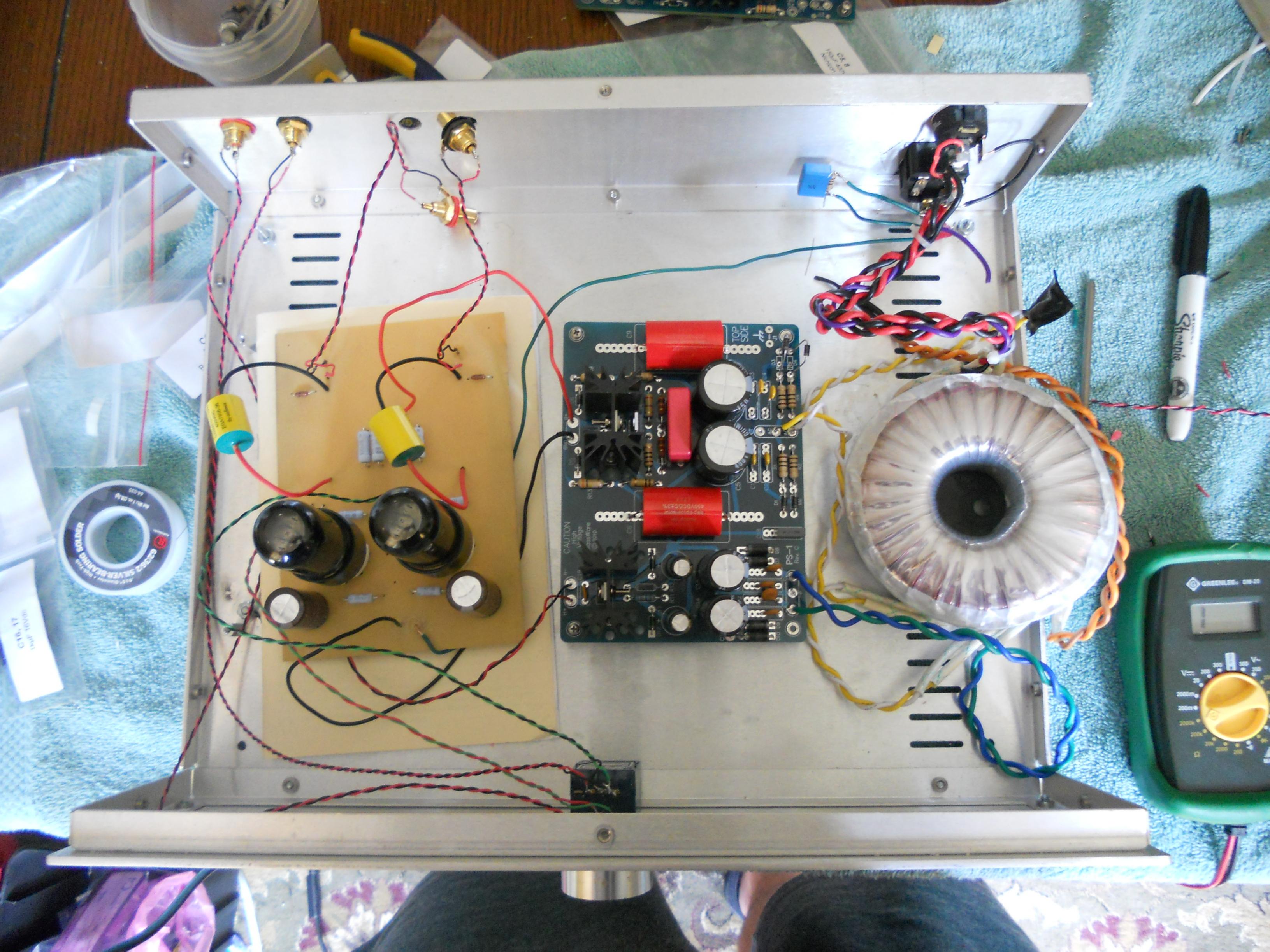

I went RCA ground to pot ground. then ran another wire from pot ground to board ground input. Could this be causing my ground loop?

RCA input Earth to pot, then from the pot earth connection to the board input ground.
Question though...where should the RCA output ground originate? The way mine is set up it ends up being the same point as where the input ground originates. I started thinking that this may be causing the loop.

Star earth signal gnd everything to the cathode resistor's ground point to have a visually clean earth reference node, could be one idea.

post pics of your amp. It may be a routing/wiring issue. Show the whole amp with pics of each compartment/section. May be good idea to look at your amp and draw diagram/ schematic. Sometimes in drawing it yourself, you can see where you made an error.
keep power supply wires away from signal wire
amp board and supply board should shift/change place
yup...rearranged to this and did two more things...

After I rearranged it with the EI core xformer it came on and played nicely for about a minute and then the humm came back. Thats when I tried the toroid.
So I am at a total loss here...I even threw in a pair of EL34's again to rule out the tubes...and same thing...hummmmmmmmm

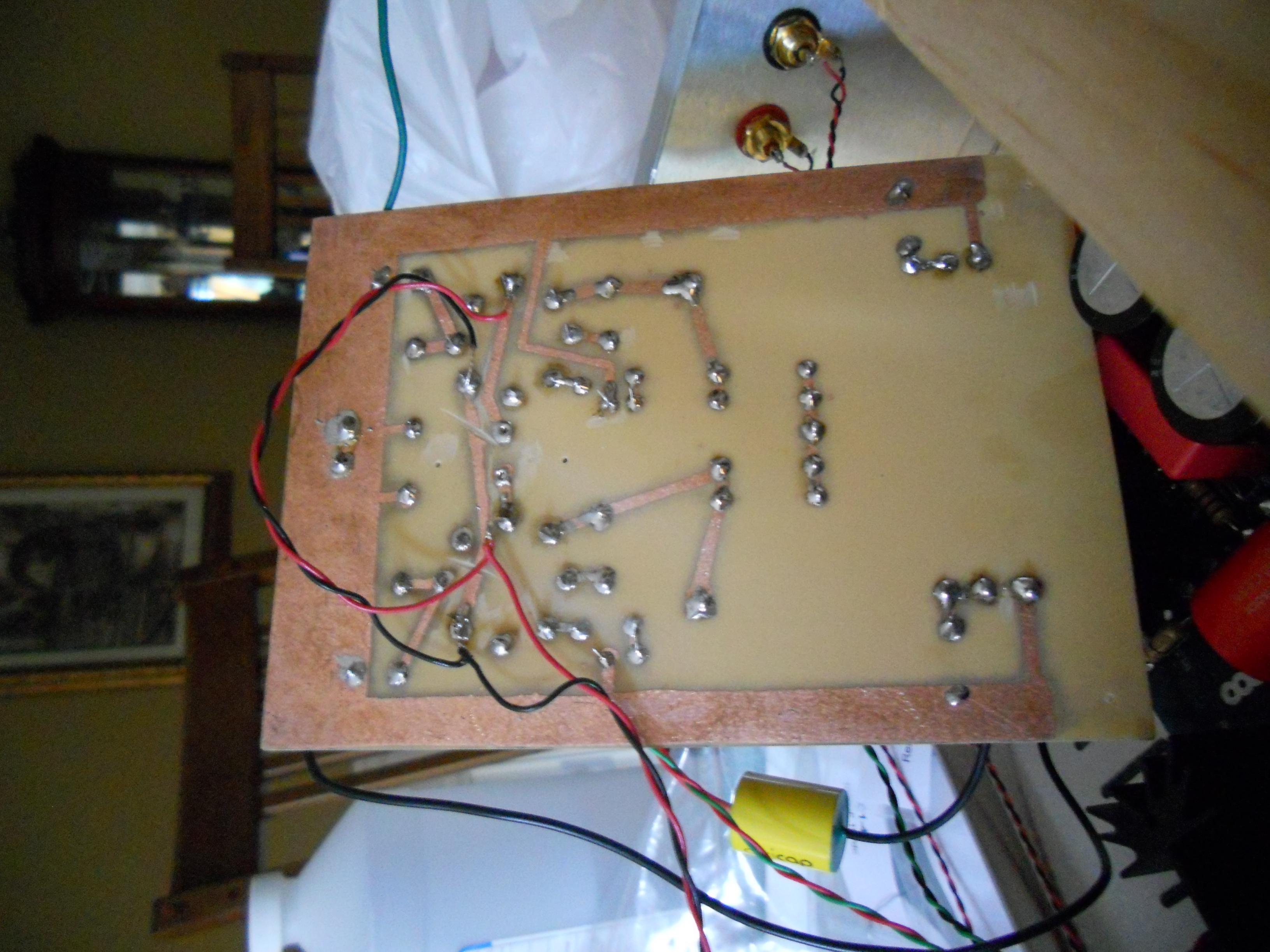

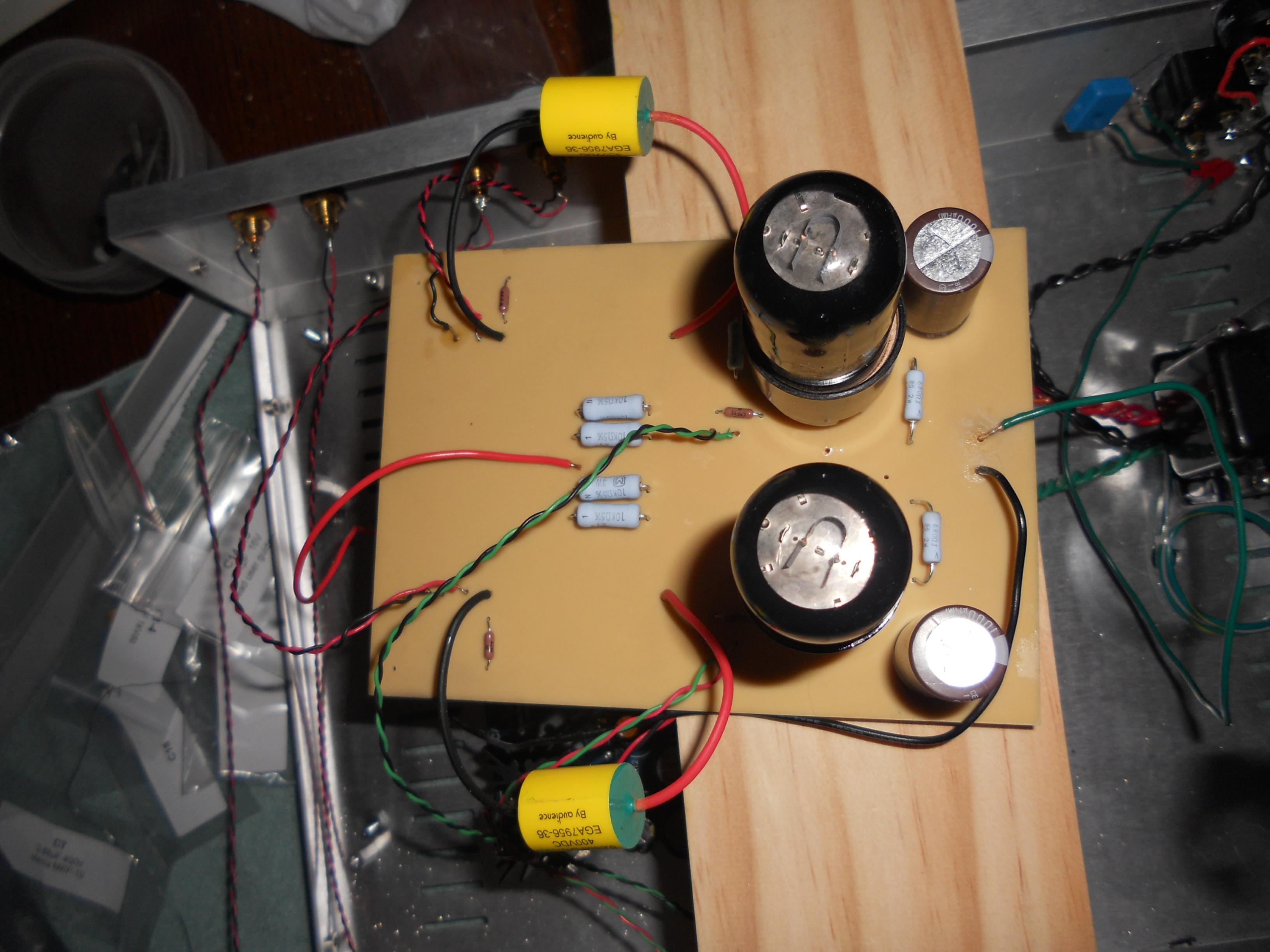

Its either you got something traced totally wrong regarding the audio schematic on PCB or you get a strong oscillation, which sounds like hum if high amplitude. Maybe that is why it comes and goes. In an open loop pre with a reg you can either get it from the interaction with the reg, or with the signal run and the grid. Are there 1K grid stoppers tightly soldered to the grid pins? I suggest you hard wire it.
should I try and increase the grid stopper value to 1.5K or 2K maybe?
I triple checked the board traces and they are correct...the 1K grid stoppers are very close to the pin 5 on both channels.
If you got one, set it to AC input and check the B+ line at 5mV and 50uSec. If it ain't a horizontal line, but its a sine or a thick mess, its power line oscillation. If you have not got a scope its difficult to know. I would start by twisting B+ GND wires. Are the ''triodizing'' resistors tight for pins 3,4? Larger grid resistors I doubt they would change something.

I cant believe that 2 different PSU's I use on 2 other amps I have are that noisy. It must be something in the layout of my PCB.
