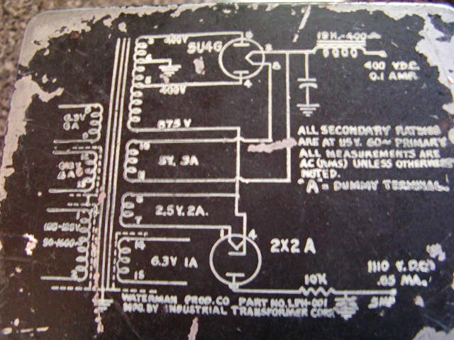

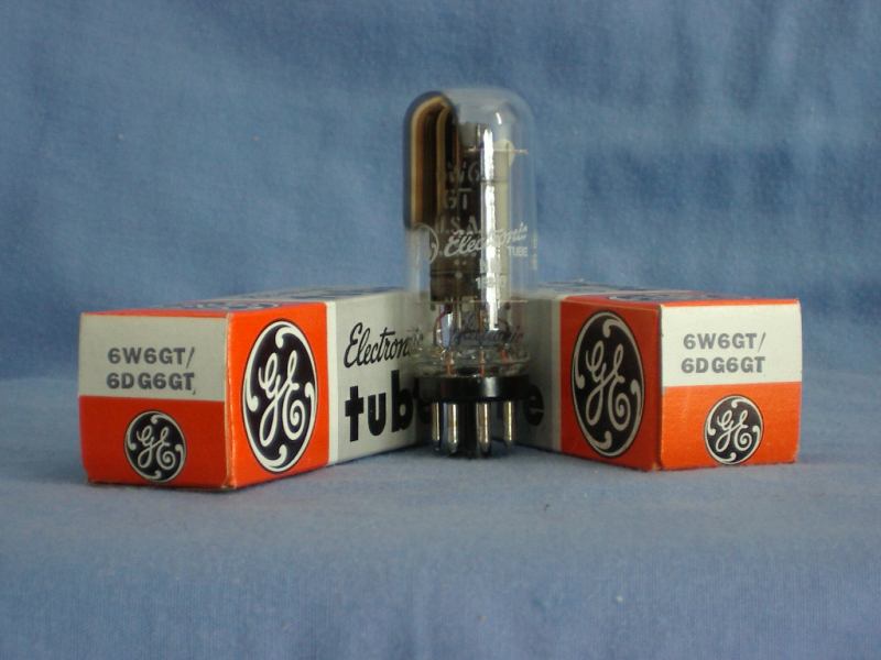

I have never had 6W6s in my hands. For sure it needs to see 200V max plate voltage and has a much stronger heater. What kind of power transformer is handy for you? So we can speculate some values.
I have a Thordarson T22T34 which is a 400-0-400 unknown current rating but would guess 100mA.
I also have an unknown brand which is also a 400-0-400 / .1A
Picture of unknown
Hmmm...With this transformer you don't have enough heater current for even one 6W6 at 6.3V. Again 2x400 is way too much. You would have to throw away too much energy and heat on RC to go down to 350VDC. Anyway if you get a 350V B+ somehow, you may try 12K//12K 5W each for plate load and 680R+680R in series for cathode bias for each 6W6GT.
Is this for the circuit in post #8?
How many mA for each tube?
Aha, it has enough heater current to the left. I did not look there, bcs they normally depict primaries. As for the other transformer, it has the same secondary HT, so nothing more to think.
It is for post #22. Again 22mA, I targeted. But its only speculation. I don't have 6W6GTs so to tell you more. Its up to you to verify with measurement if you gonna get 30V on cathode and circa 225V on anode (my targets for R values I gave) when you gonna put it together.

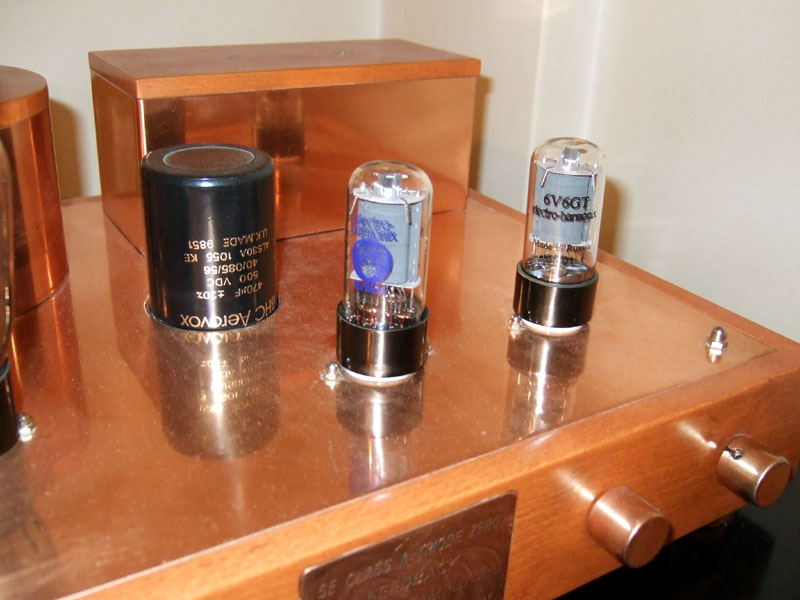

I have been asked about using new production valves in this project. The answer is: No sonic degradation by using new production with this project. I got the chance to test an EH pair. They perform flawlessly with very good clarity and coherence. Best part is that microphonics are very very low. Seems that 6V6 is a very nicely behaving type as used here, just flavor changes, and the main performance envelope is always in frame. I will see about JJ 6V6s too, given a chance.

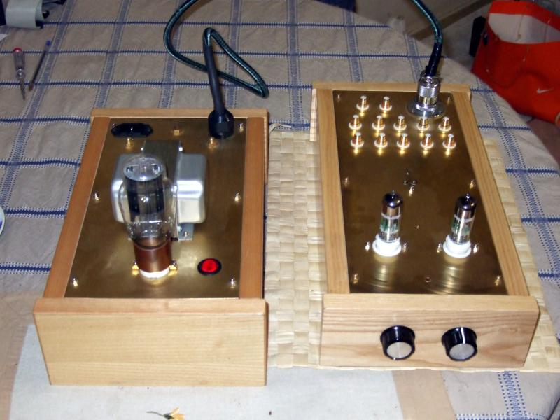

*The 12B4 line stage is shown in the attached picture. RCA NOS 12B4s, Mundorf Silver Oil Supreme coupling, ditto for cathode bypass parallel on Silmics, great hook up coax.

The two preamps are equivalent in concept with the particular 12B4 application having some more aces by using better hook up wire, Silver Oils over cathode lytics, separated PSU box, and a stepped attenuator.
Hi salas,
Really elegant build - both preamps.
Have you tried a 100uF cathode bypass value for the 6V6?
BTW, with the ‘umbillical’ you use in your 12b4 preamp, is the connection to the psu removable or is it ‘captive’?
Thank you,
fred

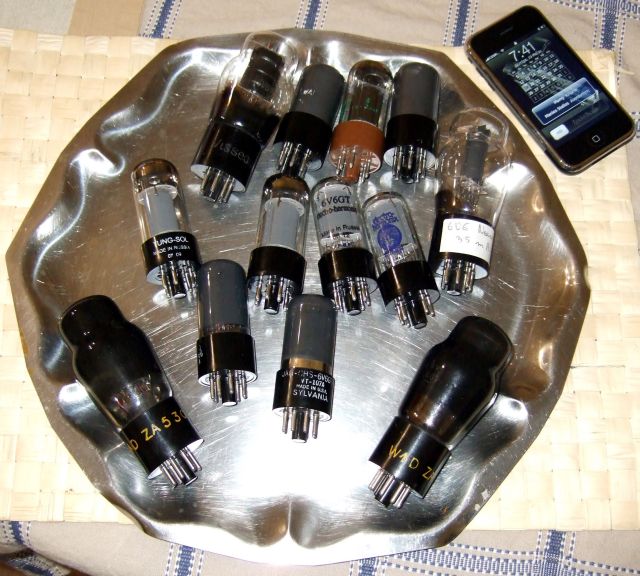

It was high time for a 6V6 tube comparison.
Two people, 6 tube pairs.
SPL constant, notes taken. Standard music. Standard listening positions.
Disclaimer: The following listening impressions are subjective, based on performances exclusive for the line stage described in this thread.
Tubes:
1. MOV / OSRAM 6V6G Coke bottle:
Melodic mid tone (euphonic coloration), soft bass, open but not harsh highs. A 'cozy' sound, not particularly clean. Microphonic enough.
2. Visseaux 6V6G Coke bottle:
Still melodic enough but noticeably cleaner than the MOV, good balance across the spectrum, firm but not big enough bass. Good microphonics for an ST bottle.
3. Sylvania 6V6GT VT107A:
Nice mid balance, close to neutral. Good bass. Soft, not open enough HF. Good microphonics.
4. Philips Miniwatt 6V6GT:
Great balance. Only a hint of mid tone romance. Clean and open but never harsh. Very good bass and microphonics.
5. electro-harmonix 6V6GT:
Open, clean, lean enough balance, deep bass not enough. Some hardness in the presence range. Not bad, catchy sound. Excellent microphonics.
6. Tungsol reissue 6V6GT:
Spot on neutrality. Proportionate sound, excellent analysis. No highlights, no harshness. Excellent microphonics.
Conclusions:
No bad 6V6 in the above list. Two stand outs: For NOS is the Miniwatt, for new is the Tungsol. The Miniwatt adds just a bit of euphonic expression in vocals and other midtones, posing as correct , clean and big, but alluring too. But the Tungsol reissue is the monitor tube. It has all the stuff needed and makes no statements.
Regards to all tubephiles
Salas.

Thank you.
- Not lower than 220 uF. Haven't tried 100 uF.
- It is removable. One box houses the tube rectifier, pi CLC, fillament supply. Main linestage box houses the Mosfet Maida regulator too.
