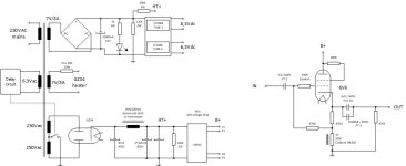

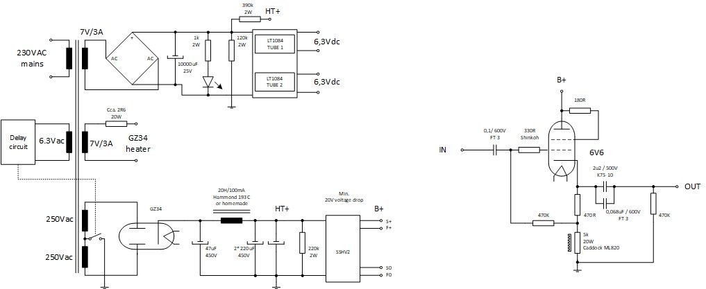

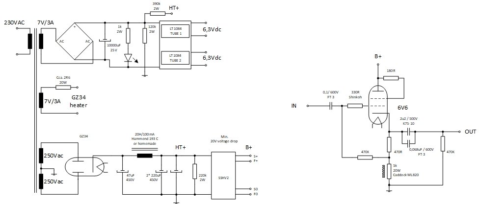

6V6 line preamp

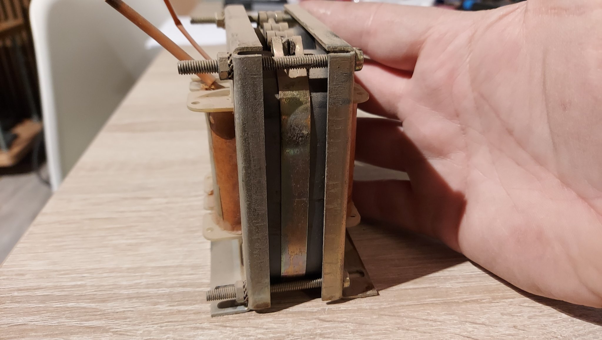

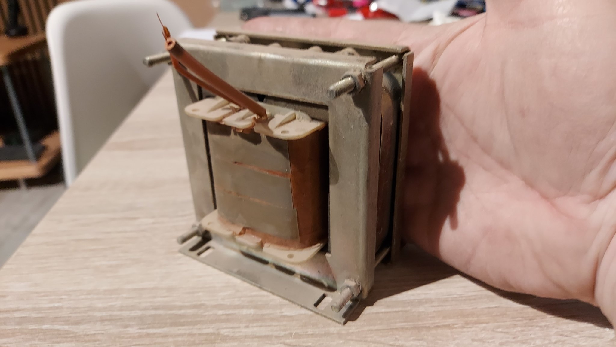

Look what i have found.... dc resistance is something around 150 ohms.... kill me if i know what inductance... havebto measure tue diameternor the wire tonsee if it will fit the bill for current....
If not, this can be removed and wound again...
I used this one on my ex 12B4A preamp 15-20 years ago....
Also i was searching in my "junk" boxes and found one valvo gz34 and two telefunken gz34
.. so gz34 it is.....

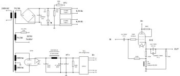

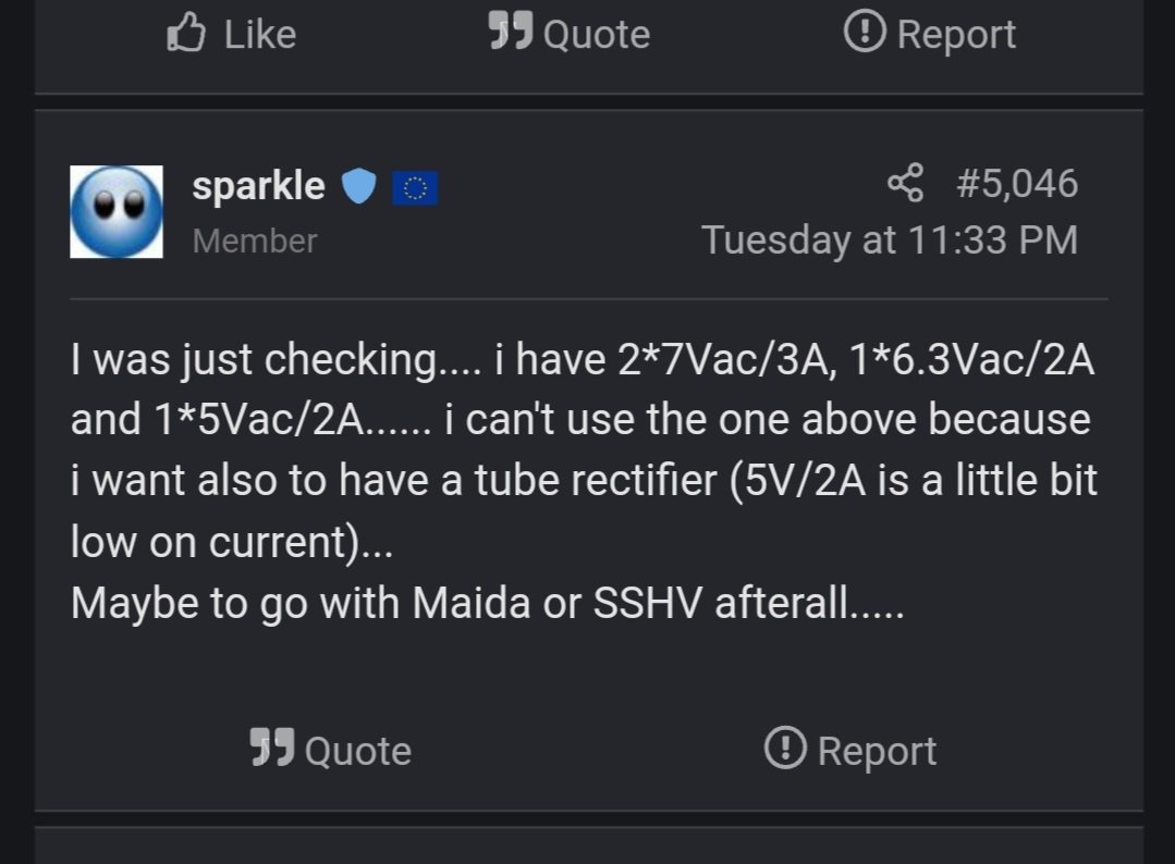

2 time 7V/3A, 1 time 6.3V/2A and one time 5V/2A...... you are right - i completely forgot about that - will have to try 5VAC FIRST - before burning some resistors without reason !!... thank you
P.s..... on second thought - you almost got me 🙂 🙂 🙂 - GZ34 will be to much for my 5V/2A coil... i need to use 3A at least.... so it stays like on sch above.....
