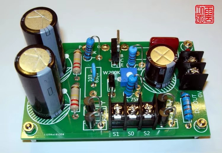

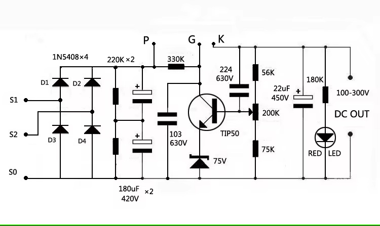

i just found some high voltage regulator board on Ali - will post a sch (hope it is allowed)....
description says input voltage can be around 260VAC ( i have 250)... if center tap is used (250-0-250) then D3 and D4 should be removed.

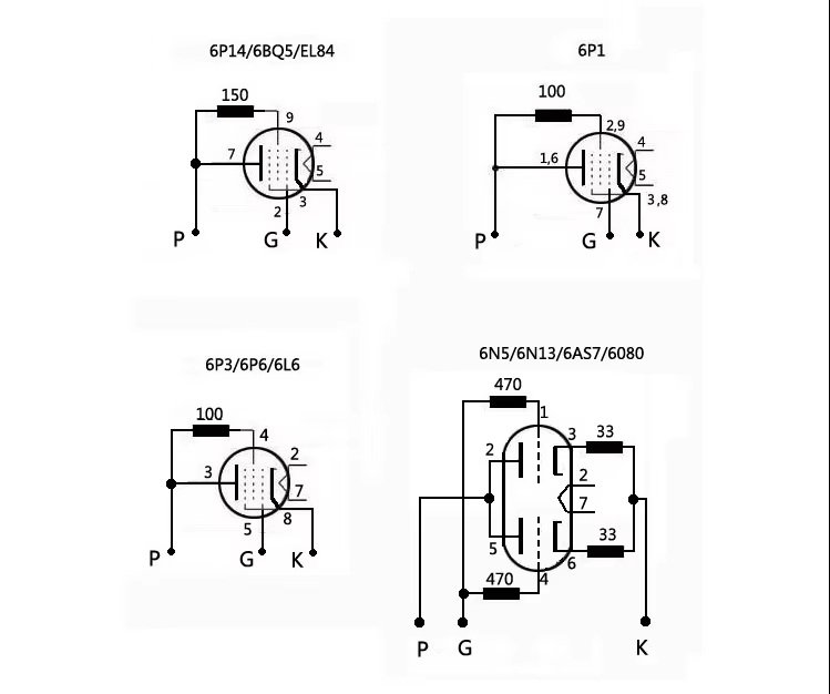

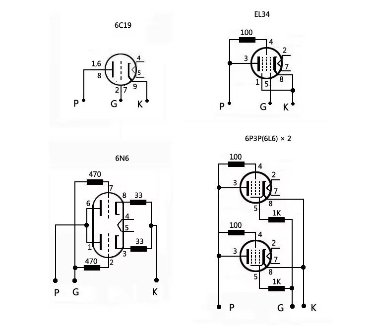

Also theny claim output voltage goes from 100-300VDC which is o.k.-ish too..... also multpile choices for the tube (or SS) in series...
Might go for that one..... pcb is professionaly made, looks good imho... i have some russian 6P3S-EV tubes i could use there...

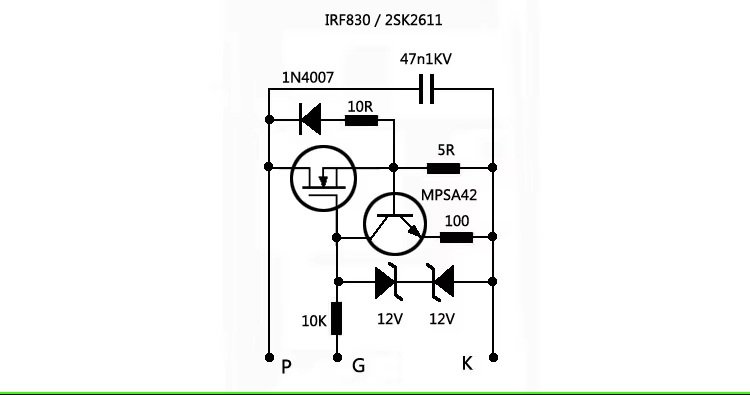

Hard to vouch for. Ask Tea-Bag if he has an SSHV-kit for sale. It will give you optimum results but not the coolest. 0C3 is the coolest
Tube hv-regs generally works but are hard to make speedy enough for audio. Many have tried, I don't see that many success stories. Interesting subject in its own right though.

I already got pcb for SSHV2 - mannaged to find one in Poland..... 🙂 🙂
