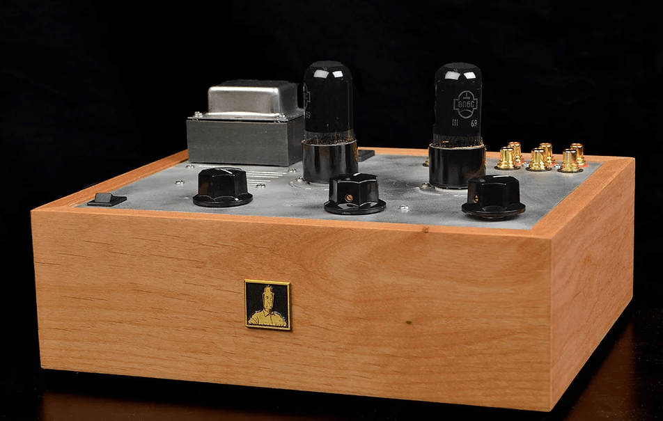

Don't think I coud reliably hear the difference between ground and ground lift for the - of the heater. But I did feel after I first switched to ground...noisier. Anyway now it is grounded to the heater lift just on the node where the two 100ohm resistors are joined (because that is for ac really to create an artificial null point) I can barely hear the faint hum. So I'm happy since it is quieter than the first one I built.

Listening tonight to a live performance of a Baroque orchestra playing Biber, Fux, Bach, etc. Just lovely. Switching back to the Aikido, it's also lovely, very relaxed and "big" and musical, but also---what?---a bit more romantic. This preamp has a more immediate and punchy sound. Not a trace of sonic fatigue or strain.
Listen to them again make sure you don't like them and they will go fast when listed on ebay. Very tightly structured special tubes can come across subjectively dry for audio fun sometimes.An update on the Bendix 5992s. You know what? Save your money. ;-) The vintage Russian 6n6c's are cleaner, livelier, sweeter. Much more fun.
