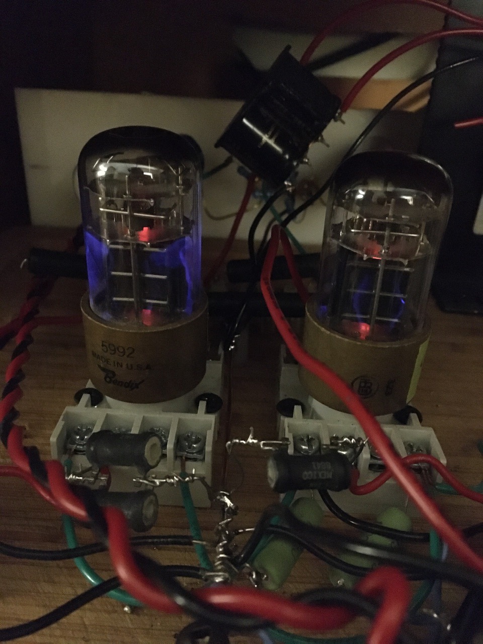

The Bendix 5992s arrived today. They sound pretty much like I expected, based on my experience with other Bendix tubes. Very clean and smooth, with a lot of air around the instruments and more fine detail revealed.

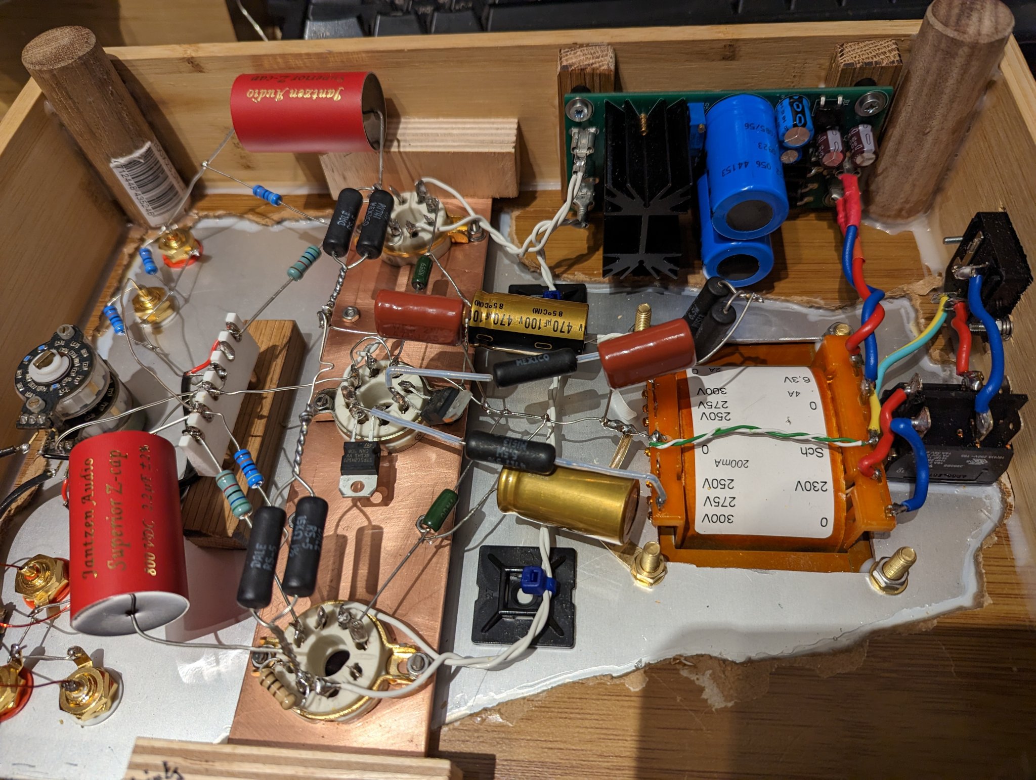

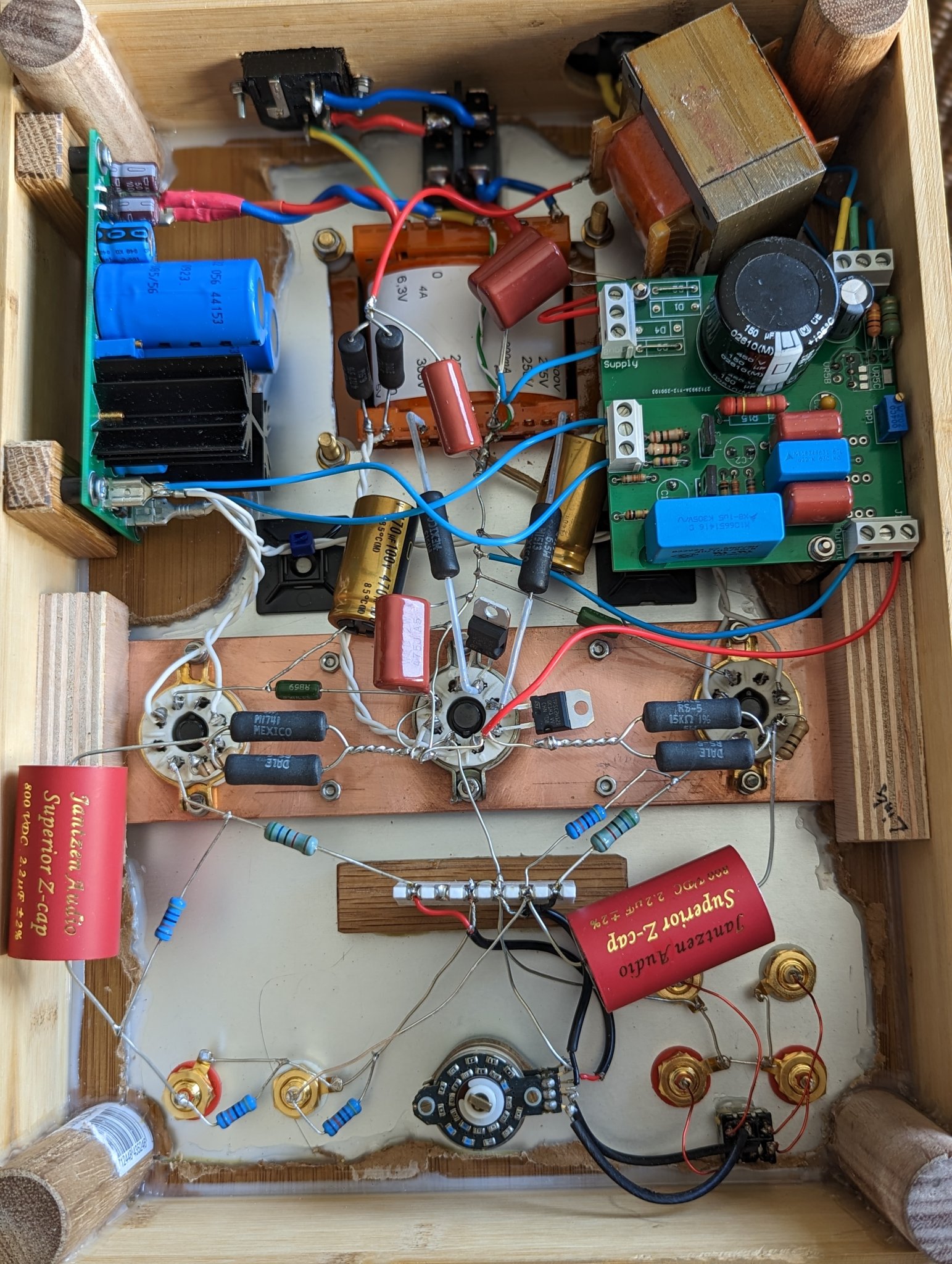

I'm pretty much done on the breadboard. I ordered a case for the toroid and will see if I can get the power supply and circuit on a 17 x 10 chassis without noise issues. If it's still a problem I'll off-board the raw DC supplies.
One last question--is it worth switching to Cree Schottkys?

SiC Schottky diodes have excellent specs. Worth a try I guess. There are also dual diode TO-247 parts like the C6D16065D.
Remember, in a four diodes full bridge rectifier each diode sees AC peak as reverse. In other words secondary RMS x 1.414.
In a two diodes and center tap scheme each diode sees AC peak to peak as reverse. In other words secondary RMS x 2.828.

You may go for 1200 PIV diodes in case it will be needed for higher rail center tap future builds, but for this one even a 300 VAC secondary will only give 424 V PIV to them in a four diode bridge like yours.
What is the spec of your transformer's HV line secondary?

My toroid is 275-0-275, so 600V Schottky would be enough? They are much cheaper. ;-)

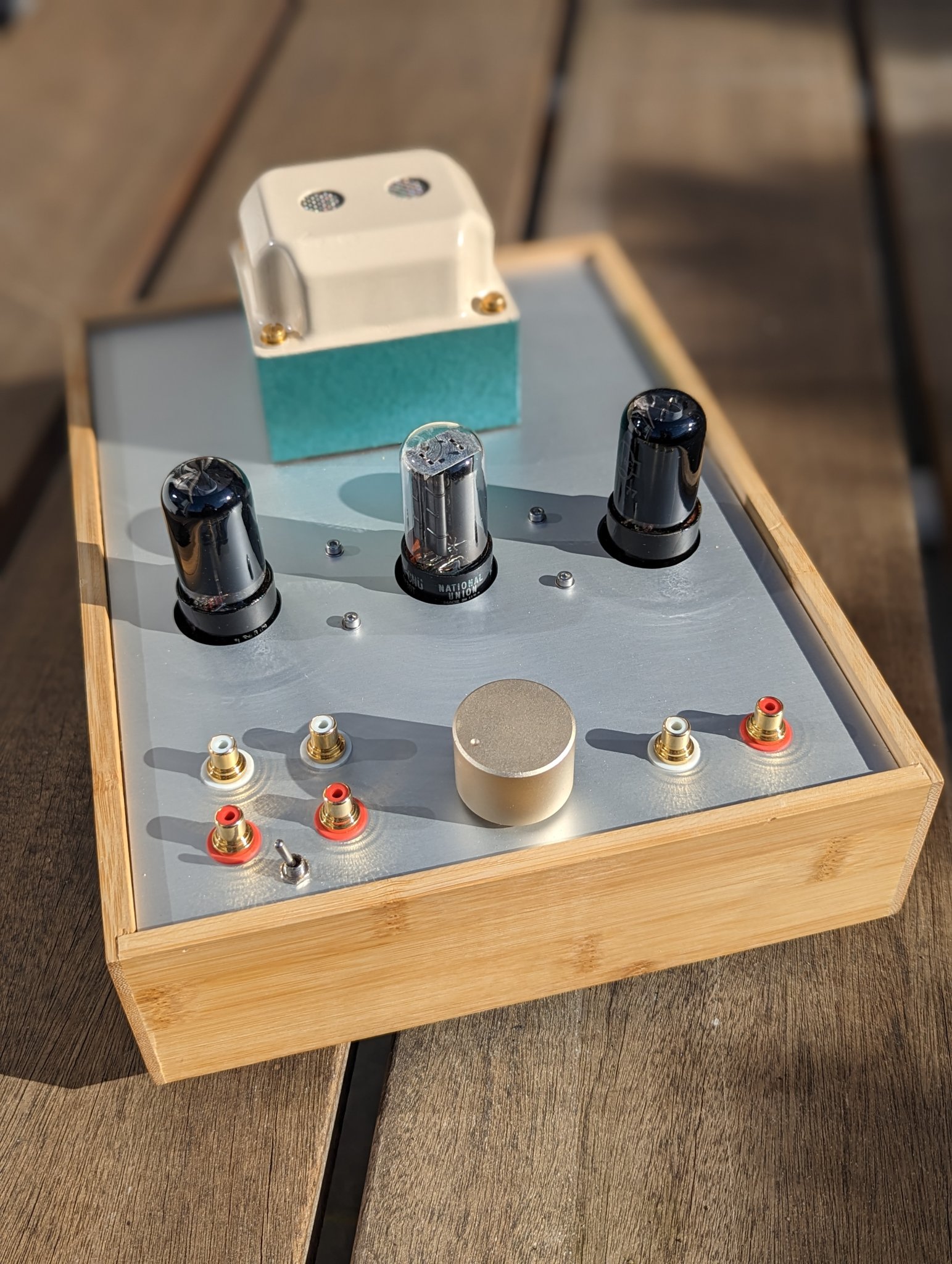

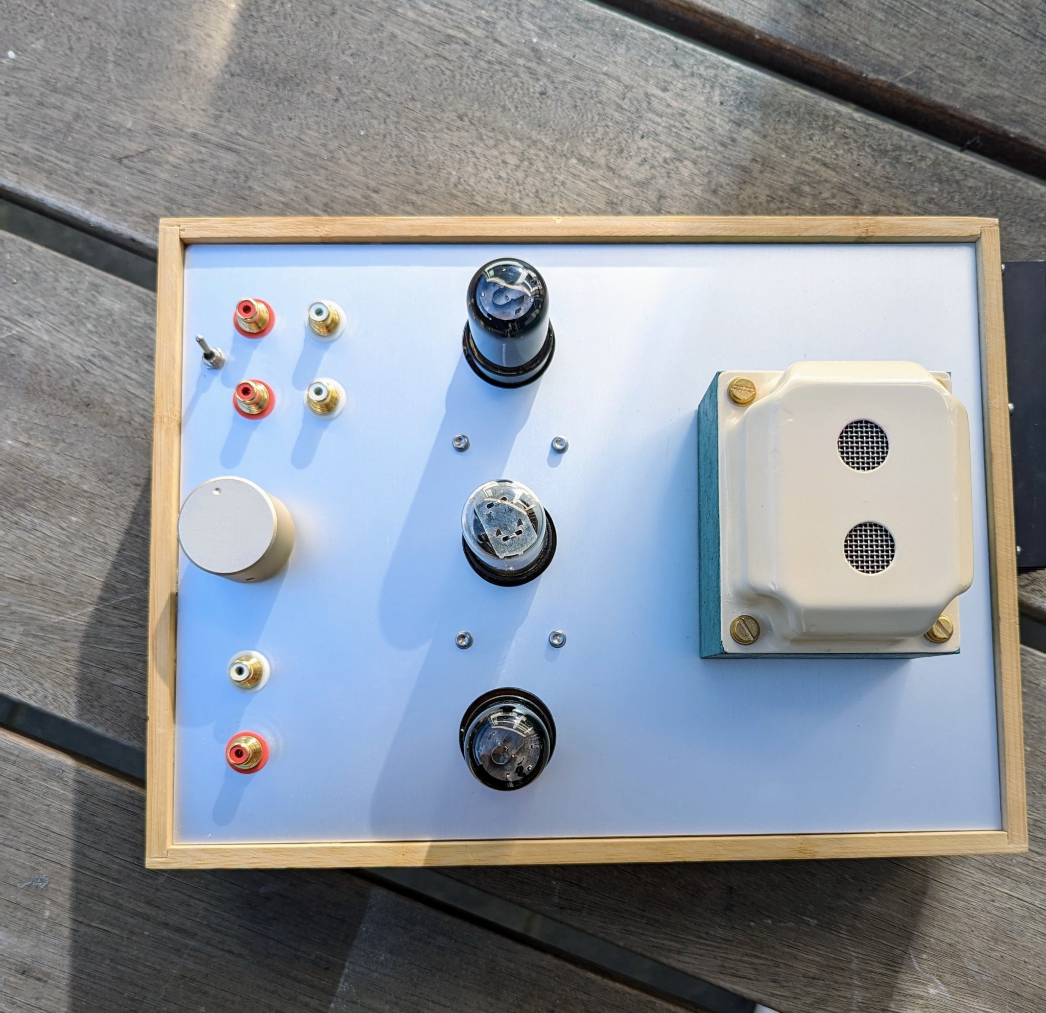

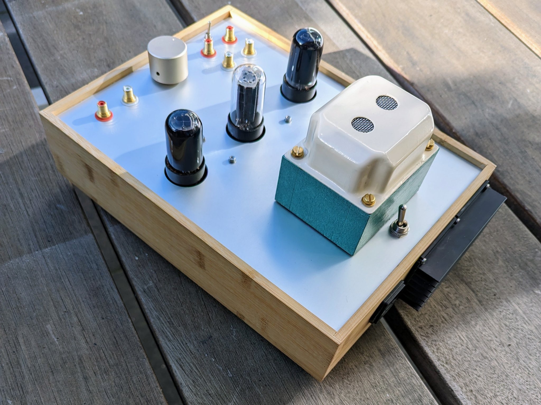

Finished! Put into service last night. What can I say? The Salas 6v6 preamp makes me happy. 300V b+. 150 on plate. 8 on cathode.
It turned out really well. Congratulations. What type rectifier is that beautiful National Union NOS? GZ34? How high raw DC it achieves from the 300VAC tap? The 6V6s should be 70's Soviet 6Π6C. Rich tone tubes, only not all samples proved long lasting. I had one gone noisy early, same happened to a couple of friends. But they used to be offered very cheaply online and we had enough good samples for replacements.
Thanks! 5Y3.
My reg only goes up to 311 it seems. So I thought I'll pop in the 5Y3 to lower it. And then I thought...let me see if I can get the heatsink warm (I can't) by dialling down to 300vdc.
They are Soviet made in 77. Can't find my Tungsol (Re-Issue Russians Really) that I used in the first one. Would be nice to compare.
With the 5y3 something like 330. With the GZ34 370 or so. But there is some resistance 47R each leg pin 4 and 6. Choke is 65R. And I made a ct with 47 ohm on the 5VAC supply to tap the b+ start from (Just because I like to do it)How high raw DC it achieves from the 300VAC tap?
