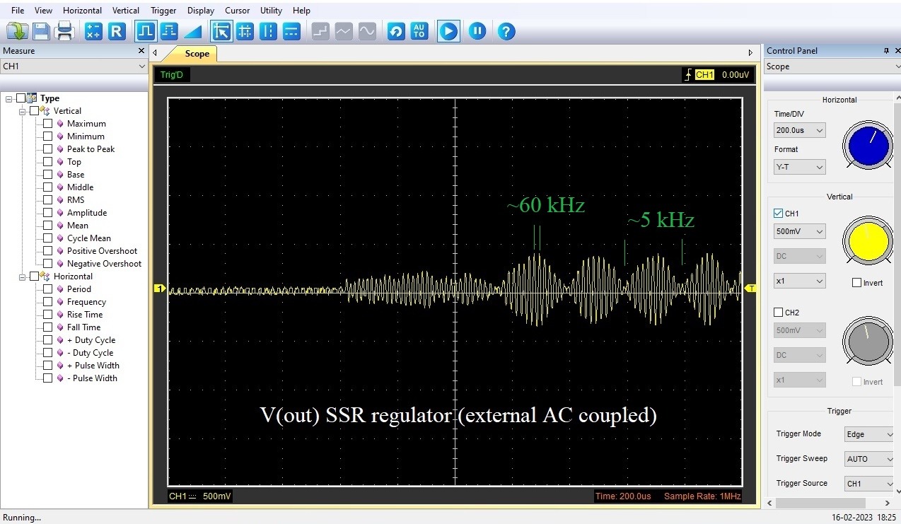

See if and what kind of noise is in the B+ line before and after that series reg. A 20MHz bandwidth limited scope will help you do that.

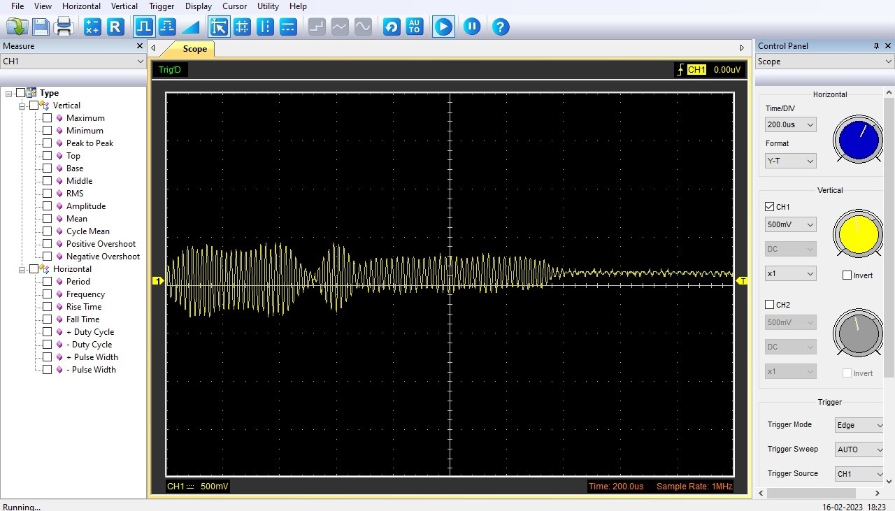

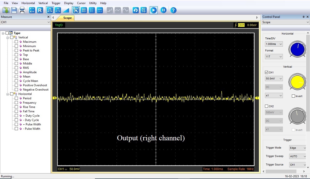

I carry some measurements after the regulator, and at the output channel. I hope I took them right.
Particularly in the former there seems to be a periodic frequency alternation (as with wave beats?). I don't know how to interpret this though...
Looks like the regulator oscillates. Stable is a continuous featureless line as a goal. The channel output looks noisy for 50mV vertical. Random noise, that's the hiss.

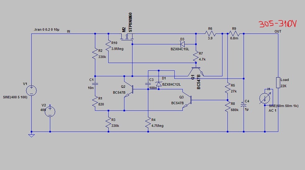

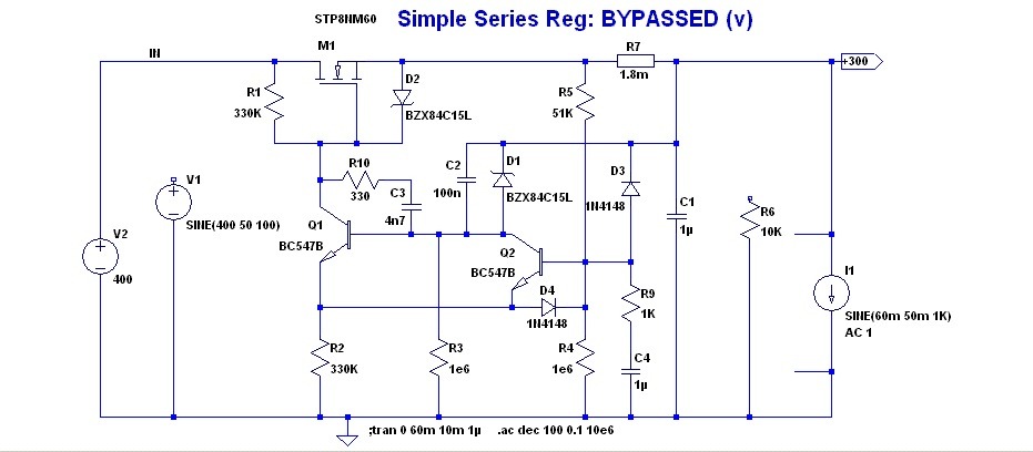

In fact just replacing the regulator with a plain R-C filter (1k-220uF) the preamp is silent. What was wrong with the SSR suggested by Elvee? I followed his schematic, I changed only the Zd (I had that value) and the lower resistor network...
I don't know the inner workings of his circuit. I could try guess but better not since the author is a reachable member. You let him know and he probably has a solution.

Yes, it's just as you say. Being not me the creator of that circuit I don't know actually what's wrong.

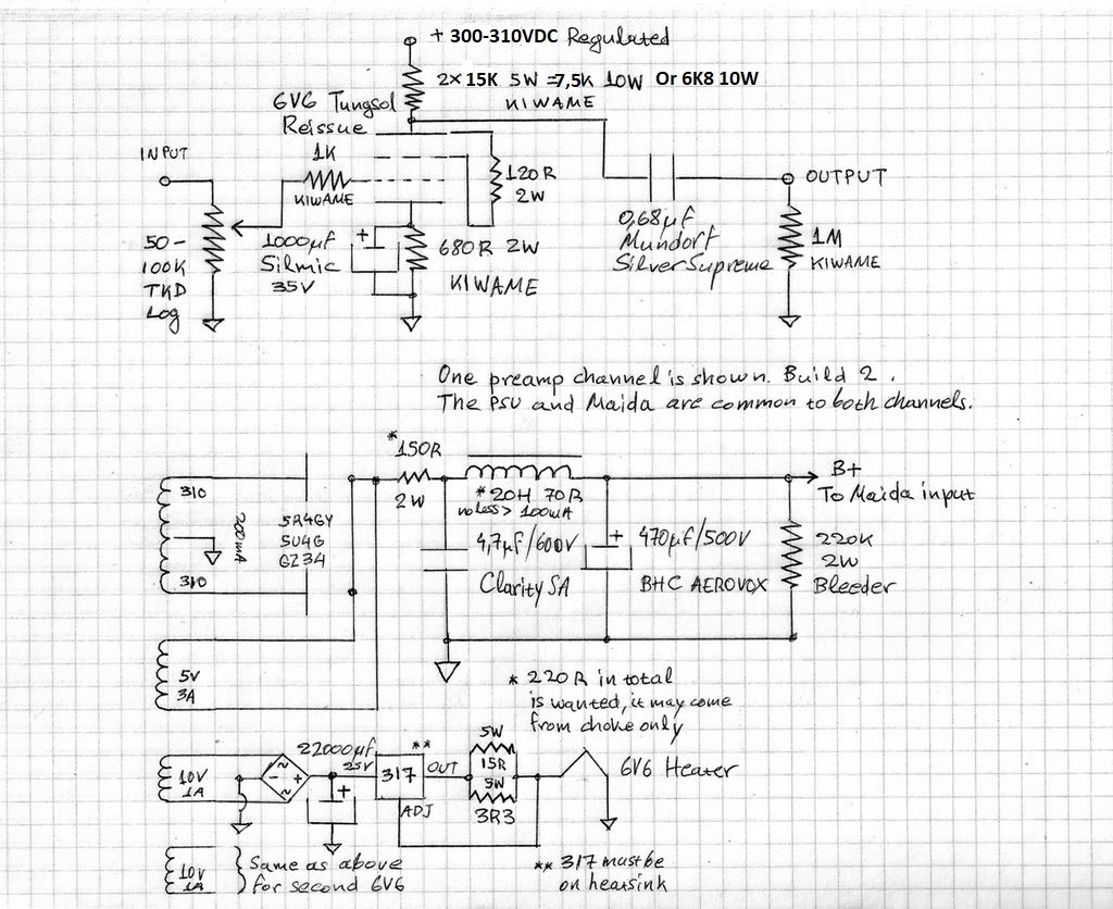

Waiting for Elvee's reply meantime, since I have Maida populated PCB set in a drawer could be fine to re-use it in the preamp?
Maida has been applied before in the 6V6 preamp with success. Mosfet Maida version it was. Try it since you have it, why not. Compare the sound and background noise to your silent enough simple RC filter solution too.

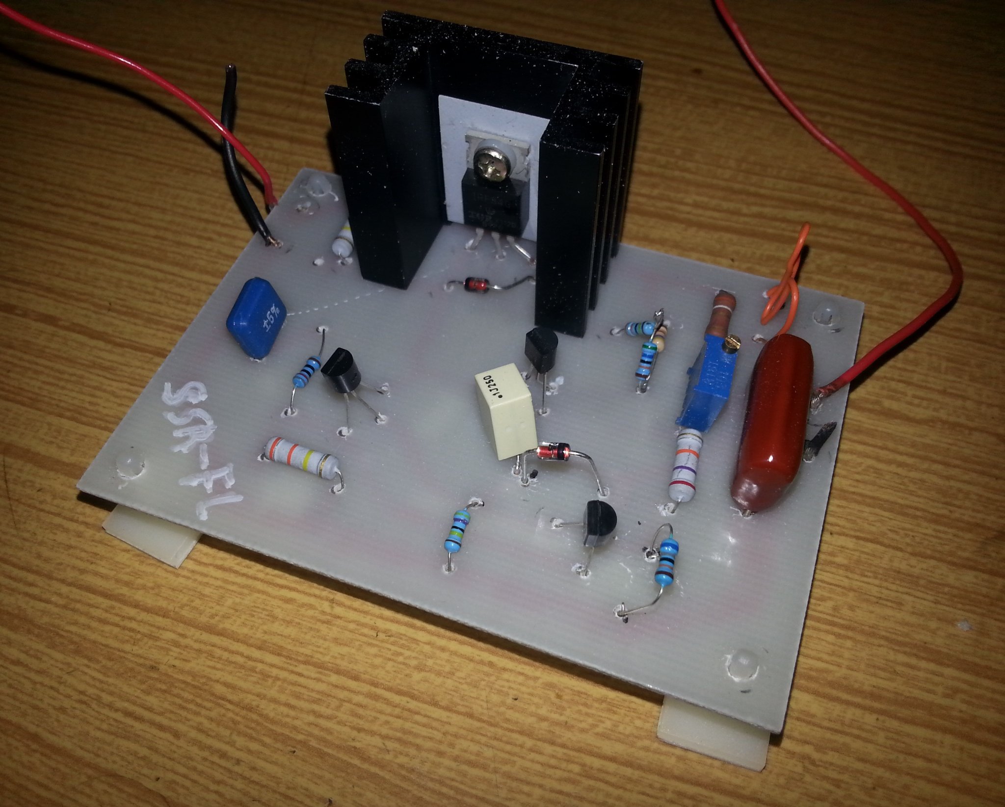

By the way how much headroom you have for regs? Vin-Vout I mean. Also, got a picture of your build? Lit up AZ1 rectifier is nice to look at especially if mesh plate.

Ok gladly, as soon as I post the picture although is not fully completed (it lacks the 3P4T rotary switch to be wired and assembled).

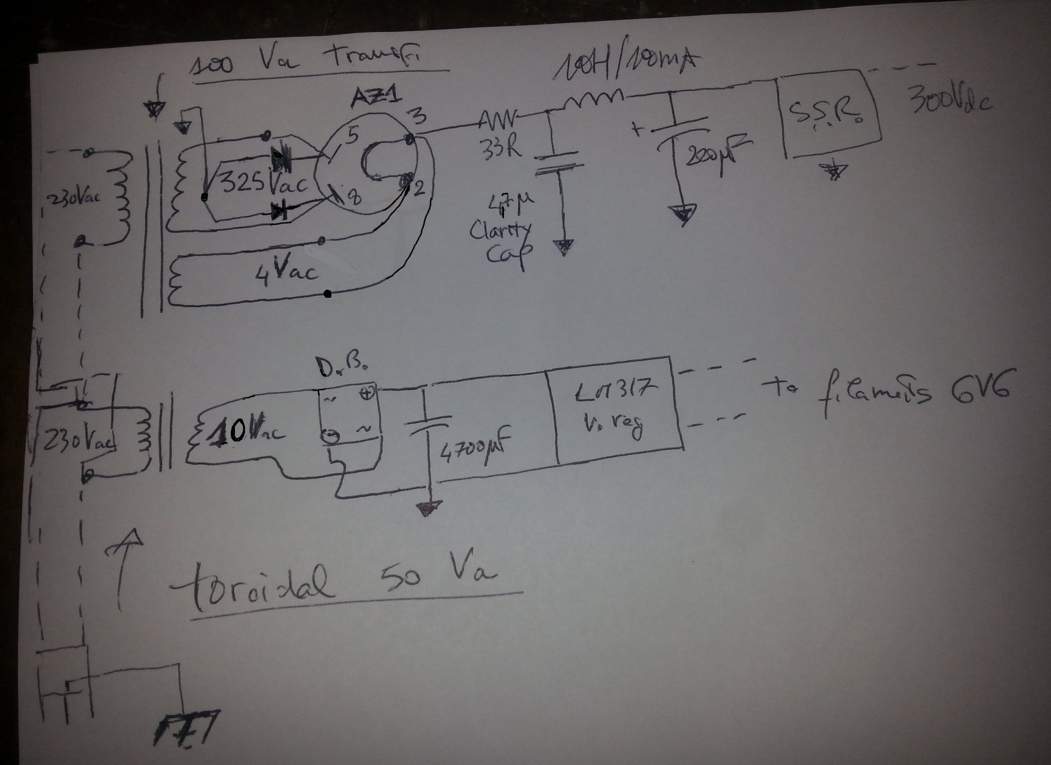

Can you show the modified schematic, and post a picture of the physical build?Hi Salas, you are right. Beyond other hypothesis I had this suspect me too, and you confirmed.
This regulator has been tried by a number of members, and is normally not very demanding
