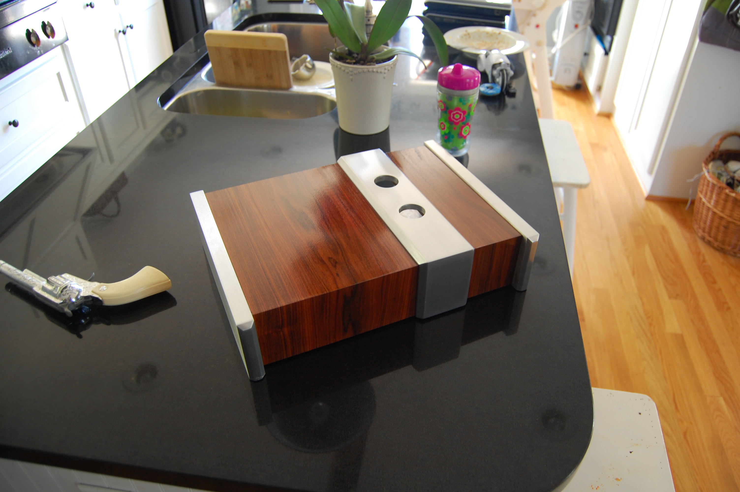

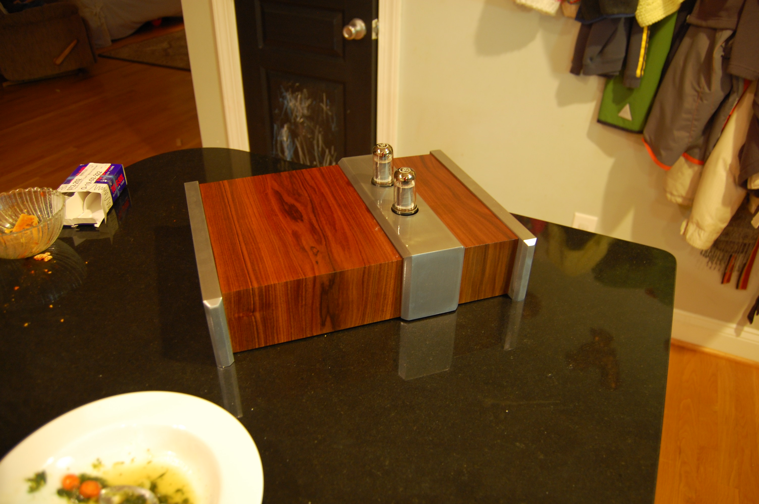

Hopefully the 6v6 will be occupying this case today or tomorrow. I always finish the amps and never the enclosures to contain them, so this time I worked in reverse and finished the case first.

Drill, saw, and sandpaper.
Huh? Those tools don't make a nice looking chassis. I really wish they did but they don't. LOL. Nice materials, nice design: those are the foundations of a good chassis.
ah, you forgot to mention the importance of having a few very good 'files'
and for aluminium you need a 'special' file
btw, if you want to polish aluminium, use fine wet sanding paper, but 'sand' dry, no water, then it polishes
same thing with wood, but with a bit of oil
but the shape I think is always a very difficult choice

I assume you mean a mill file for the angles. All me cases are going to look like this, so i will refine my craft. I heard chalk keeps them from getting clogged.
Saw and sand. 6061 aluminum. Sanding works great on flat surfaces, but i will try file on 45's next time. Should help keep corners crisp. Laquer or engine enamal for protection and final finish. Laqer all sides of wood go protect against warping and expansion.
