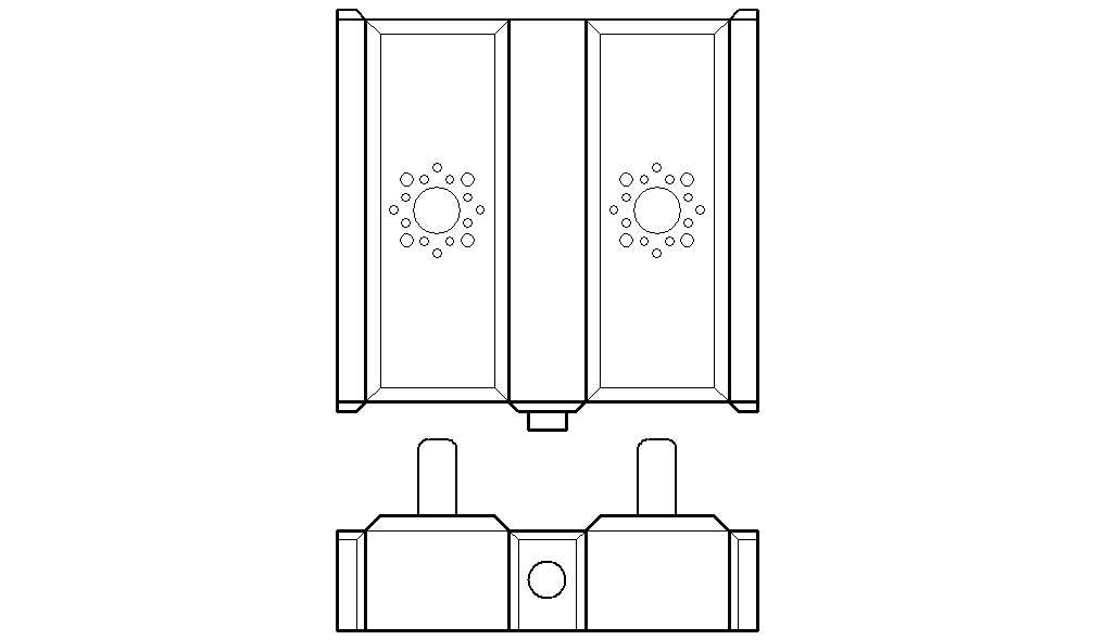

Here is pic of my boards. Not great but should work Ok. You may notice the transistors are backwards. Forgot to do the negative on the layout in my CAd program. Should still be able to sink everything OK. If you see anything that causes you to shriek, let me know. I'll be firing them up tomorrow. The cap before 317 is 2200 not 22000. My mistake in reading drawing. I have some 18000uF Pana's I will use to replace.
