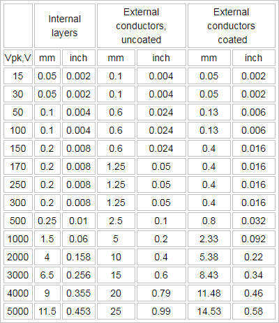

I'm paying attention to the proper clearances for high voltage, and there are ground pins between them. I'm going off of acceptable clearances for higher voltage as defined by IPC2221, 0.8mm is sufficient for up to 500 volts, which is far more than this board is likely to ever see. Maybe I'll crank it up to 1mm just to appease any nervous folk?
I plan to order a set of five of each and I'll build one of each, and send out the others to other users for testing if they look good to go.
