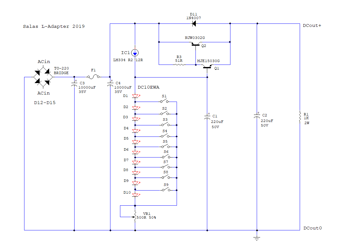

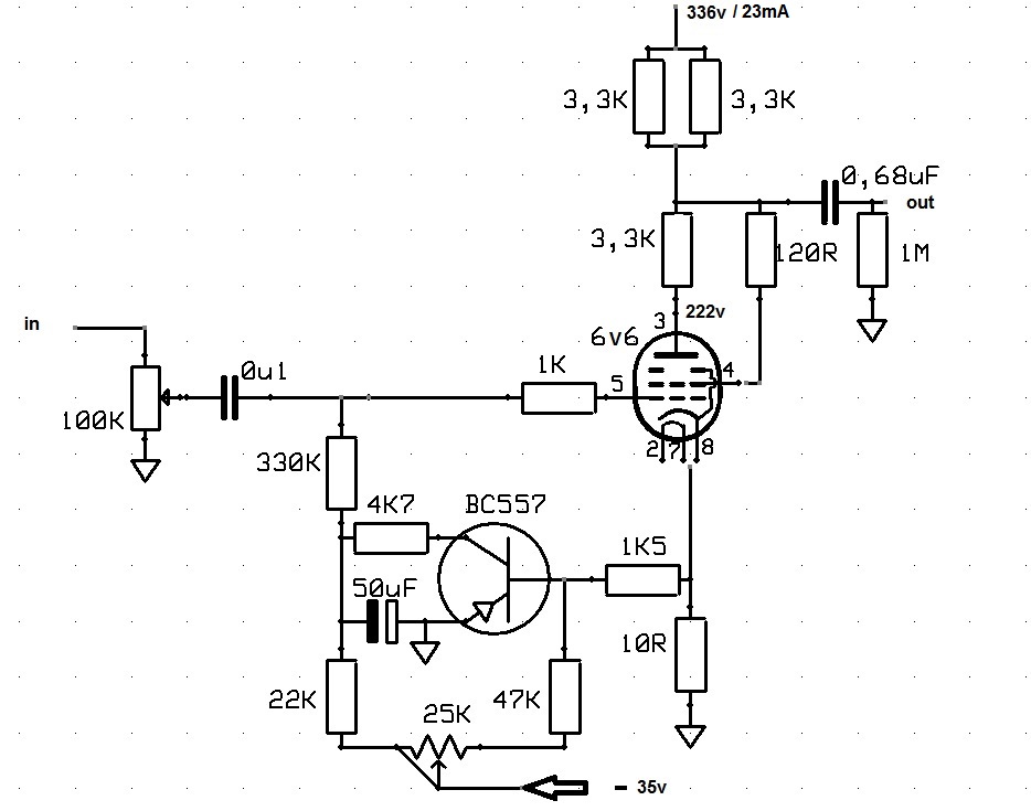

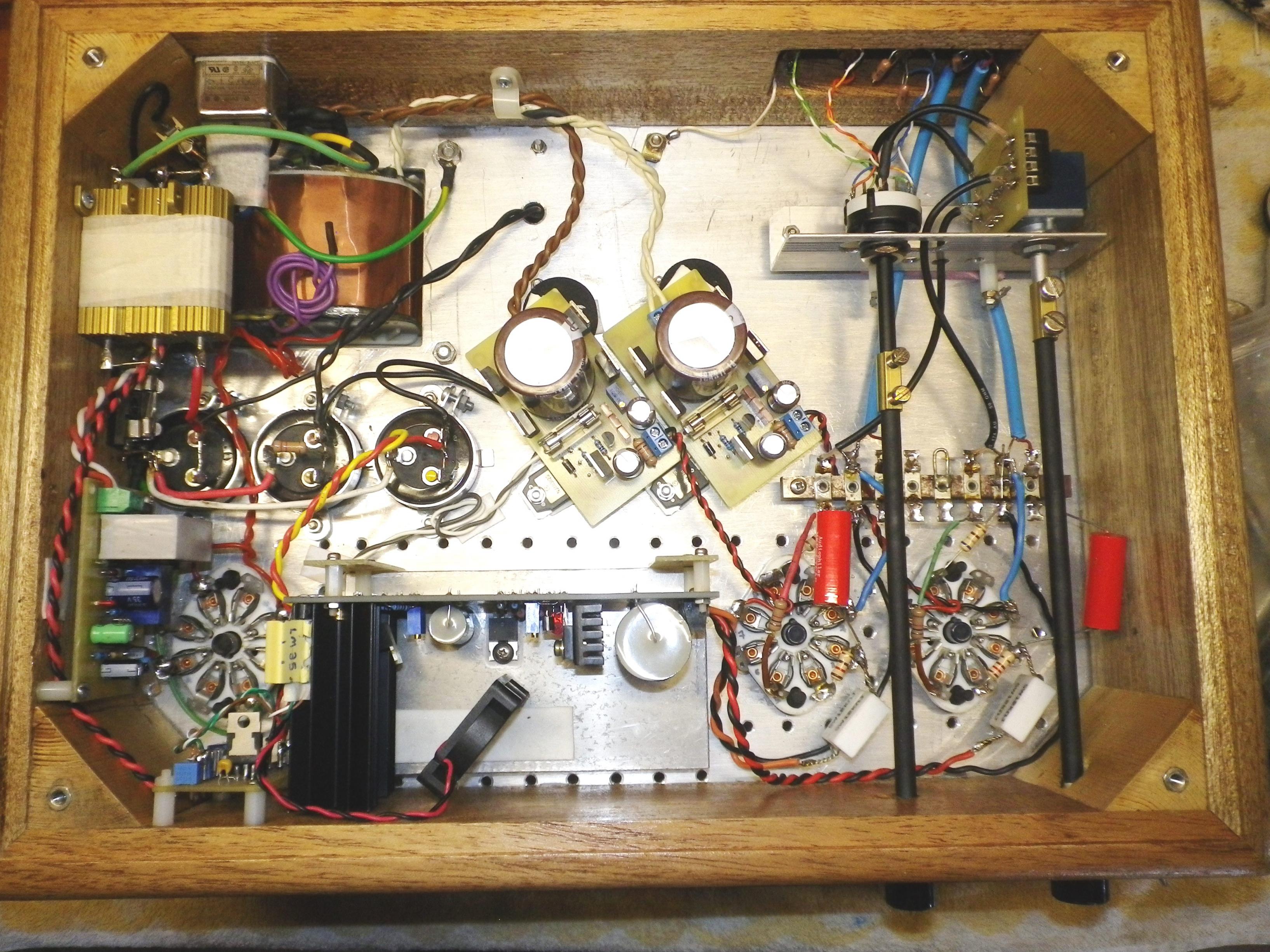

Nice video*. So your build has L-Adapters for heaters on home made boards, also planning SSHV2 for B+. A BJT bias addition in the circuit. Why, you wanted to can scan for sweet spots?
