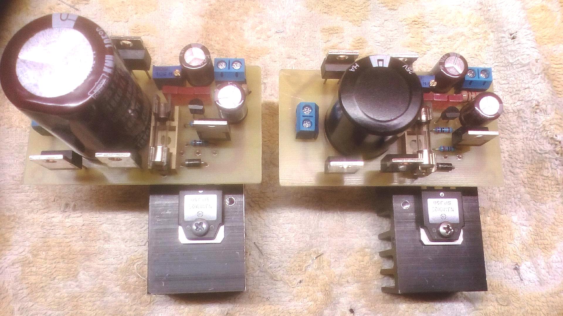

Here is my L adapter in a small edition for my filaments feed tube vs Lm317 CCS.
Big improvements in sound more bass and more details realy
Big improvements certify the very good waveform on my scope against waveform of the lm317...

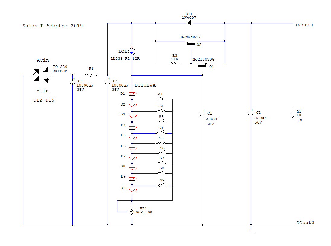

For those wanting an upgrade of heaters PSU vs the LM317 one in the original 6V6 line preamp's schematic here's the L-Adapter circuit. Its a general purpose high current PSU that can be set from very low to about 20V. But three red LEDs and the trimmer without setting jumpers are enough in this 6.3V heaters fixed voltage case. For more information, that PSU's thread link is: L-Adapter

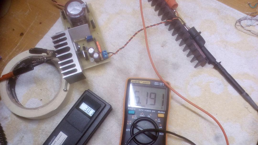

Before with Lm317 as current limit....

Τhe waveform I got with my scoppe on LM317 CCS was amount of fuzz vs very good DC line of L-adapter not a simple thicker DC line vs a thinner DC line...

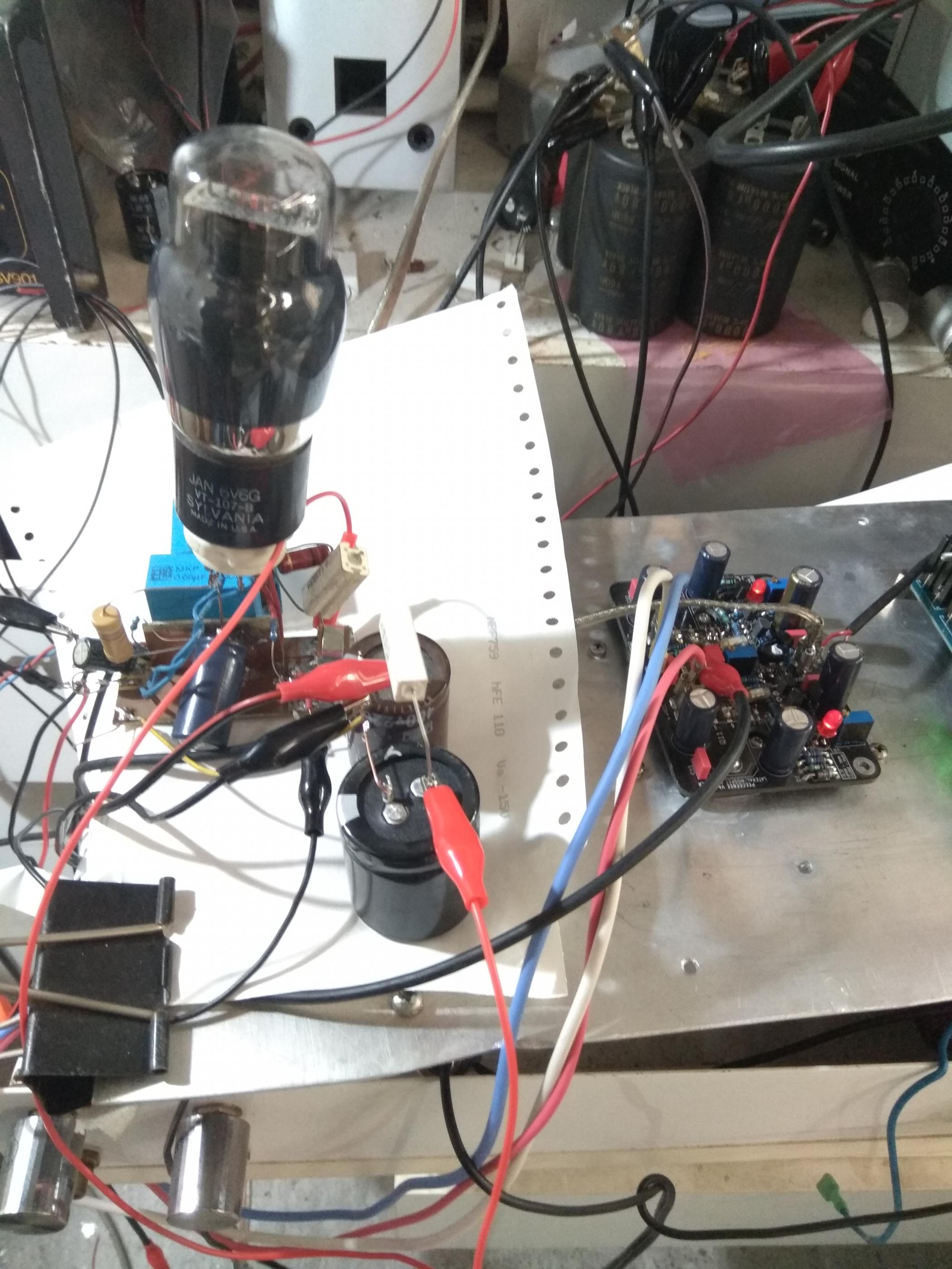

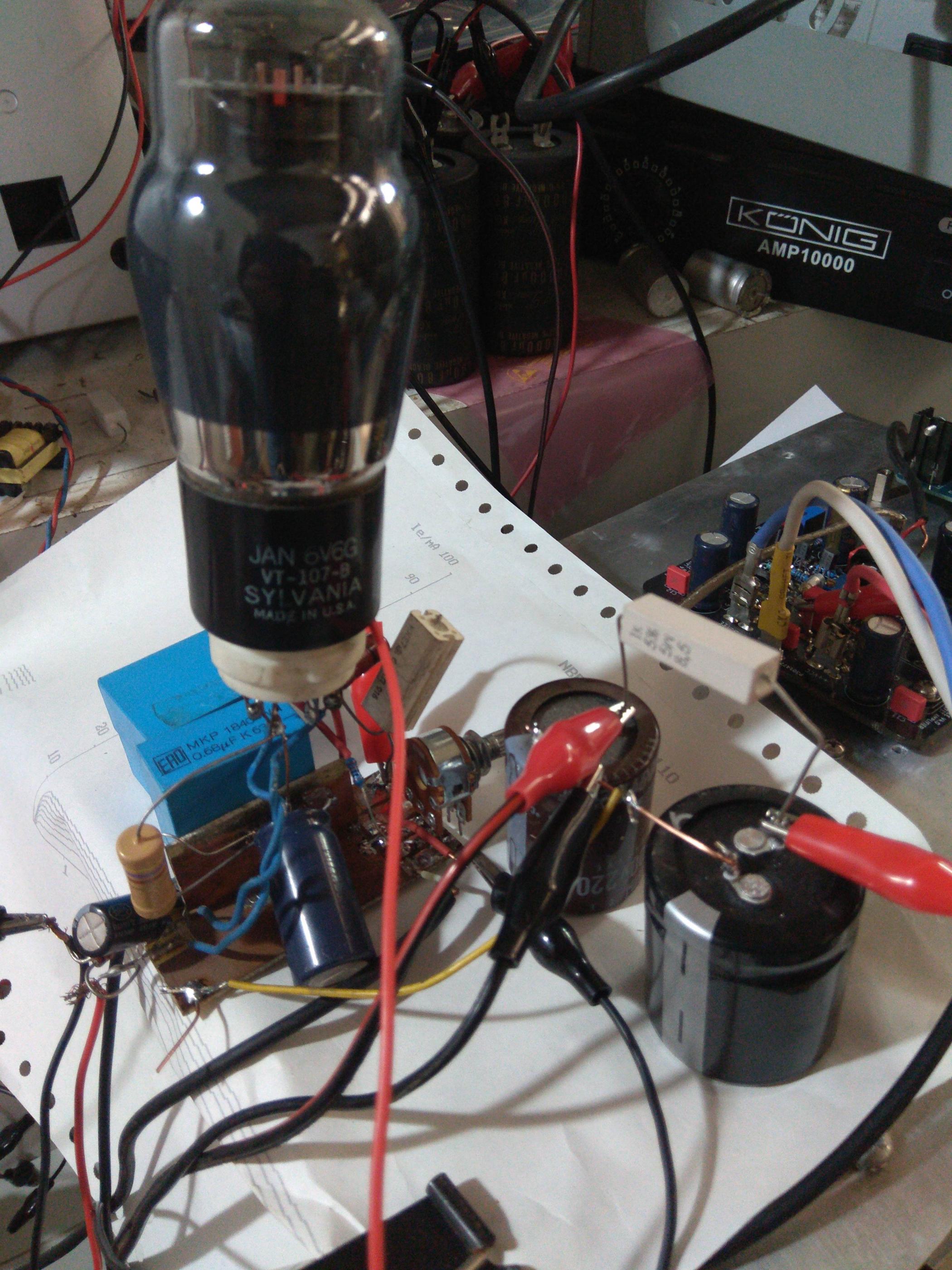

It is time to put my hand on this simple version.
Nothing special here, just to try things.
I have so many used 6v6 so why not.
No good looking but playing nicely.
