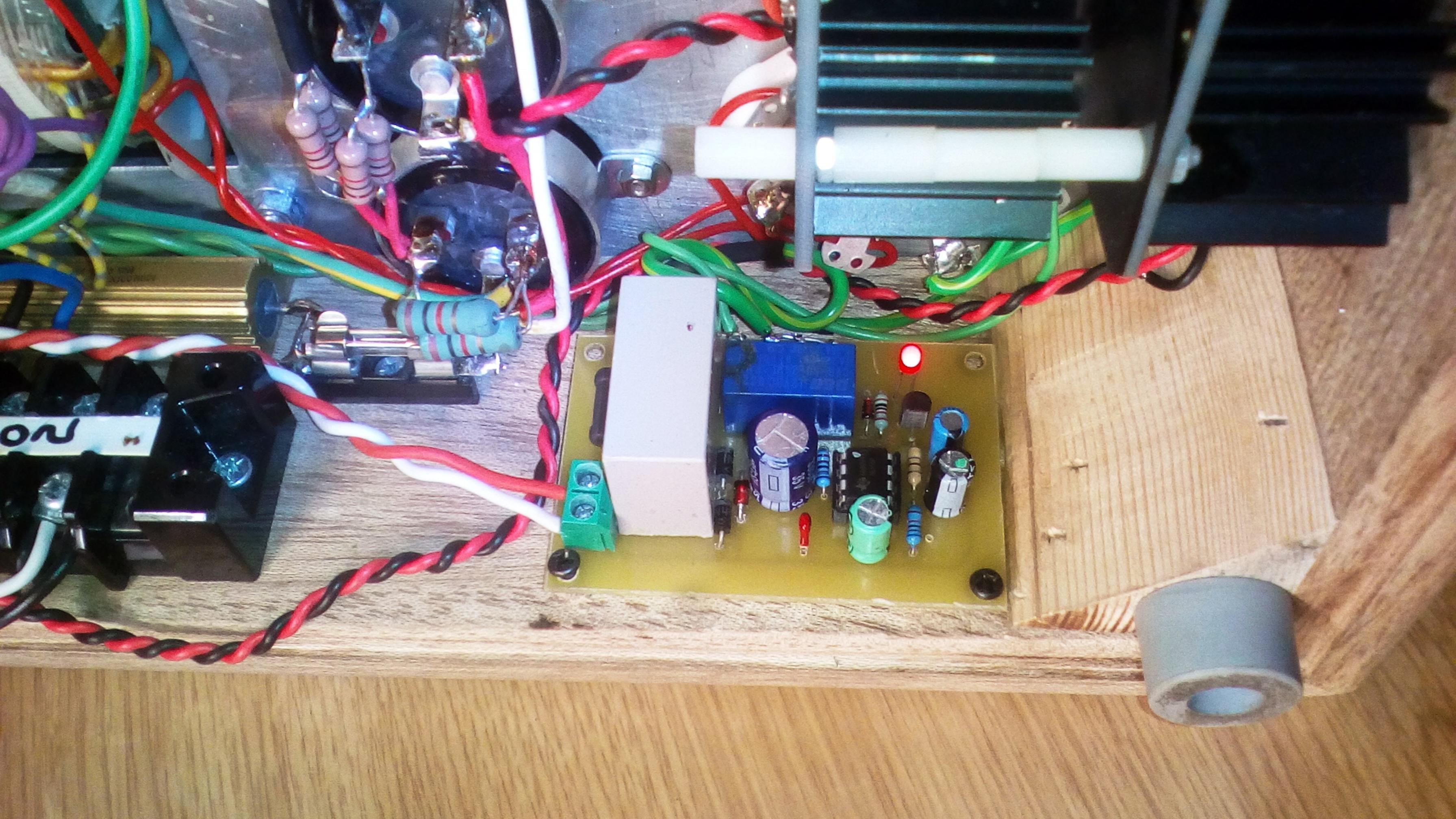

Hi
I have added a small delay circuit 555 about 70 sec delay , this circuit enable the 5V voltage of the rectifier, so the heaters of the 6V6 anticipate to make load for the SSHV regs ...this circuit is powered directly by 220 volts.
Nick as an end result, it can block up to one point the bumps ,for as long time as we give him on this circuit, but it also protects the regulators from falling unloaded.
The next circuit i will make that will check for the absence of voltage filament, but also the level of the DC voltage output.
So you are going to make it full proof for cathode stripping and regs loading as well as safe for any power up or power down sequence of the whole audio system. The traditional way to just avoid delayed bumps is we wait for the preamp's tubes to fully glow before turning on the power amplifier and in the end we shut him down first.
You want to make it fail benign by monitoring internal circuits and its output. Nice & sophisticated approach. Not a luxury idea exactly because you mix it with the powerful solid state DC coupled amps you got. I suggest you monitor the rectifier tube's heater too. That tube is central and less lasting than the signal tubes.
