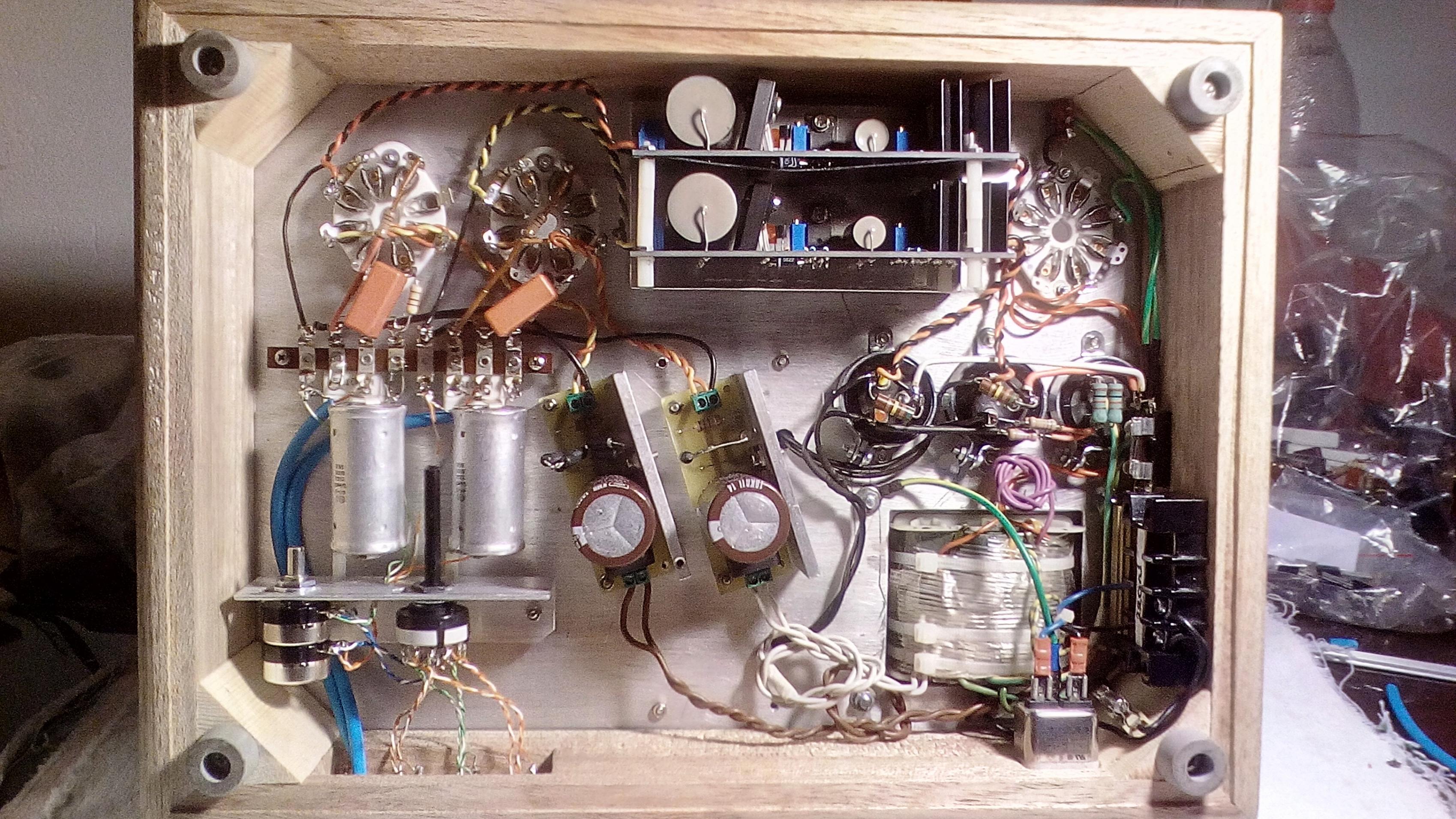

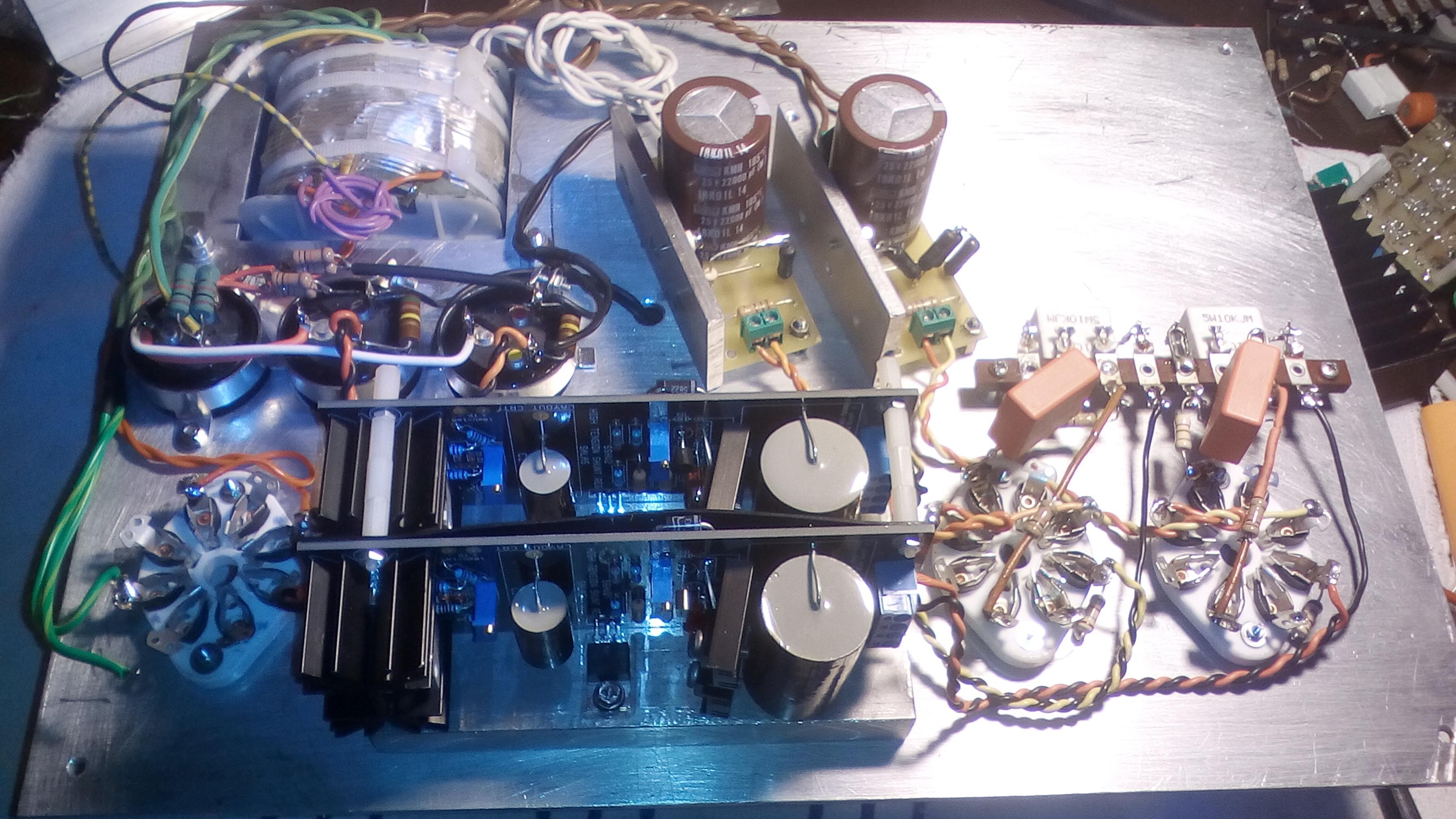

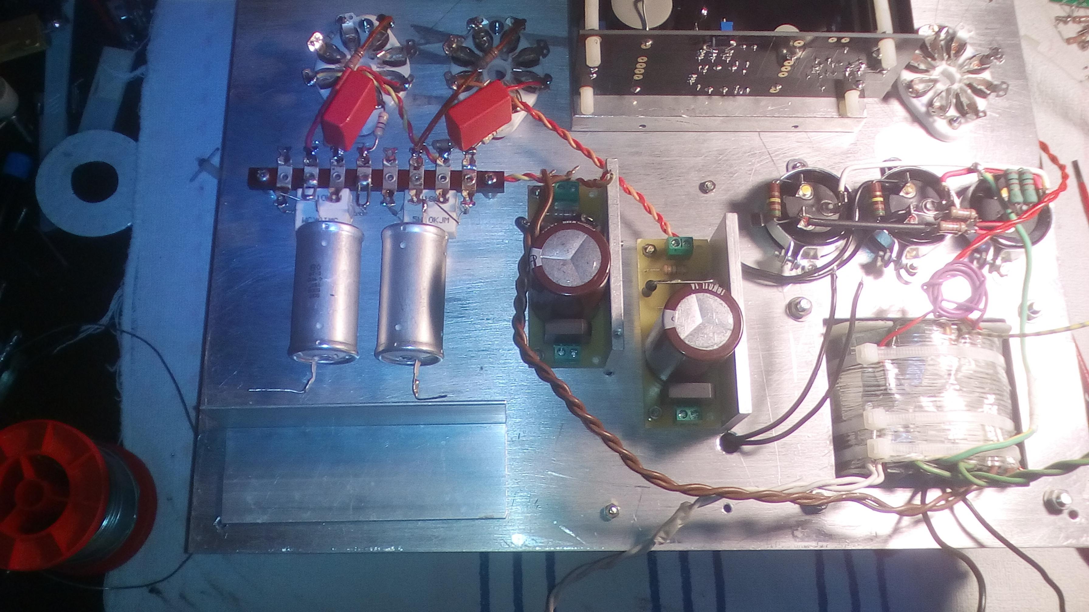

Very nice and minimal wiring too. Lovely.
Where did you get those ceramic octal sockets ? I have only seen the usual pcb mount ones and ones with tags that are made of skimpy metal. These look like the contact is much more reliable AND easier to clean. I should try and get some.
Edit: I just found that Tube Depot has them. They call them Vintage style ceramic octal sockets !

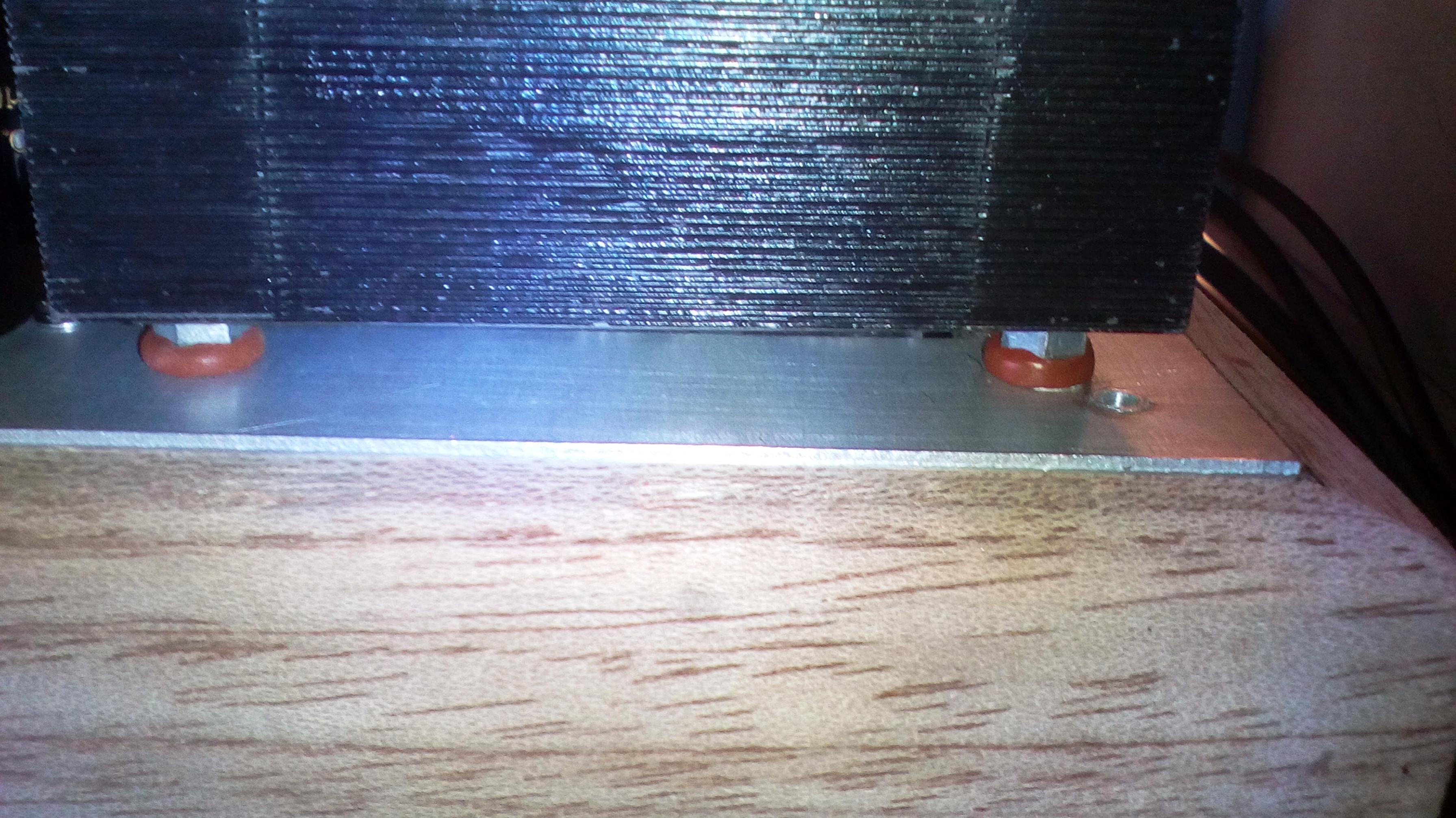

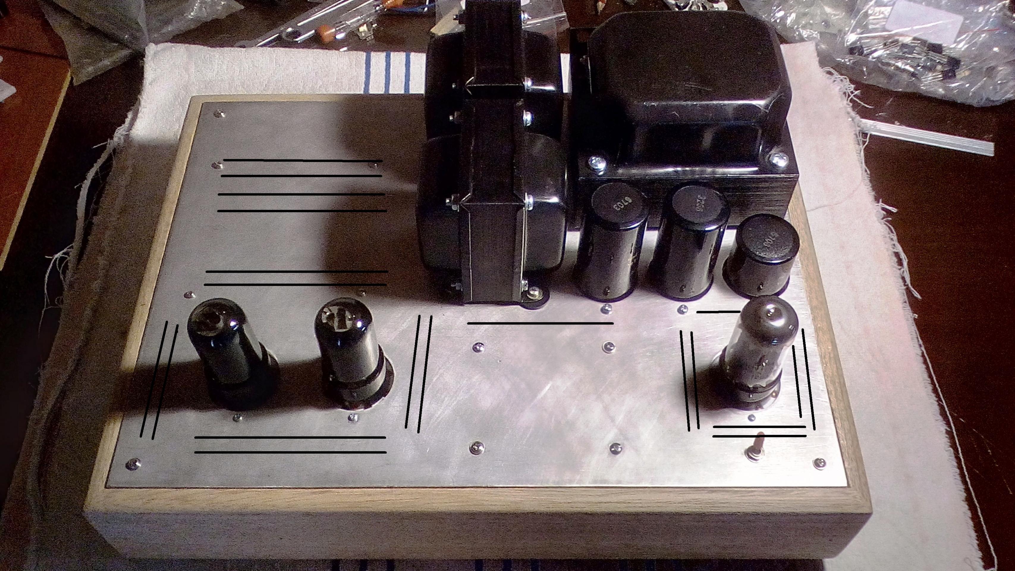

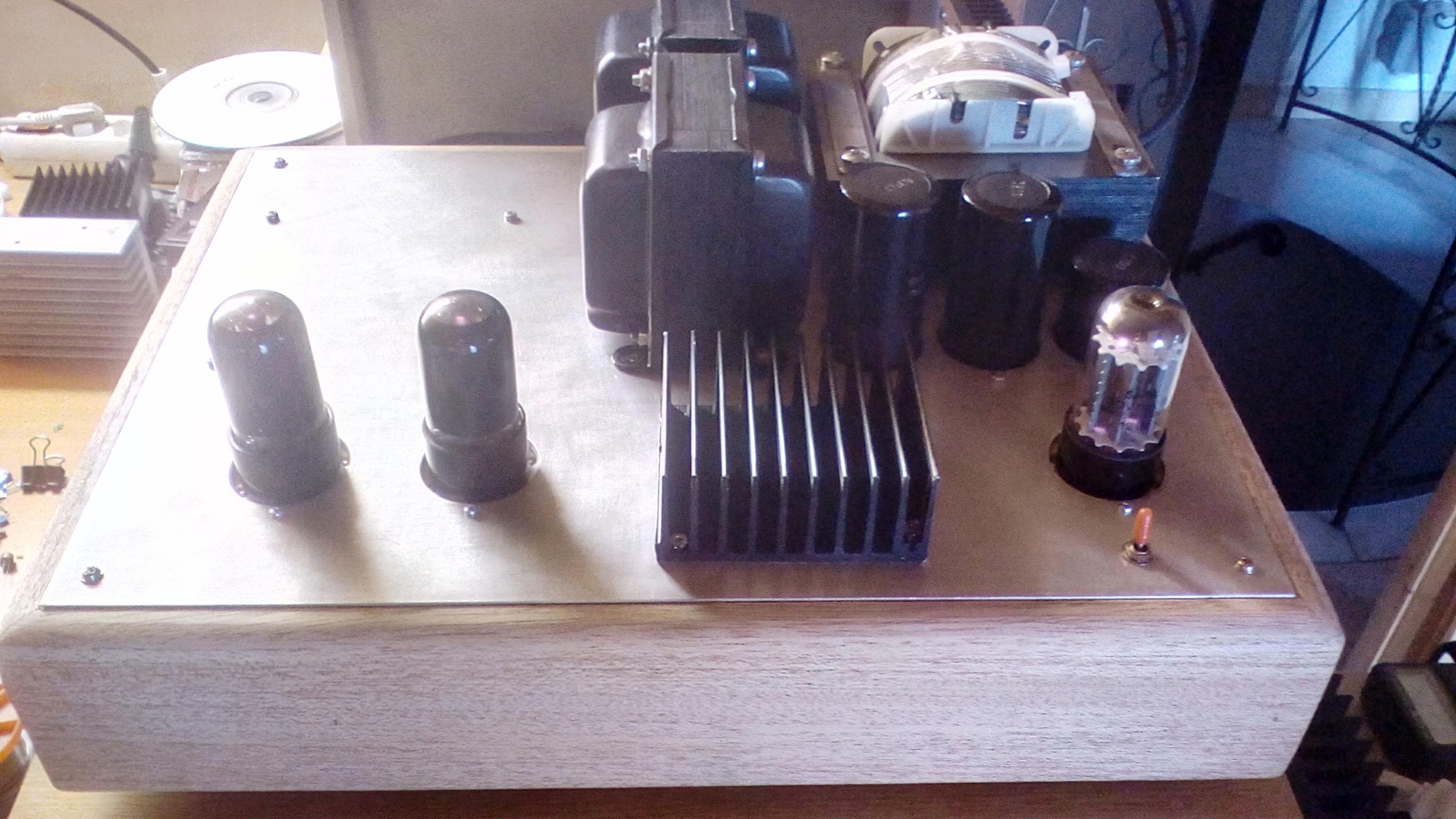

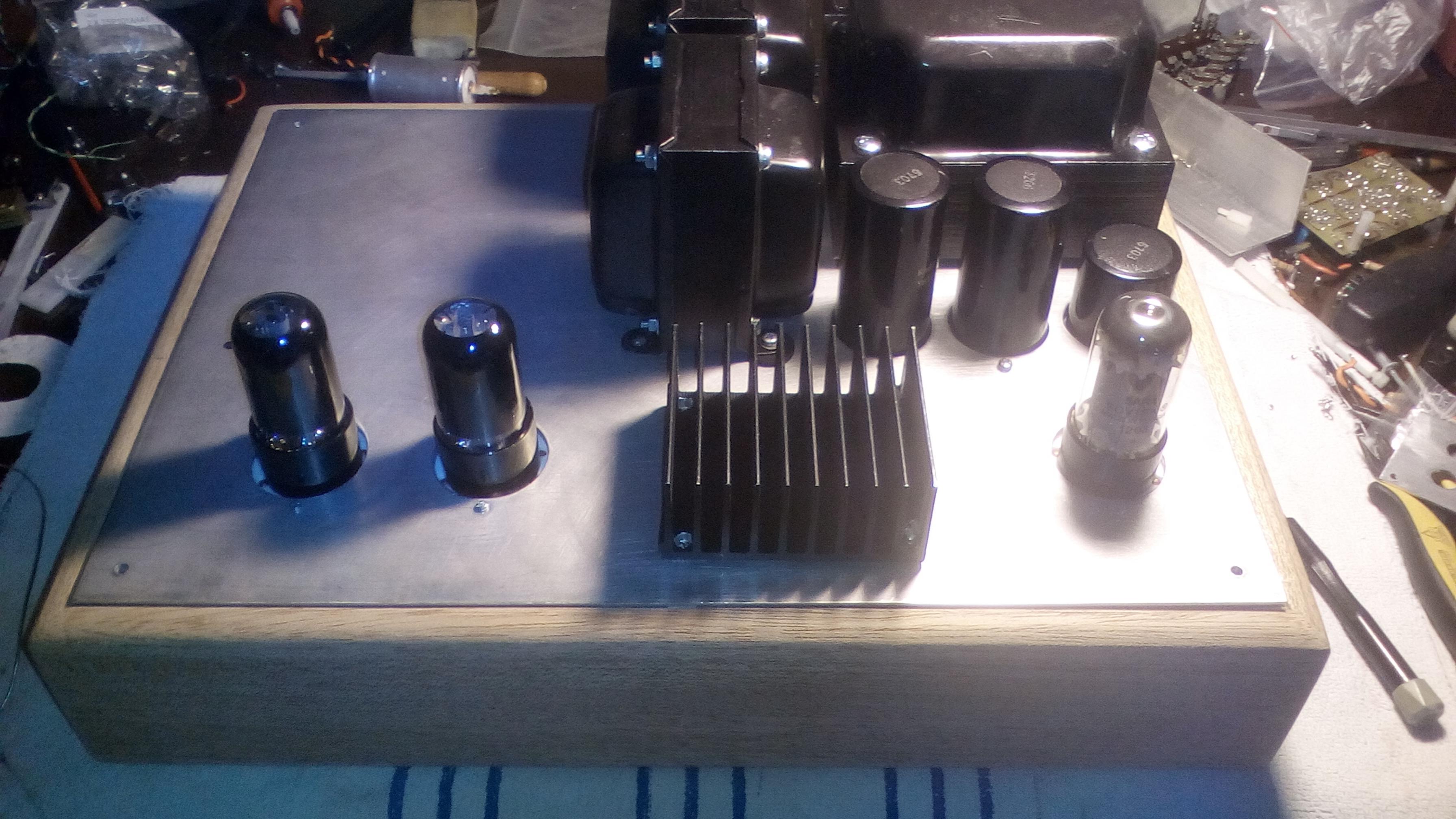

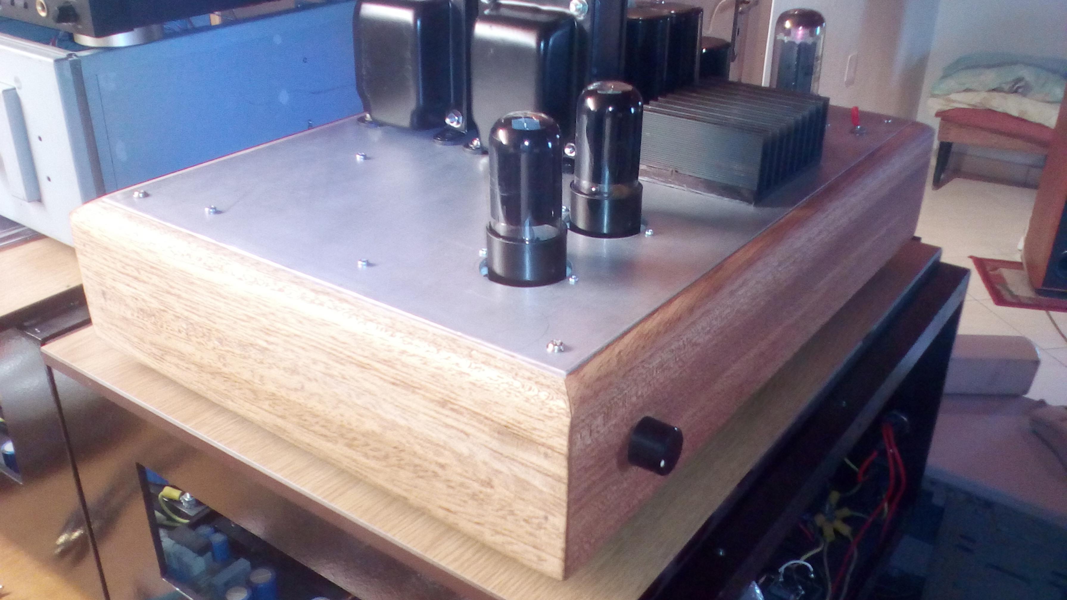

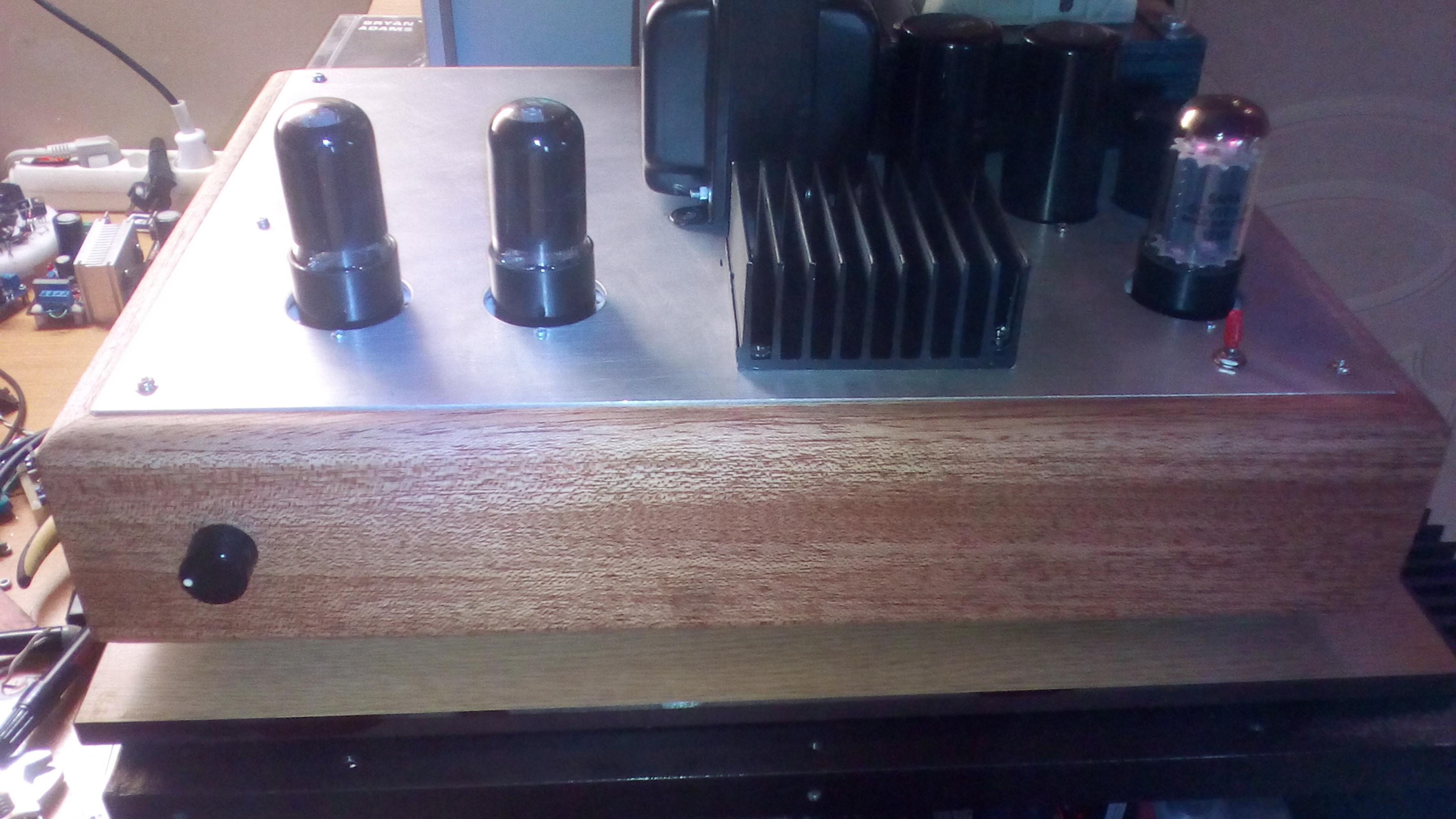

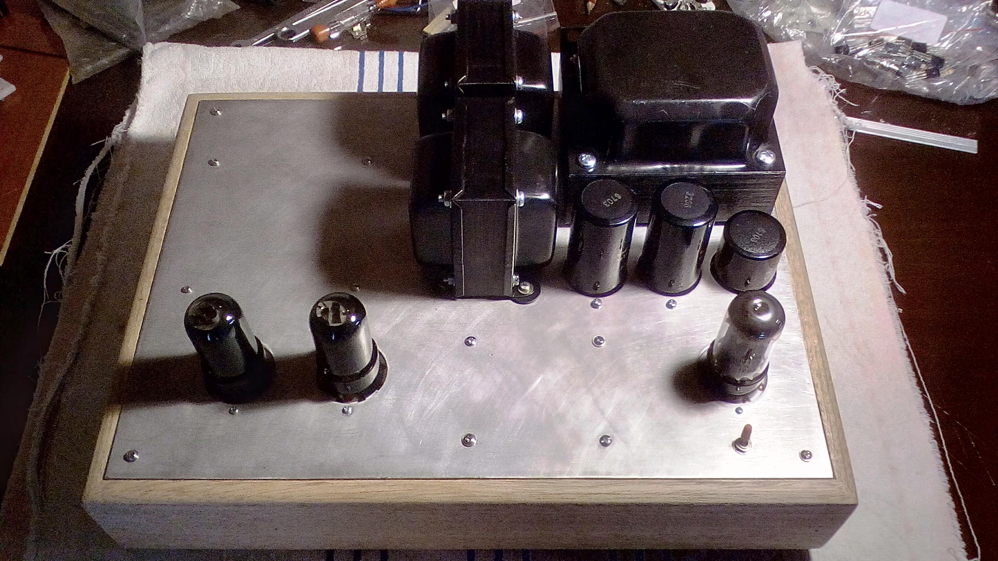

The problem with mechanical noise from the transformer solved.
the only problem that remain is big temp inside the box, on aluminium surface i can measure 44-48 Celsius degrees , temp air about 30 Celsius degrees.

Tubes, heater PSUs, HV shunts, all heating up the lone aluminum top plate. Drill circumferential holes around the tubes first. Have holes at the bottom panel (can altogether avoid a bottom panel by only using feet at the wooden plinth's corners if the audio room is never dusted by an unsuspecting person or visited by unwatched kids that may lift the frame and put their hands under it for fun).
If it will still not feel comfortable touching the top, also a large enough sink can lie at the back left unoccupied top panel's area. Same general shape to complement the front one visually. Or try that first to see what happens in case you prefer to avoid holes if possible.
