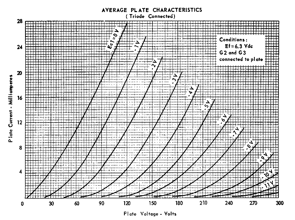

Are those curves for the 6V6 in triode mode or the 6AS6?
6AK5 - 6Ж1П has the same curves.
How so? Besides the obvious difference in the supply voltage, the bias scheme is also completely different, but I guess if you net everything out - all common cathode stages are very similar...Circuit is really similar.

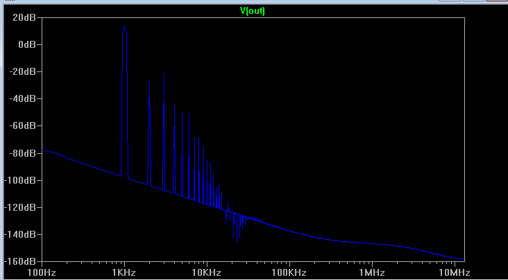

Dropping the 6V6 in the same NovaPA's circuit it would take 10K anode load to centre and it would be good for up to 1V RMS input signal with 5x gain and rather gross THD as in the attached picture. With the 6AK5 and 1K anode load it should be making much lower gain I guess. Also better THD I hope.
