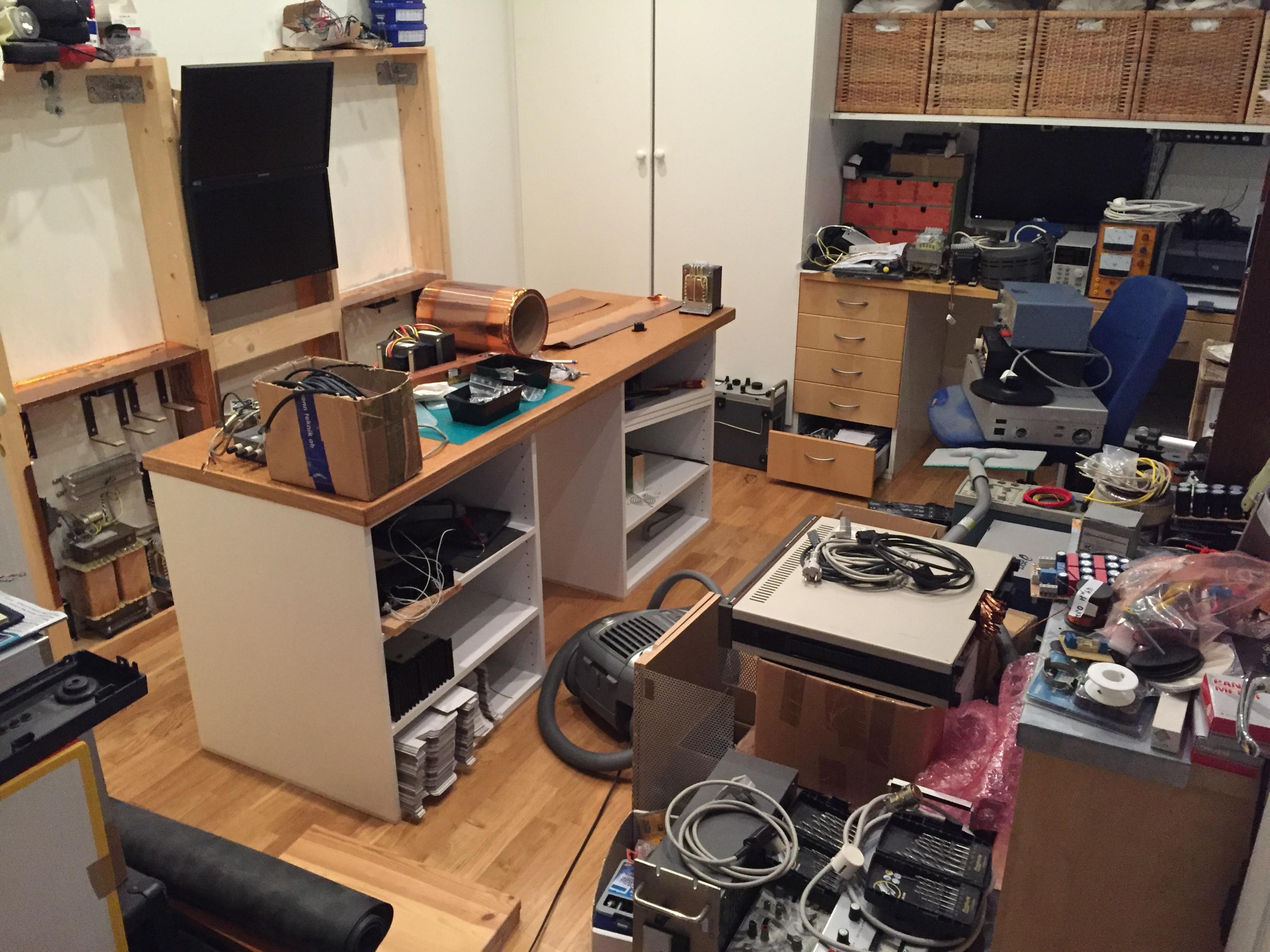

Yea but I need to prio my projects. First in line is finishing the lab bench. Then proper boxing for the riaa and buffer. Then new strict poweramps. This play is just fun inbetween😉

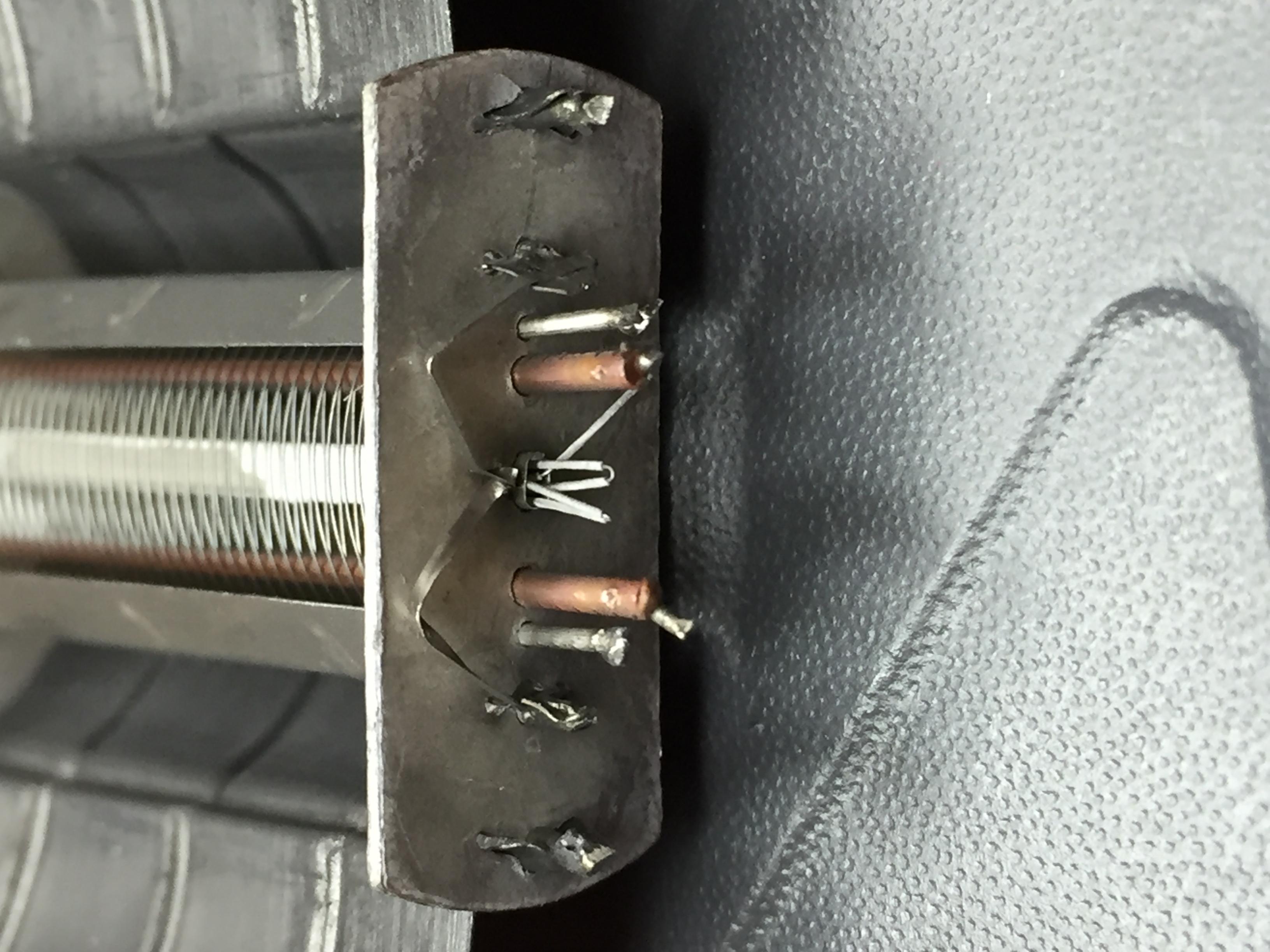

Yes. You can also see how the suppressor grid g3 is interconnected with the cathode. But since its not heated up to the cathode level it doesnt emitt electrons but rather beams them in place. The rigidness and self resonance of this construction held in place by the micas and the glass is what sets the level of microphony.

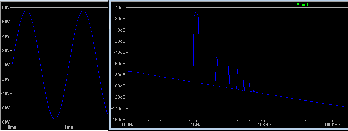

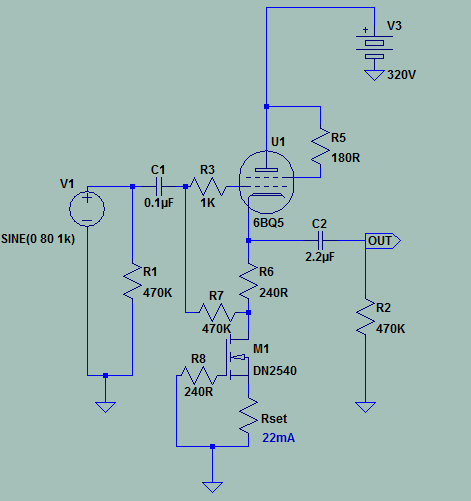

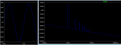

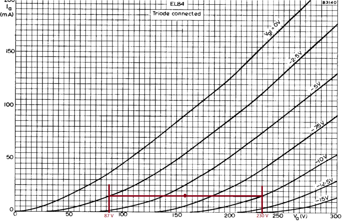

Salas, how large would a triode bootstrapoed EL84 CF with a stiff CCS on the cathode swing without terrible distorsion?
With your 320V B+, 240R between cathode and heatsinked DN2540 @ 22mA CCS, 470K bootstrap from drain to the grid, it can do 150Vpp output with 160Vpp capacitor coupled input before high distortion
Ok you putted yourself a bit higher in current but otherwise fairly similar figures. Still it cant swing that much in cathode follower mode that I had hoped for. Maybe 8-9 Vpp compared to what a common cathode 6V6 line amp might spit out if you have a low sensitivity low z in poweramp. Thanks.
Where is that output swing? Its a CF. It gets fed back right? The whole tube swings that. I just wonder what the sim measures.
Its an input bootstrapped CF with stiff CCS. The drop across R6 biases the grid -5V negative. Its fed to +/-80Vp and has a gain of 0.94. Zin=470k/0.06=7.8MegOhm. After 150Vpp out it eats up all half rail as centered. The sim shows 150Vpp Vout swing on 160Vpp input signal and THD Vout.
