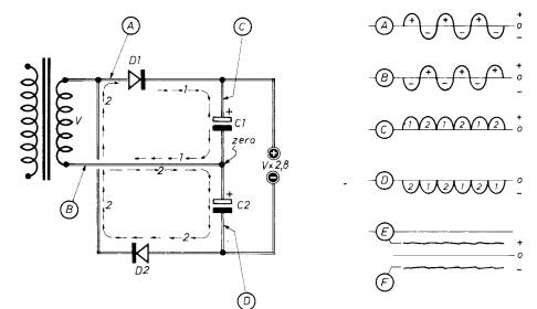

Also I change to gain configuration schematic to listen differences, it is beautiful but a serious comparation wasn't possible becouse I pay for inductance use about 40V on B+ so I'm thinking a good way to raise B+ with components on my hands, probably the doubler is too much but a series of High voltage capacitors in parallel to diodes could be useful? there is a better way? the actual transformer coud give 230 V with 180 mA

Ok, so no voltages to mention to get there. Maybe a voltage doubler and tube rectifying would get you in the game.

The Cockcroft-Walton cascade you thought of, if I got you right as in the picture, VS simply voltage doubler of any type is a way to go x4 x6 x8 etc. Not what you look for.
230 V on secondarys would give you some 320 on the first cap. Then you could filter 20 and give an SSHV 20 for overhead. That would give you 280 V on the anode on a cathode follower. Would work. Or what have I missed?

You missed none, after CLC plus bleeder resistor of 330K I've 280, after there are two resistor (50R) with big capacitor for each channel at about 270 and it run, what I would try is to raise more volt as possible to B+ becouse I loved the sound on 310 volts but the hum was audible.Again as I say before, this is my game : give out the best sound with the actual constraints (box, components avalaible, ecc)

I think thats a voltage doubler. And your doing the right thing to experiment. Tho I dont think you will find anything better up there in the voltages linearity wise. But linearity is not everything. Experimenting is tho. Keep on.
Two keys to a good tube based CF tho. High transconductance tubes and a stiff under lip. Try sim a CCS in the bottom instead of a resistor that steals your voltages. Or a proper inductor. Will save you voltages and give you the oomf. An active CSS is about the same as a large inductor and as a very large cathode resistor. Just that your resistor has to be in the Mohm class to compare and THAT would steal some voltages.
