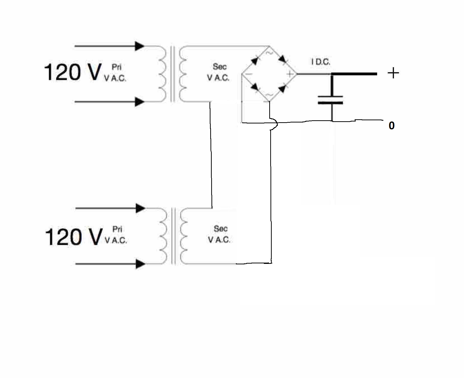

Do you need 240VAC for 6V6 right?
You don't have 240VAC tx but have two 120VAC?
Look attached schematic isn't unsafe
