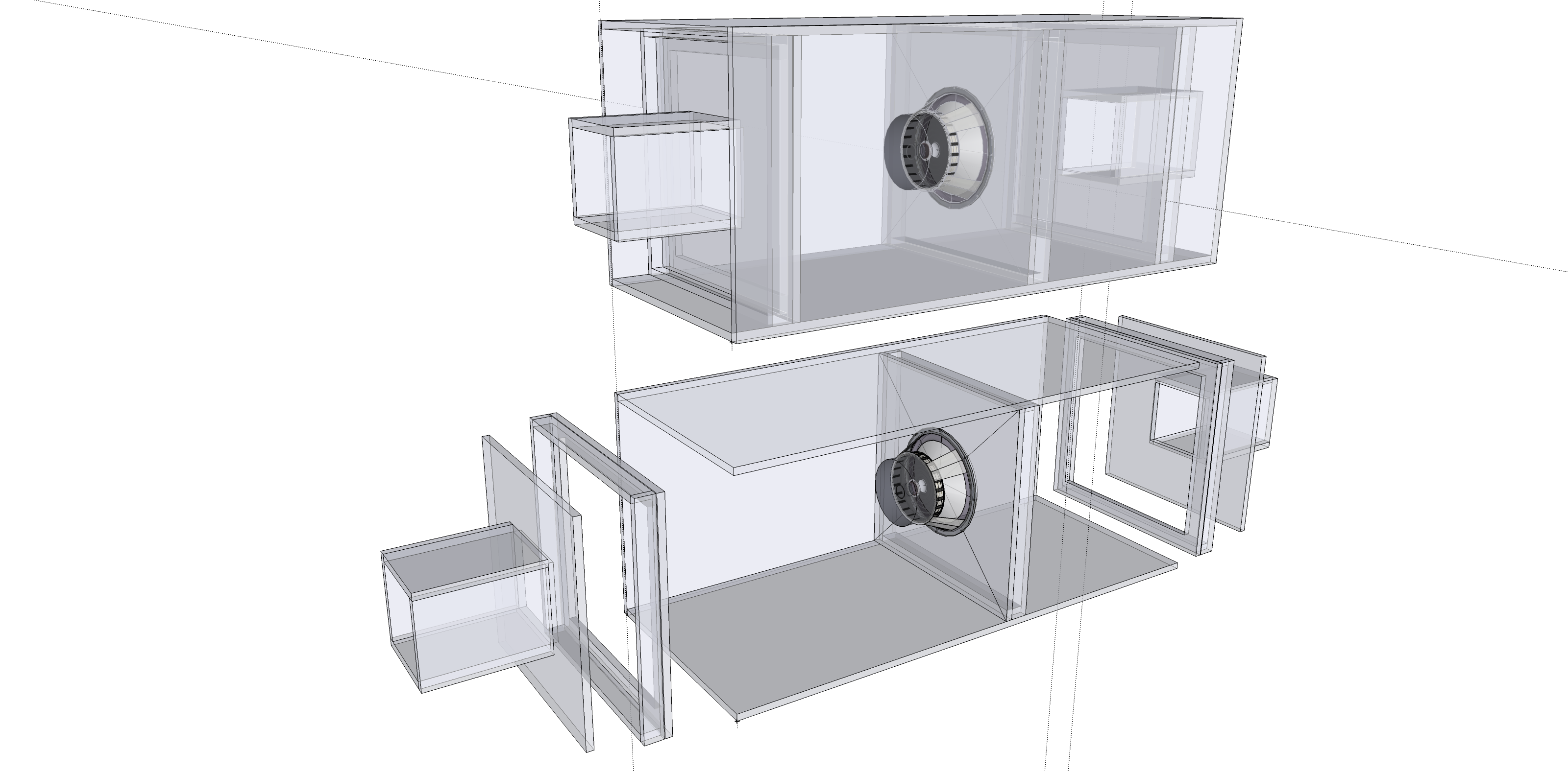

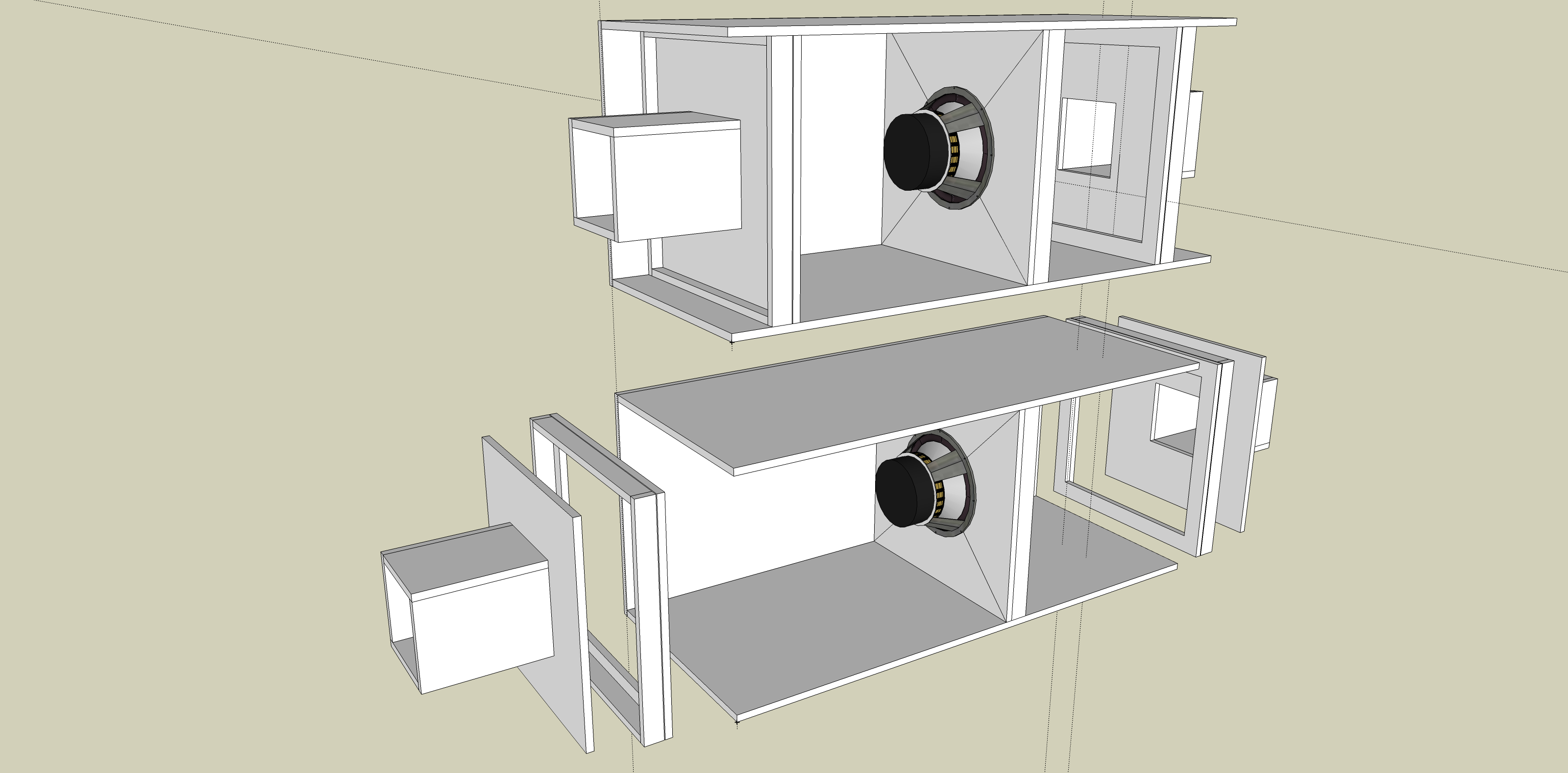

If you find that you want to experiment but get tired of building enclosures and wasting wood (like I did), you can build an enclosure with movable components. I've never done this for 6th order but have for ported and 4th order.
The wide internal flanges are covered with felt. The enclosure is built so they fit tightly. At low power, the leakage will be insignificant. Even at higher power, it work fairly well. Much of the initial testing will be at low power, just to see how the output response changes.
The port panels use minimal wood and screw into the sliding panel section. The woofer can also be moved to allow an even greater change in volume for each chamber.
This is the sketchup file is anyone is interested in it.
http://www.bcae1.com/temp/6thordertest01.skp
