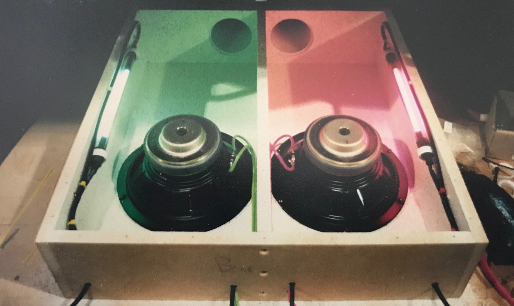

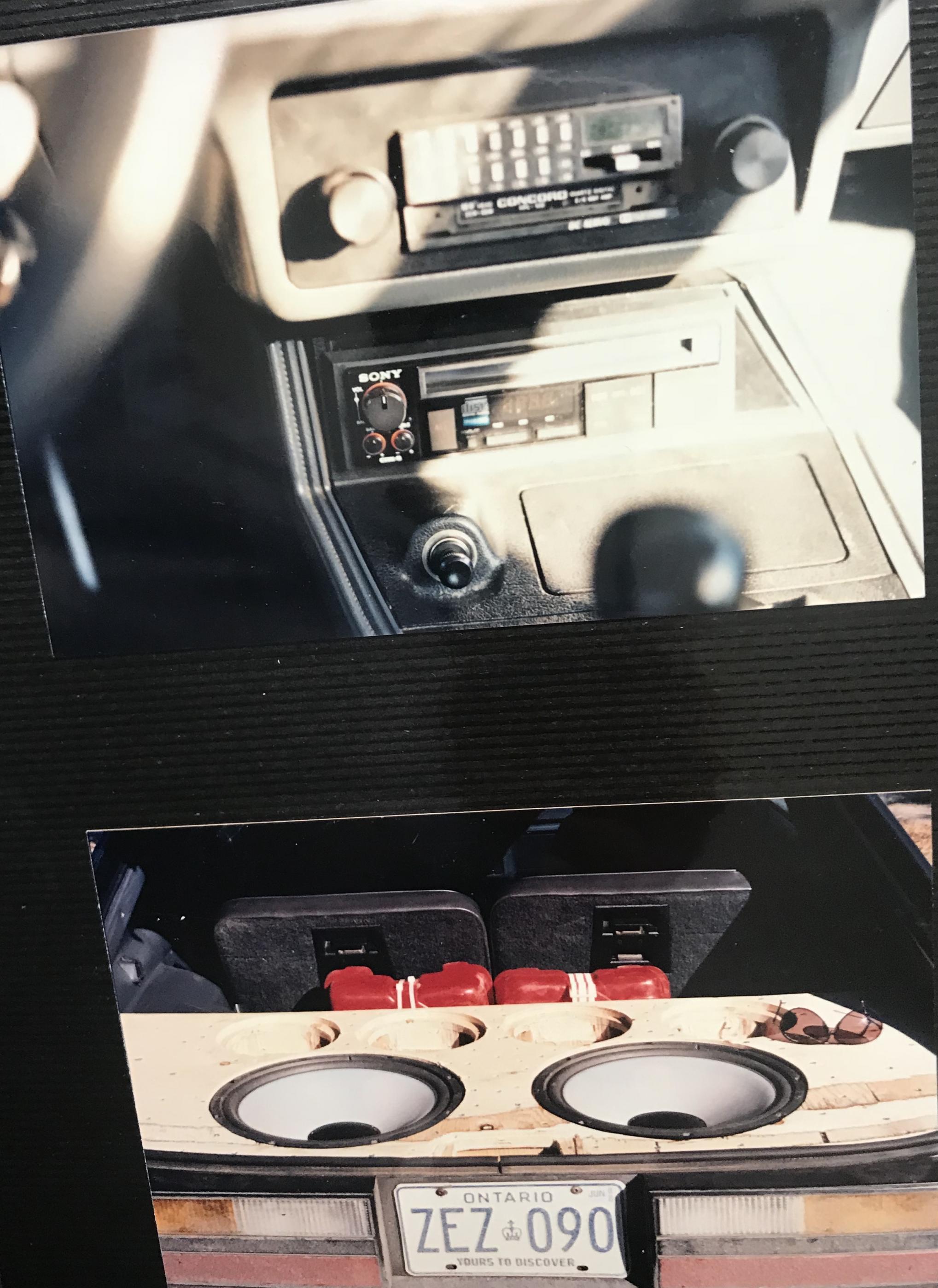

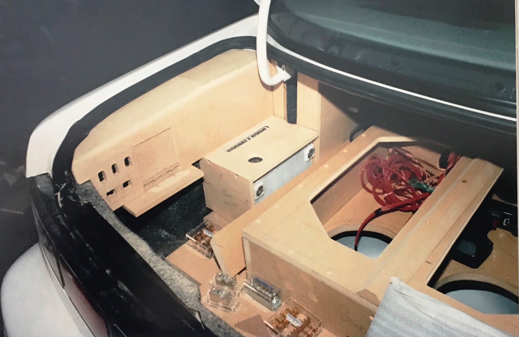

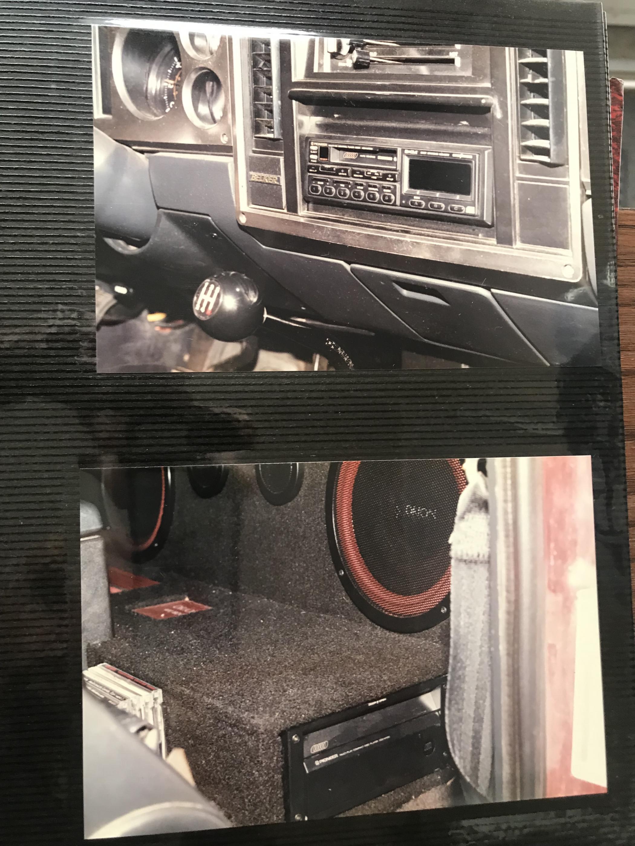

A few comments from my not inconsiderable experience in designing and building literally dozens of these in the 90s.
1) If the air in the port begins moving somewhere near 1/2 the speed of sound, you start getting port noise; this has to do with air pressure, port and moving air volume and the related surface area of the port. Speaker dia, xmax obviously play a part in this, as do sharp edges and restrictions. The closest description a car guy would be familiar with is the cylinder head and intake manifold port flows; bigger isn't always better, depending on speed and rpm.........lots of parallels.
2) Certain speakers function much better within various environments. In my experience, lots of subs that work well in sealed enclosures can work well in 4th order boxes. Same with subs that like ported enclosures can sometimes really like the double vented 6th order design.
3) Making a 6th order relatively sound Q will not necessarily give you significant boost across a wide frequency range; but it may.
4) Usually, for a 6th order to be efficient and decent sounding, it's gonna be massive in size. Add in the large port areas, keeping the port origin far away from walls and floor of the enclosure, and you have something that is not going to be very space efficient, if even possible to install into a car or the space you have in mind.

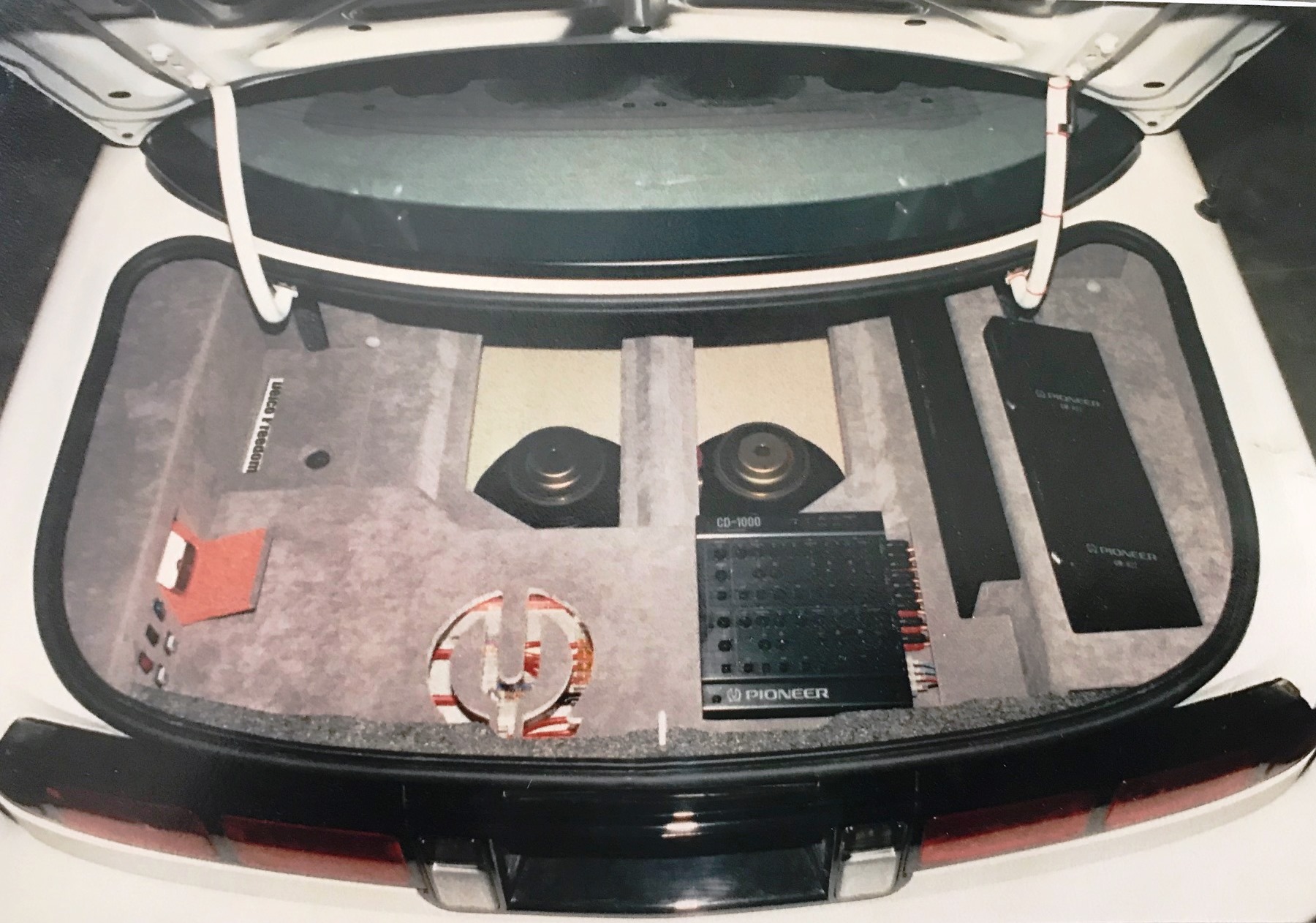

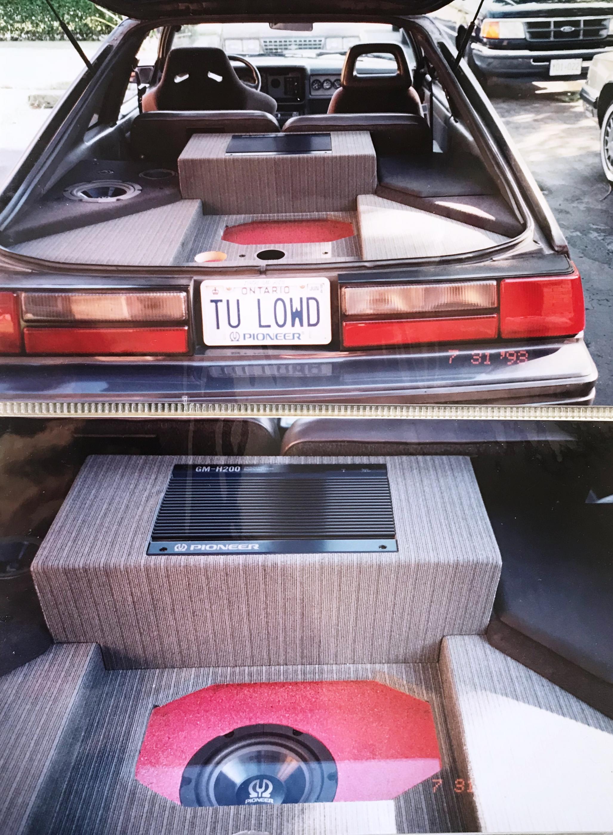

A good bandpass enclosure can be a revelation when considering the limited cone area vs output - one of the best sounding bandpass I ever built was a Pioneer TSW201C 8" in a 6th order, overpowered by a GMH200 in mono. It sounded really nice and tight, had excellent low end extension....but wasn't loud enough despite going above 120 dB in the Fox Mustang hatch. I also built a Chevy Lumina demo car for Pioneer using two of their sealed 10" in two 4th order enclosures, with external tube ports running into the rear seat. That was also quite impressive sounding and was over 130dB with relatively modest 160W rms per speaker. Still, way too big compared to a good sealed or even free air or ported desgin; but........it showed what is possible. Pls see the attached pics. Also, in my experience, bandpass enclosures typically require some real mid bass support from ideally 2 or 4 eight inch woofers in order to add the midbass precision that will be missing.

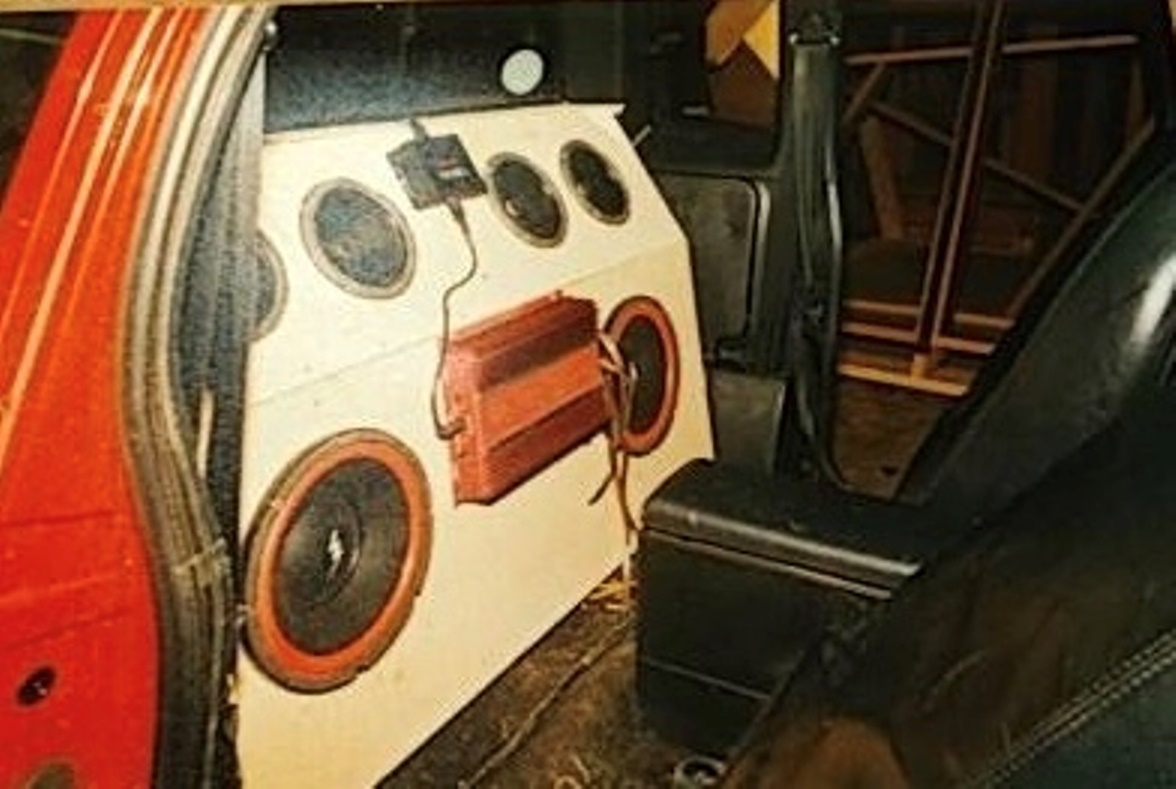

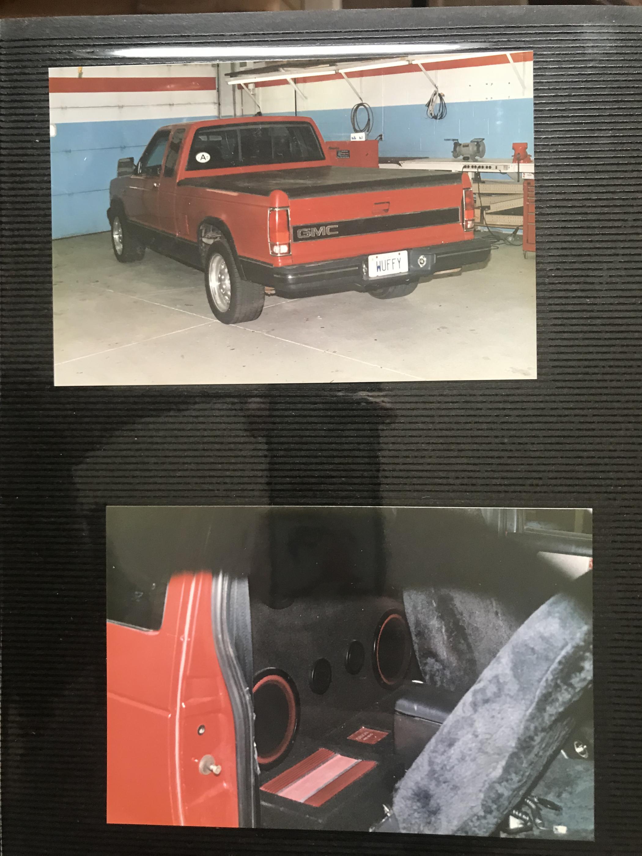

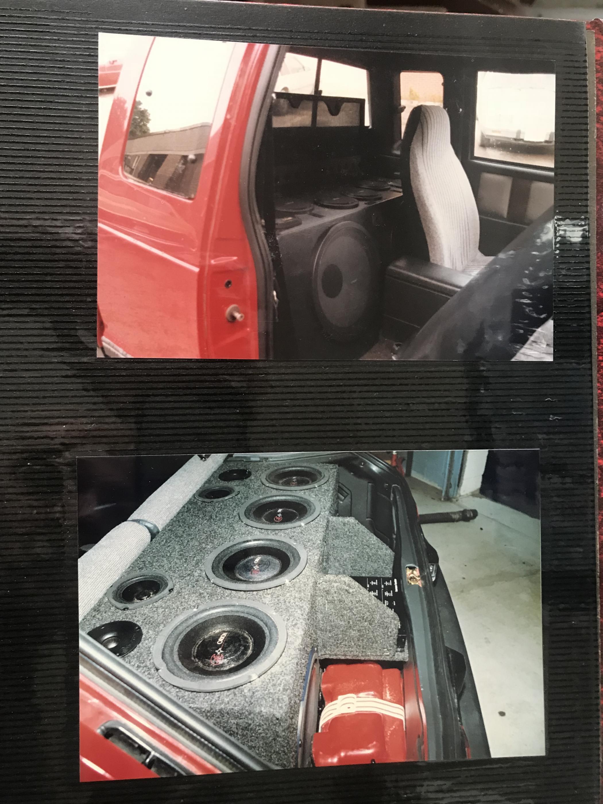

and the Mustang; this car had about 10 competition level systems in it, most of them never fully trimmed and finished. 2 15s and 4 eights, 4 tens in two totally different arrangements; single 12, single 8, 4 12s isobaric sealed etc etc......23 years of one car ownership allows for some variety, lol

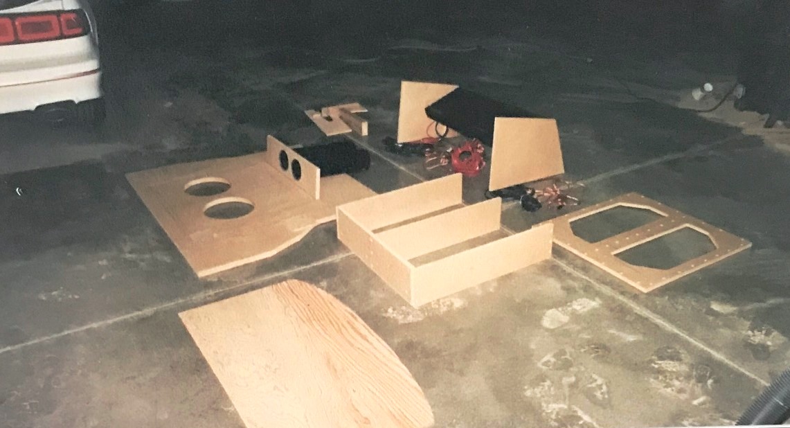

Here are a couple of designs I published for Pioneer and Dr. Crankenstein back in the mid 90s when I worked for them both.
