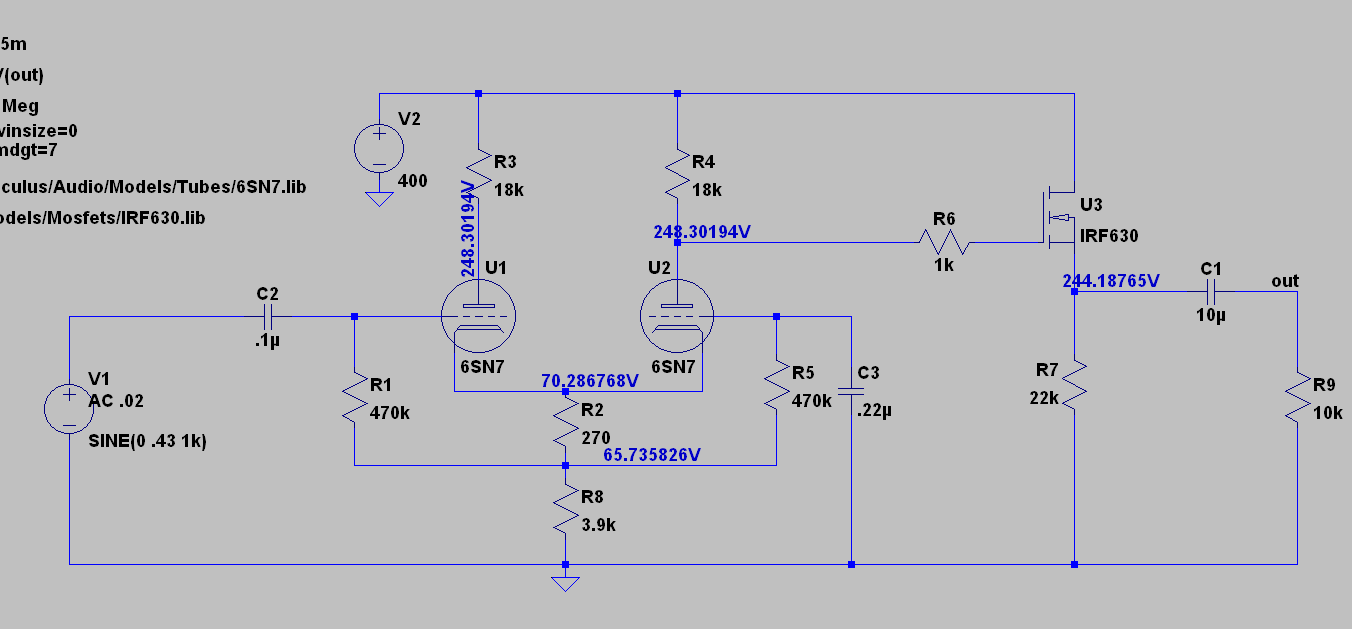

Well, you guys are definitely more clever than I am. But this makes higher distortion, I'll bet! Gain is about 10X. THD at 2V RMS out would be about 0.1%, according to LTspice.

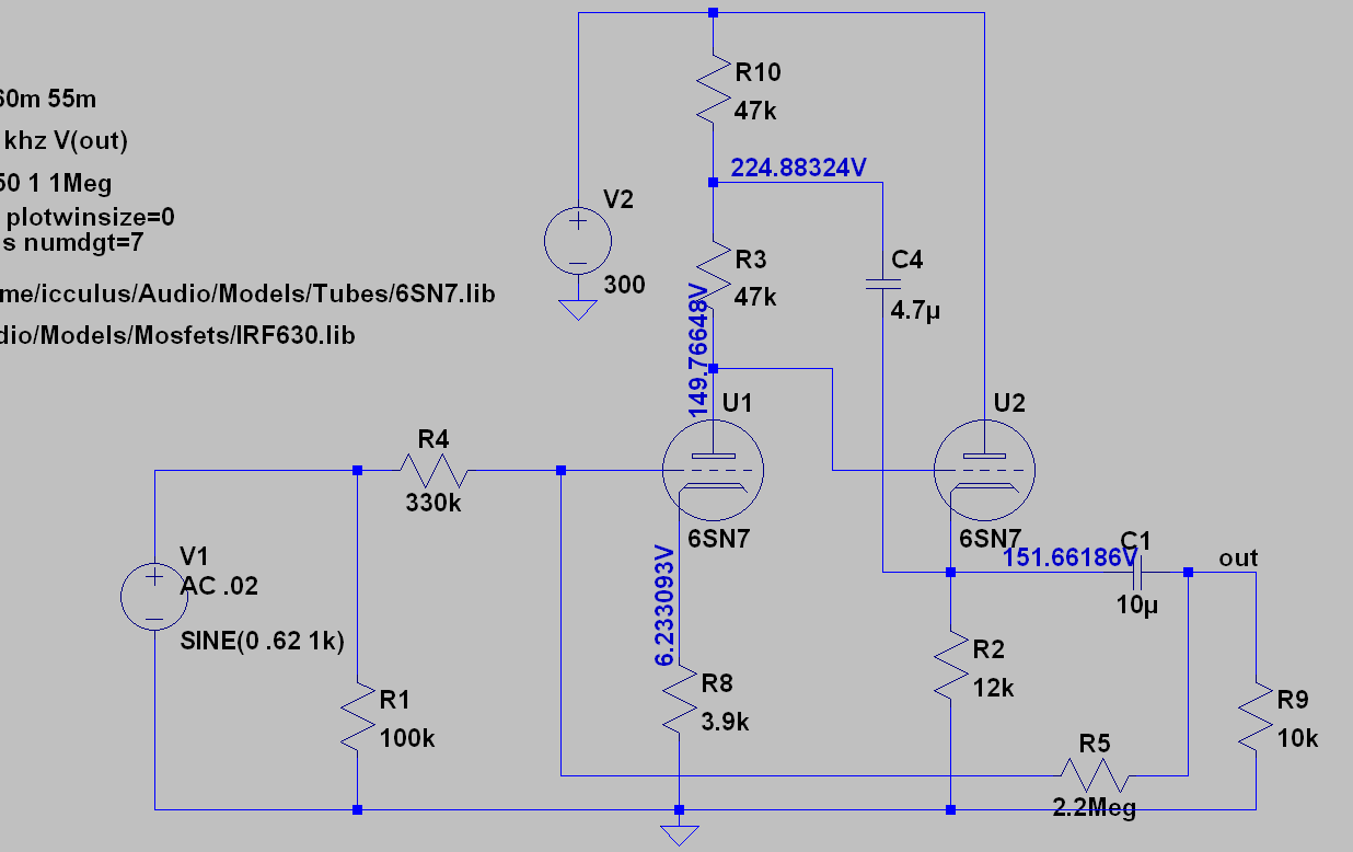

I ran a 6SN7 SRPP pre for years and really sorry I sold it. It was designed my John Hogan (passed away since). I drew out the schematic but it is on my other computer which will be here at the end of the month. I'll post it then.
I was goofing around with this in LTspice, and came up with this. In simulation, it says THD at 2V RMS output is 0.08%, dominated by 2nd harmonic. Gain is about 10X.

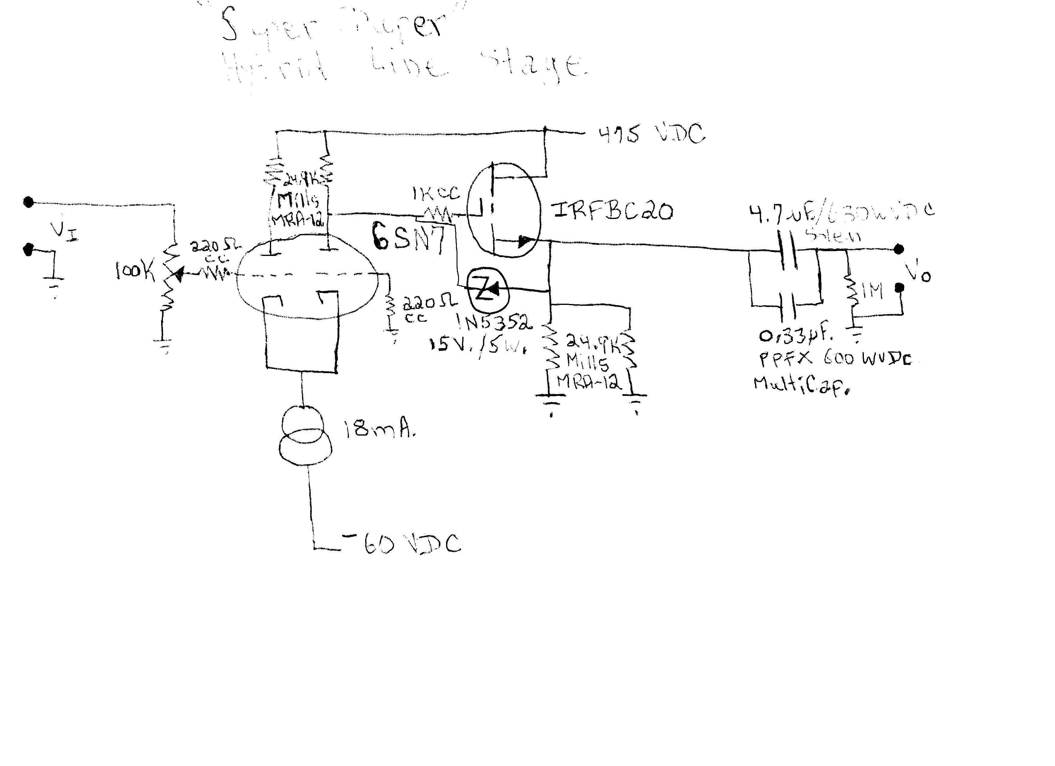

The LTP setup I've uploaded has a gain less than 10. A "tall" B+ rail is required. Other folks have run simulations of the circuitry and found it to be extremely linear. It is possible to "play games" with absolute polarity.
And we're back to the cathode-coupled amp! I like this because it still only uses one tube (MOSFET for the follower). Appy a bit of NFB to the second grid and you're golden. You dont' even need the CCS, so the B+ could be lower.
Hi Merlin and Eli. You mentioned that the cathode coupled amp doesn't need the CCS. Is that only if NFB is applied to the second grid? I'd think the linearity of the circuit would be dependent on balance between the two triodes, which could be enforced by a large impedance in the tail. If you ran it without a CCS in the tail and without NFB, wouldn't 2HD go up with any imbalance?
PS - Cathode coupled amp is definitely the best suggestion so far, with a follower on the output. Low input C, high input Z, low output Z, low THD, the desired gain. What's not to like?
It depends on both the AC and DC conditions. With a true LTP then yes, you generally want a very high tail impedance to cancel 2H, and that's as good as it gets, ignoring valve sample mismatch.
But a cathode coupled amp is often not run with the same AC and DC conditions on each triode, so distortion cancellation is radically altered. You can get all sorts of distortion nulls depending on what parameters you play with. Adding a CF adds yet another layer of distortion cancellation on top, so it's rarely as simple as 'just bung a CCS in there and call it done'.
I would suggest a simple resistor tail for the OP as it minimises the gain in a simple way, and avoids impolite clipping and a -ve supply. In my book there is an example with a gain of x6 that manages 0.01% THD at 2Vrms using only a couple of 12AU7s and four resistors. That's just an example of what you can unexpectedly end up with by tuning the distortion cancellation. And that's with an average valve -who knows what the same topology could acheive with a 6SN7.

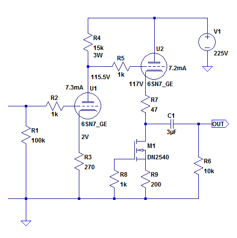

I have managed to read and ponder all schematics presented. The one I do like so far is the cathode coupled amp. I drew up a quick schematic and roughly simmed it. There are probably mistakes so please double check my work 🙂
.044% THD @ 2vrms out
Gain is roughly 6 which is about exactly where I want it to be.
I will sim all the suggestions and then move on to breadboard a few and see which I like the best.
I am excited!!!

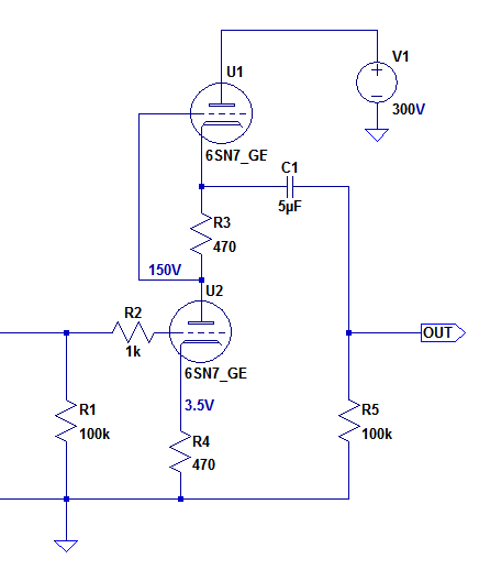

Here is Mike's augmented anode follower. It has .003%THD @ 2vrms into 100k, but driving heavier loads like 10k brings the distortion right up to .03%.
Gain is about 5x
The source follower is the clear winner for driving heavy loads. But this circuit is nice and maybe I should give it a listen when breadboarding.
