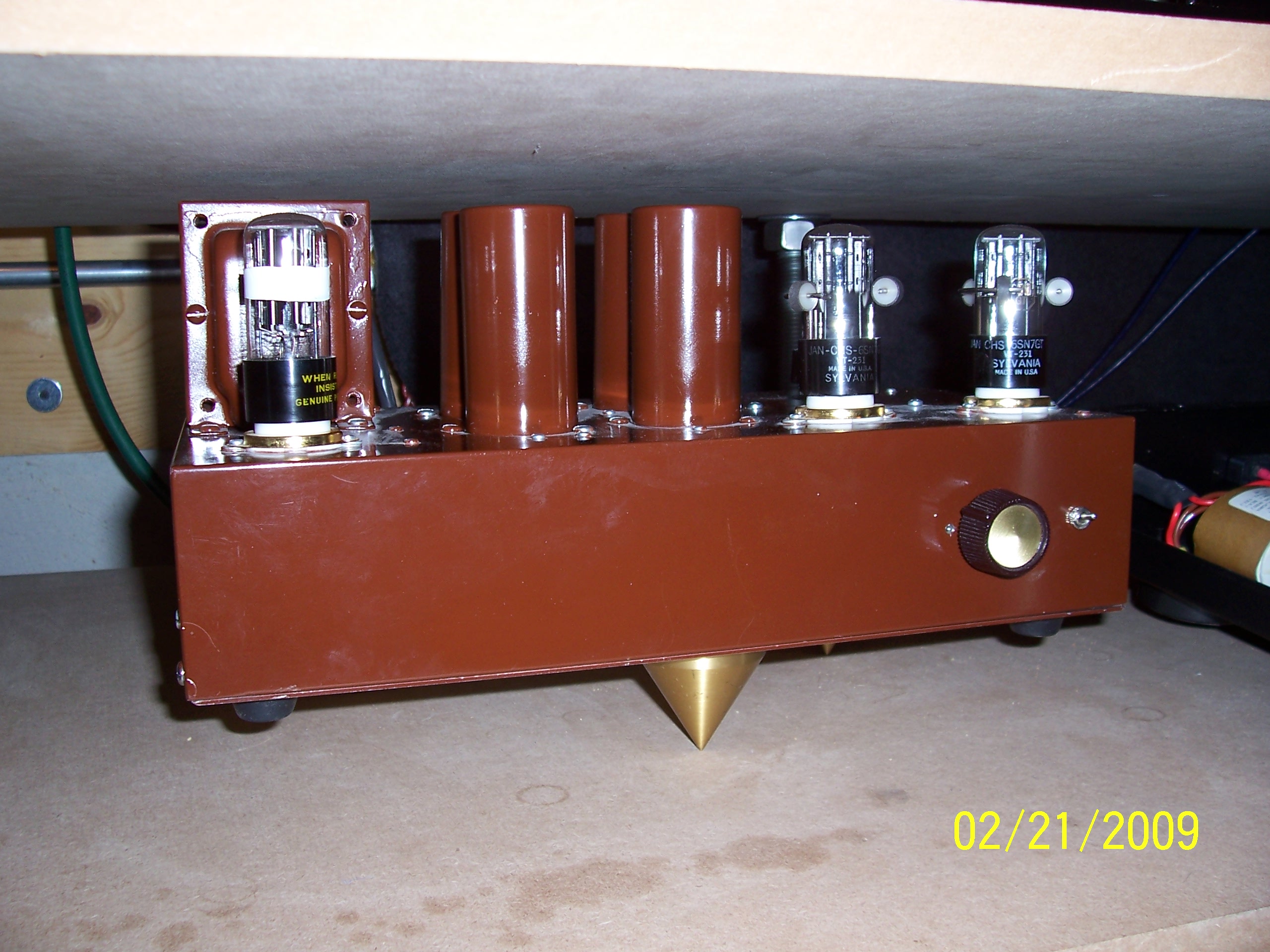

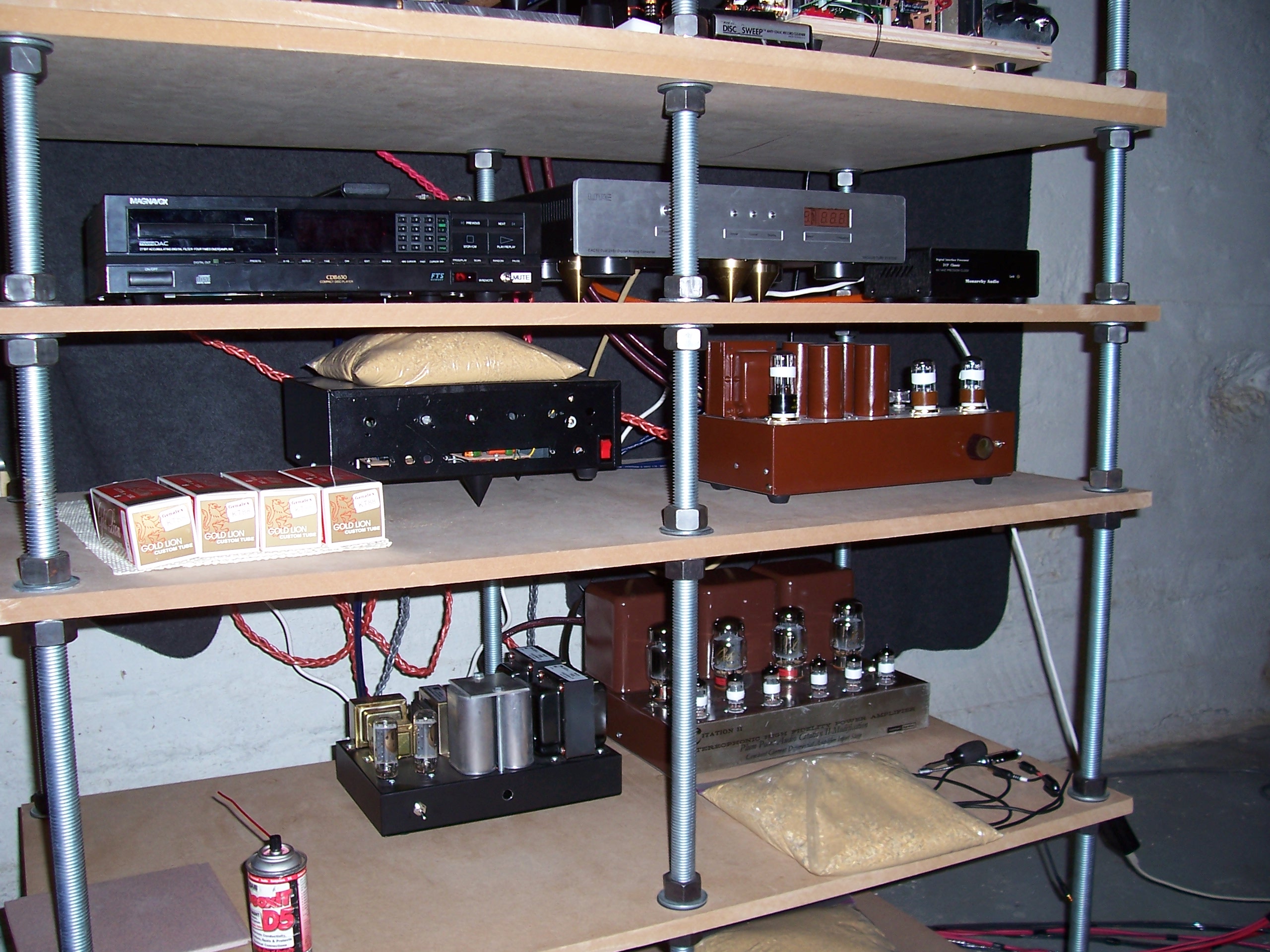

One other thought, Gary. Assuming you haven't tried the excellent Herbie's Damping Instruments, take a roll of good plumber's Teflon tape. Make several wraps about the belt of the tube. Make them tight. This helps with internal microphonics. If it helps you, then the Herbie's are the answer. They worked on my wonderful sounding but very microphonic VT-231 Sylvanias.
I've attached a couple of pictures, one showing the Herbie's Ultrasonic Damping Instruments on the VT-231's and another showing the Teflon tape I used to use.
http://herbiesaudiolab.home.att.net/ultra.htm
TRY IT! You'll be pleased.
Stuart

thanks Stuart,
I used silicon tubing as damping material wrapped around a tube for a while but it made little difference. I'll try the teflon next time. It seems intuitive that mass is what is needed but also interrupting nodes of oscillation might be a factor too. Come to think of it, wrapping a tube in cumbersome silicon tubing might only make oscillation worse by adding mass.
