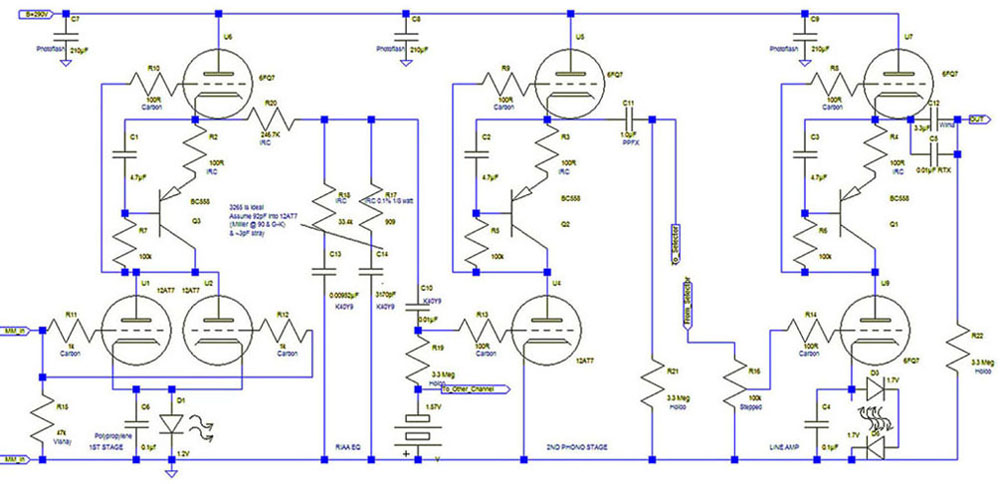

Thanks. I've used LED bias in Beta Follower stages in DACs with 6N1P and 6DJ8/6922s, line level preamps with 6SN7s, phono stages with EC8010s, 12AT7s (paralleled and single plates), and believe it or not 12AX7's in the "RCA" circuit! In each case, it's worked out to my satisfaction. I've altered the LEDs I use to suit bias needs naturally. THE IR LEDs from Radio Shack work well for those 1.2V biases.
When cap coupling to a second stage, I like to use battery bias on grids, connecting the cathodes directly to ground.
I was most concerned about operating at 0.5-0.7mA. So, a little test jig was in order to measure DC voltage drop with changing current. I don't have the numbers in front of me, but if memory serves, there was less than 0.1V difference in DC voltage drop between 0.5mA and 5mA. I do remember thinking that bypassing was unnecessary.
A friend has actually listened to several different LEDs and proclaims one to sound better than the others. Can't say I've gone there, yet. I think it was an Agilent product, but my memory's a bit fuzzy on this.
The good news is that they are quiet enough for 1st stage phono work. About to try a 6GK5/6FQ7 Beta Follower 1st stage phono with LED bias, cap coupled to a battery biased (1.57V Lithium AA battery on the grids thought a 3.01Meg resistor) 2nd stage of a 6AQ8/ECC85//6FQ7 Beta Follower.
As you can tell, I'm sold on LED bias and Beta Follower variants. Thanks to your countryman, Morgan Jones.
For your amusement, I attached a copy of the schematic of a complete preamp I just put together for a friend who insisted on "normal" (LOL) tubes. nothing odd like 6C45PIs, 6GK5s, etc.
Another strange effect is that "rolling" tubes seems to have less of a change on the sound than with resistive loaded, resistor biased circuits.
Keep in touch. Please let me know how your projects turn out.
Stuart

Hi Stuart,
those suspenders look cool. I assume that your microphonics are caused by mechanical vibrations through the chassis, probably from the transformers? I get the feeling my case is the same because holding the tube usually alleviates the singing. In another posting it was suggested that they could be a result of radio frequencies from a nearby tower. Anyway I did my best to isolate the pcb. I didn't go so far as putting the Aikido in a separate box but mounted the transformers and chokes on 3/8 inch of cork and then 3/8 inch or rubber mat. I suspended the pcb using the same material as washers and I sat the chassis on a rubber mat. I guess this is all part of the compromise involved using tubes. The frustrating thing is that it doesn't always occur. I've considered how long the tubes are on, switching input/output tubes, what else is on in the house and on the circuit, music playing/sources disconnected etc. I haven't been able to establish a trend because it occurs in all situations. There is some good advice in the posts above, I'll start with Kevin and Gregg's advice and post any good outcomes.
