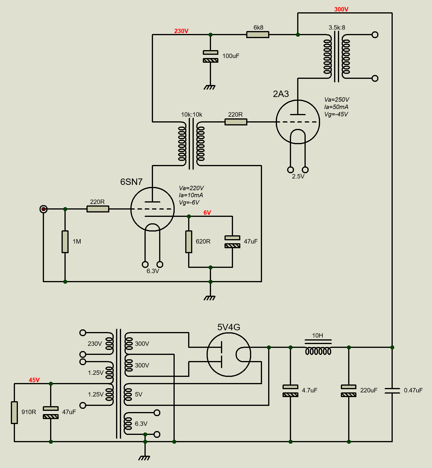

Hello,
Apologies for resurrecting this old thread, didn't want to create a duplicate one.
Can you please give your feedback/criticism of the following schematic of 6SN7-2A3 SET, is there anything obviously wrong with it?
It was inspired by Kismet 2A3 amp but with a 6SN7 driver tube and interstage transformer coupling.
Thanks in advance,
Igor.

Thanks a lot for your input, Ian, Francois.
You are using an IT but doing cathode bias
Are you referring to potential resonance between inductance of IST and capacitance of cathode bypass cap? Is there a way to calculate/experiment with capacitor value to avoid the issue?
you are using 6SN7 as input/driver
I thought 6SN7 is considered a classical driver tube? It has a reasonable rp of 7kΩ and decent current capabilities. Is this still too high for an IST coupling?
Bias for the output tube?
Yes, it's biased a bit colder than classical 250V/60mA operating point, want to be gentle on the tubes.
