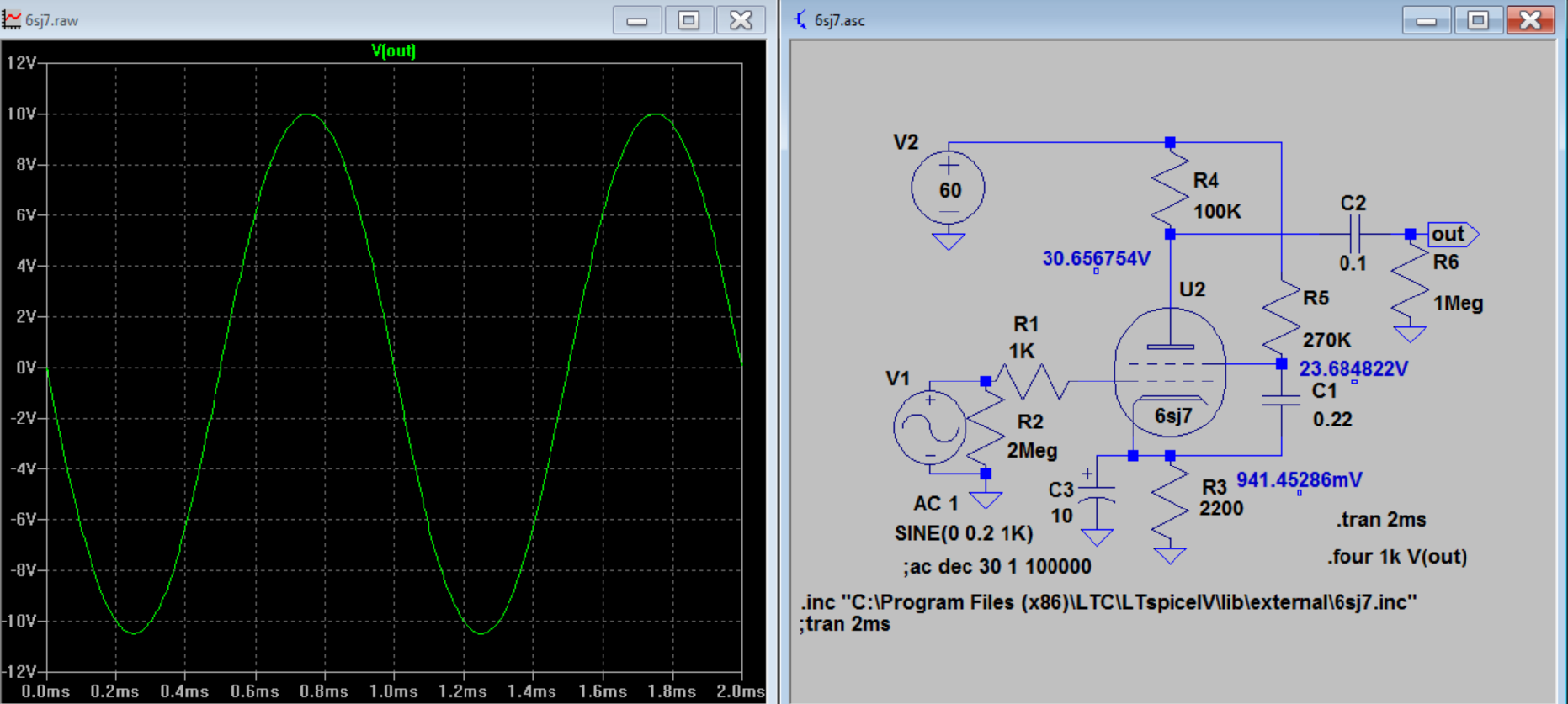

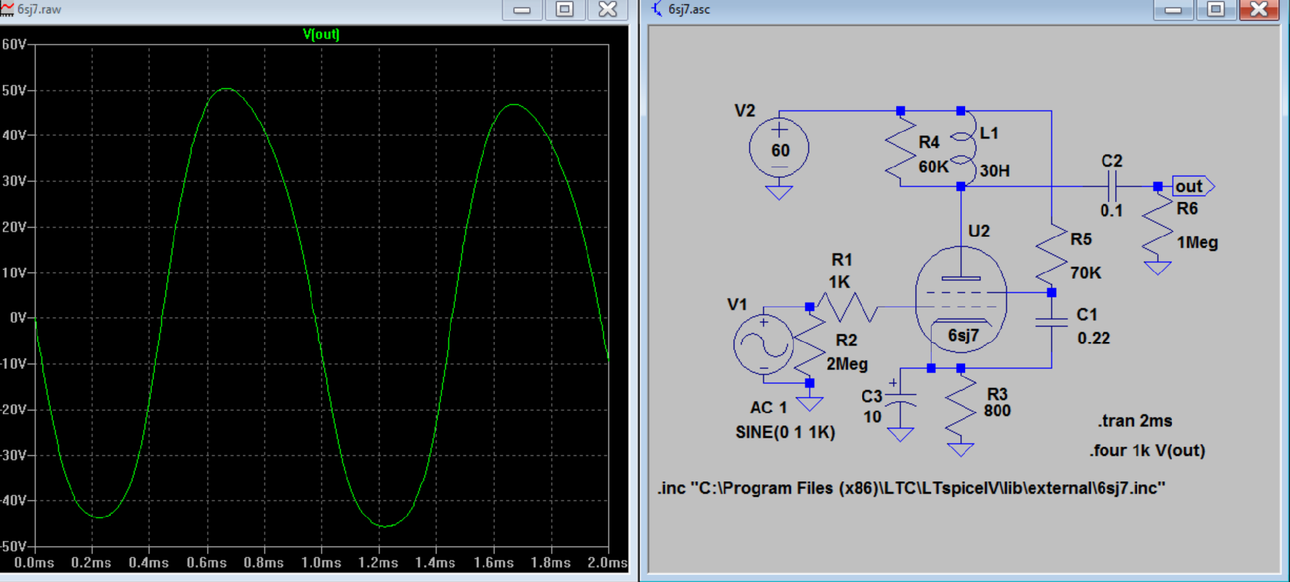

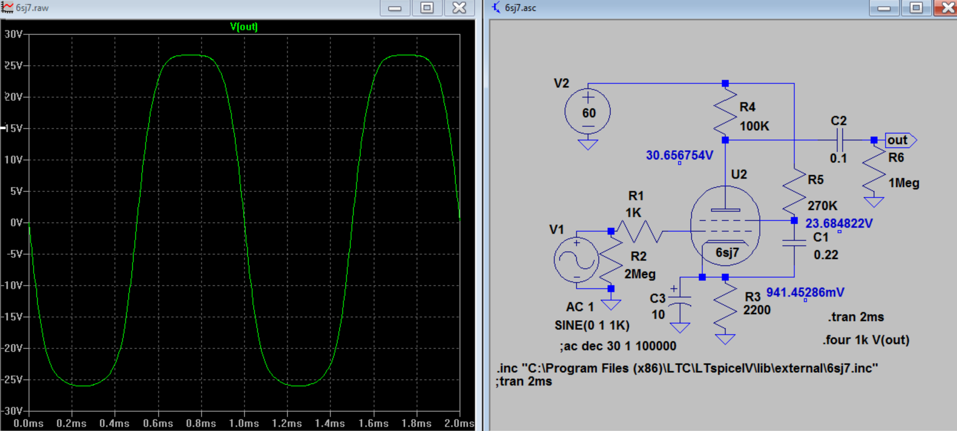

Top gain cannot be more than 25!, below 0.3V can get gain of 50 though, symmetrical gain, distortion < 7%

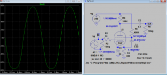

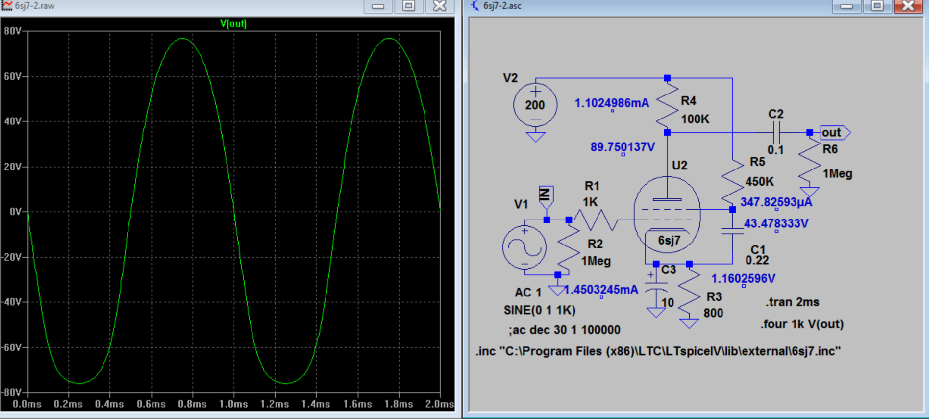

so how about:
200v supply
-1v grid bias
25v screen
plate current about 1mA
screen current about .25mA
100K plate resistor
700K screen approx.
800 ohm cathode resistor
this is as a starting point.

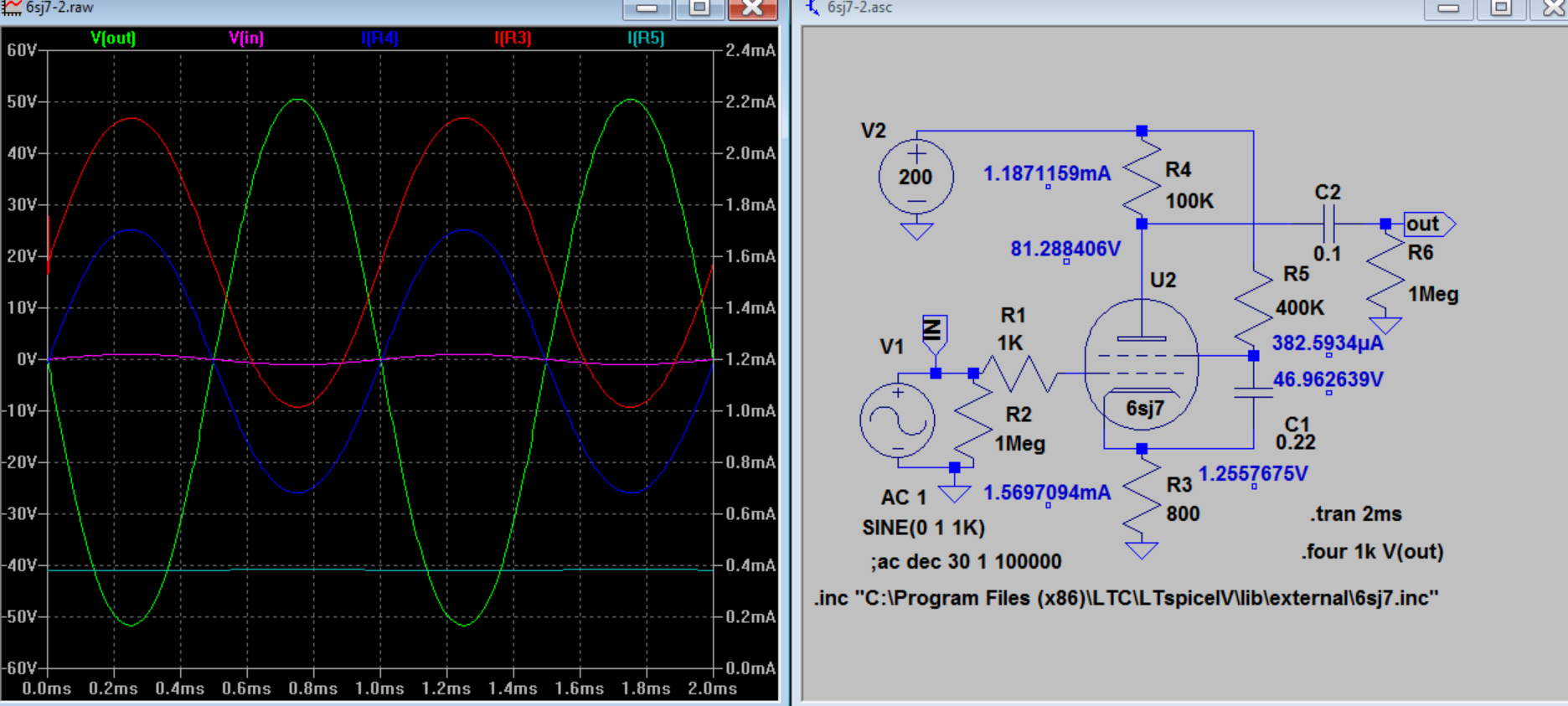

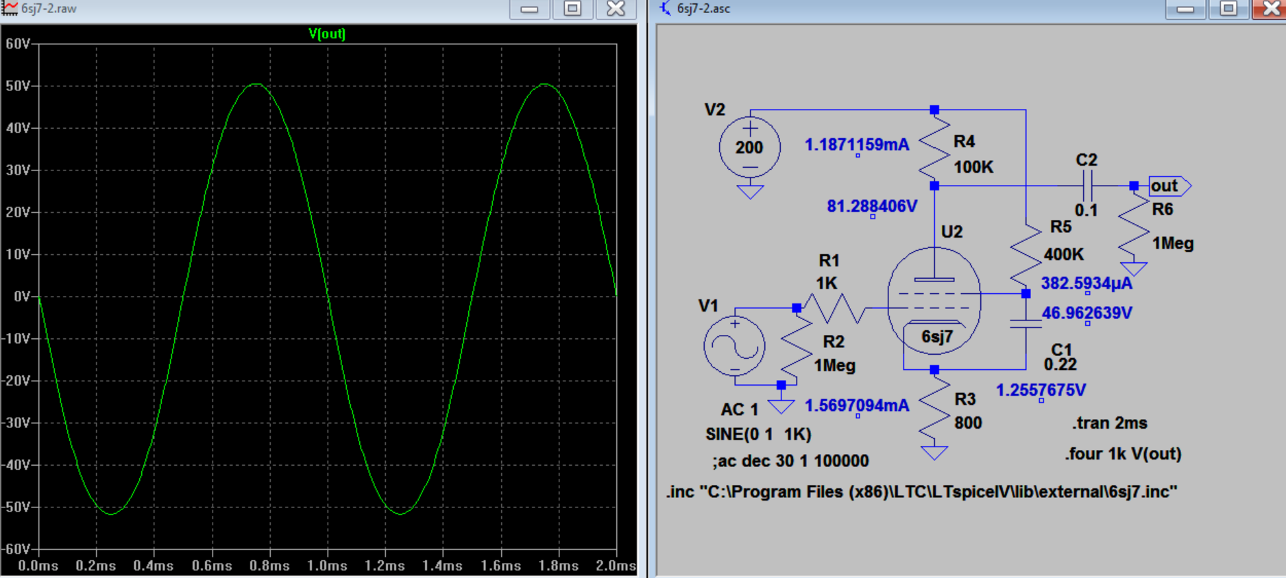

My sim match your data very closely, have nearly uniform gain 50 up to 1V pk input, distortion < 5%, good to go?

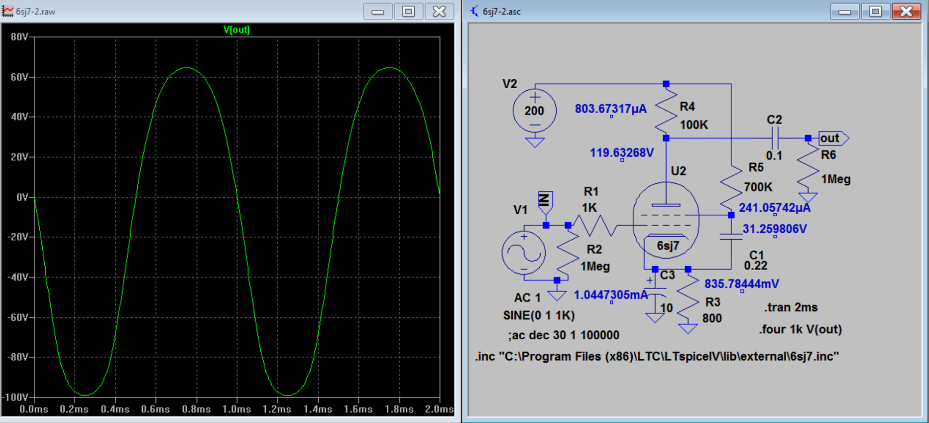

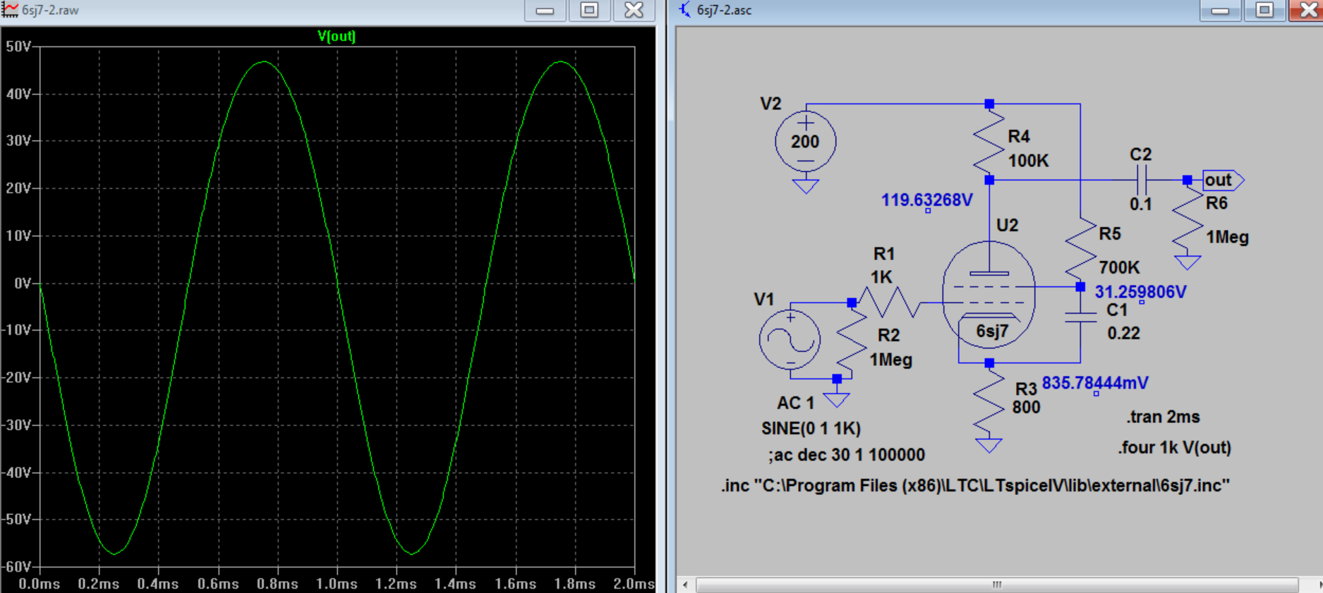

I don't see a cathode bypass cap on those sims.

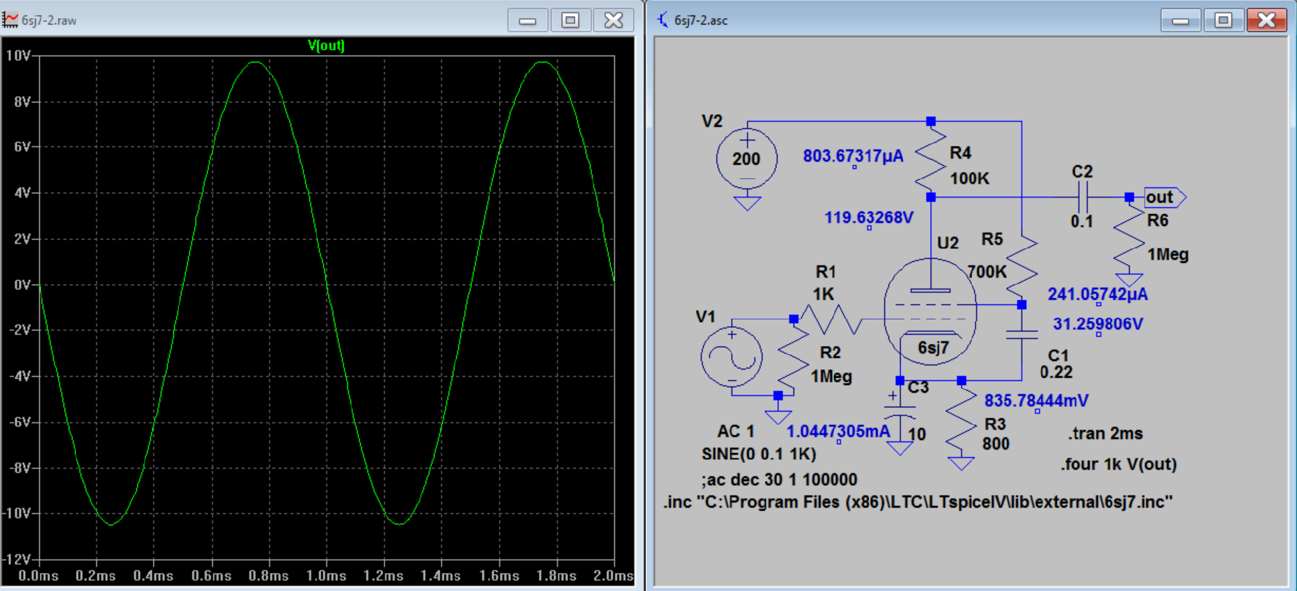

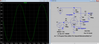

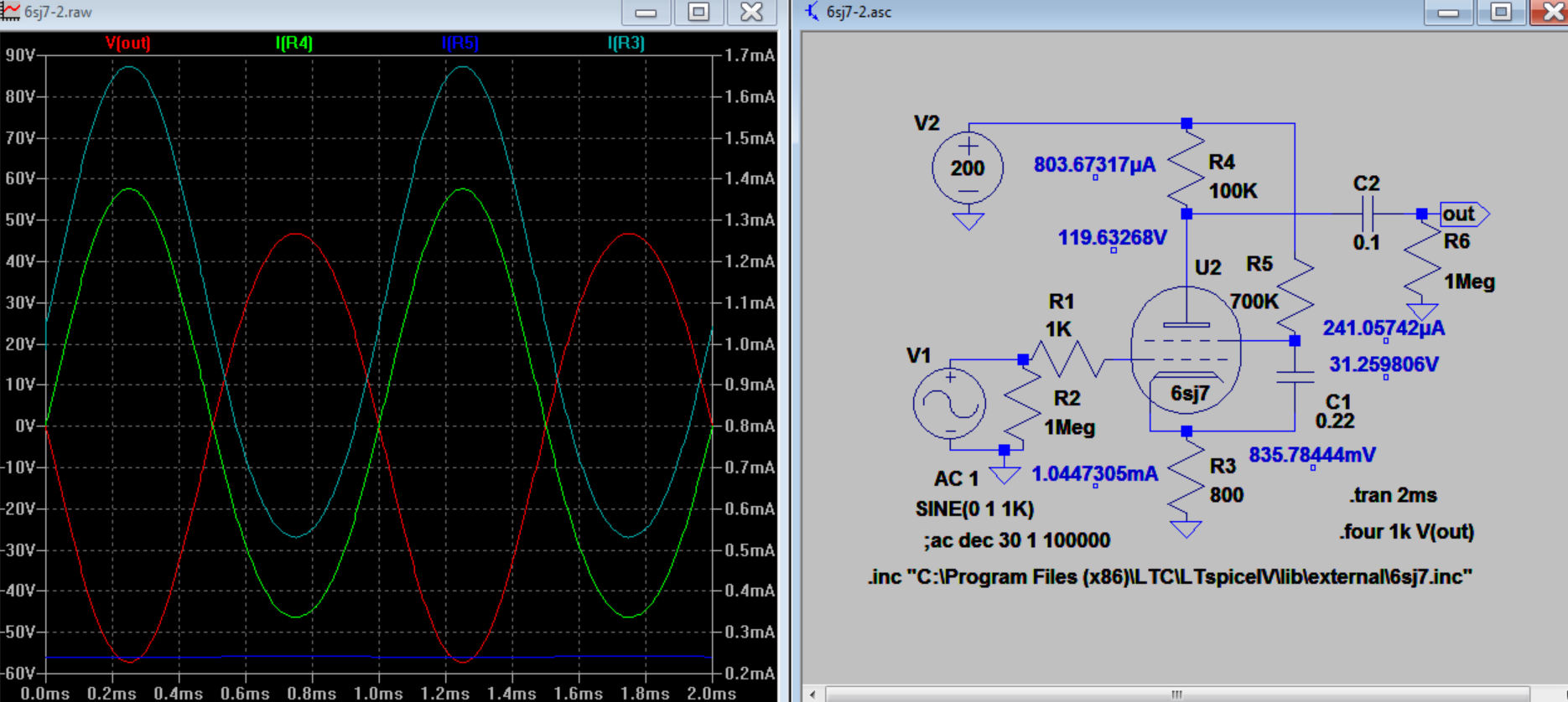

I omit it as it gives more linear gain of 50 which you requested. If it's in, it is non linear gain from 100 at 0.1V to 60 at 1V and noted that min cap is 10uF, if change to 100uf out is still same gain pattern 100 to 60.
I do want the non linear gain.
Yes, just omit the bypass capacitor will give more linear gain. Raise the screen to 47V give more symmetry and linear gain 50 at 1V and 47 at 1.5V which exceeded your requirement. If you put 10uF bypass cap the gain shoot up to 100 at 0.1V and 80 at 1V which is quite non linear? If you keep HT at 200V and lower screen voltage with 10uf bypass cap give you even more non linear gain 100 @0.1V and 60 @1V. But it is not very symmetric at lower screen voltage.
