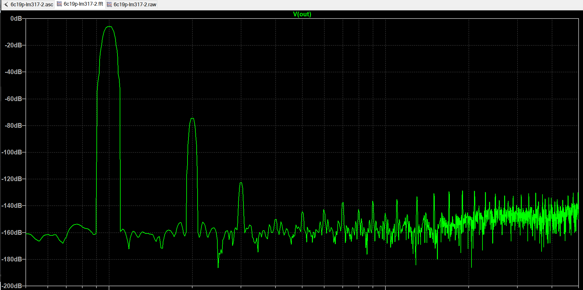

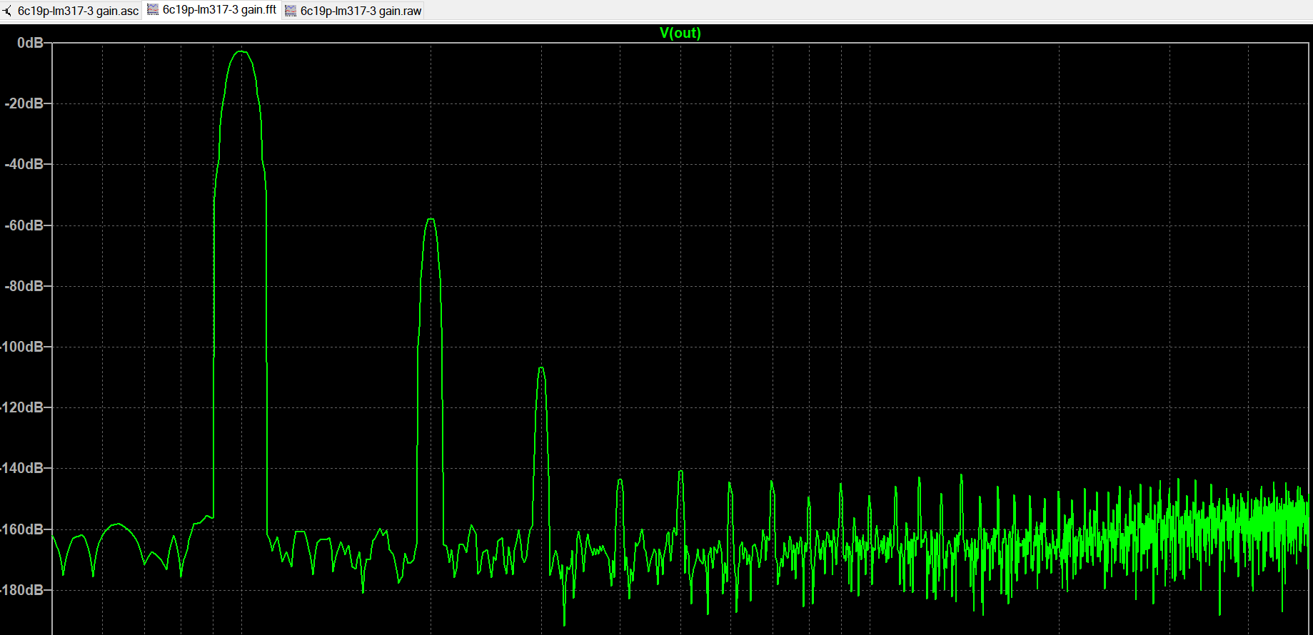

I've seen this article before.
Its not so useful to compare valves with very different Ra, using a static anode load.
Given the 6s19 has a very low Ra, I'm confident the THD 'tail' will be markedly different, with a 2k5 load!
Even then the load is 5×Ra, and the user could go 2k.
I have a quad of 6s19 laying about, that I should try out, but I'm fairly sure the valves poor performance in this article, has much to do with the bad load (10×ra)

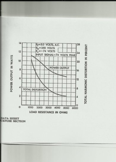

The smaller the load, the smaller the harmonics of the triode.
Tubes, design, etc.
The Eimac graph applies to all triodes/strapped triodes.
2nd harmonic combines with 3rd to produce 6th, and 3rd combines with 3rd to produce 9th. 5th and 3rd combines for 15th.
Here is a graph of the 300b, distortion vs power output with various plate loads.
For triodes, a light load is always better, distortion-wise. 5xRa is just a good compromise between power and distortion. If I were using this for a preamp, I would use an active load
(infinite) which would then be in parallel with the following grid leak resistor. Distortion at low voltage swings would simply not be an issue.

Well...I think even noobs like me understand that a higher load will usually reduce THD.
But 10×ra?
Citing a real tube, though not 6s19....the 6P6S likes anode losd at precisely 6k for minimum THD, below at 4k, and above at 8k, THD is almost double, and also changes in its spectrum. Its a similar story for 6P3S and many of the soviet valves I have experimented with (possibly many valves, or this is general behaviour)
Higher load, in that case gives lower 2nd, higher 3rd....bad news.
Lower load, the opposite effect, reduction of everything, except 2nd, which grows significantly.
So, I still disagree (go figure)
At some load point, between 3×ra and 6×ra there will be a sweet spot for THD.
If the observer, or article author, finds 3rd dominating THD at 6×ra, then I'd be willing to bet that at 3×ra the 2nd dominates, and the result sounds better.
